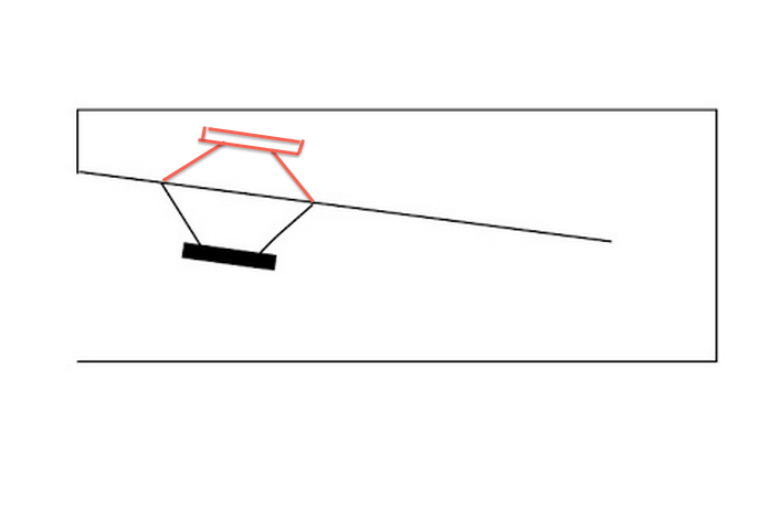

I have 4 - 6.5" drivers but only room for two rather small cabinets. Any chance of making this work?
Well of course.
I can't figure out why more people don't go isobaric with tapped horns.
The primary limitation on subwoofer output is xmax (as long as you have enough power.)
Therefore, isobaric tapped horns can generate more output per square foot than conventional loading.
Isobaric loading is kinda pointless for front loaded horns, because the back chamber is so small already, but in tapped horns, BLHs and vented boxes it makes a lot of sense.
Also, going isobaric reduces thermally induced distortion by spreading the heat between two motors.
Note that you don't have to do them clamshell; there are ways to mount them in a tapped horn so that you can still keep S1 very small. (Basically put a piece of wood there that couples the face of the two cones together.)

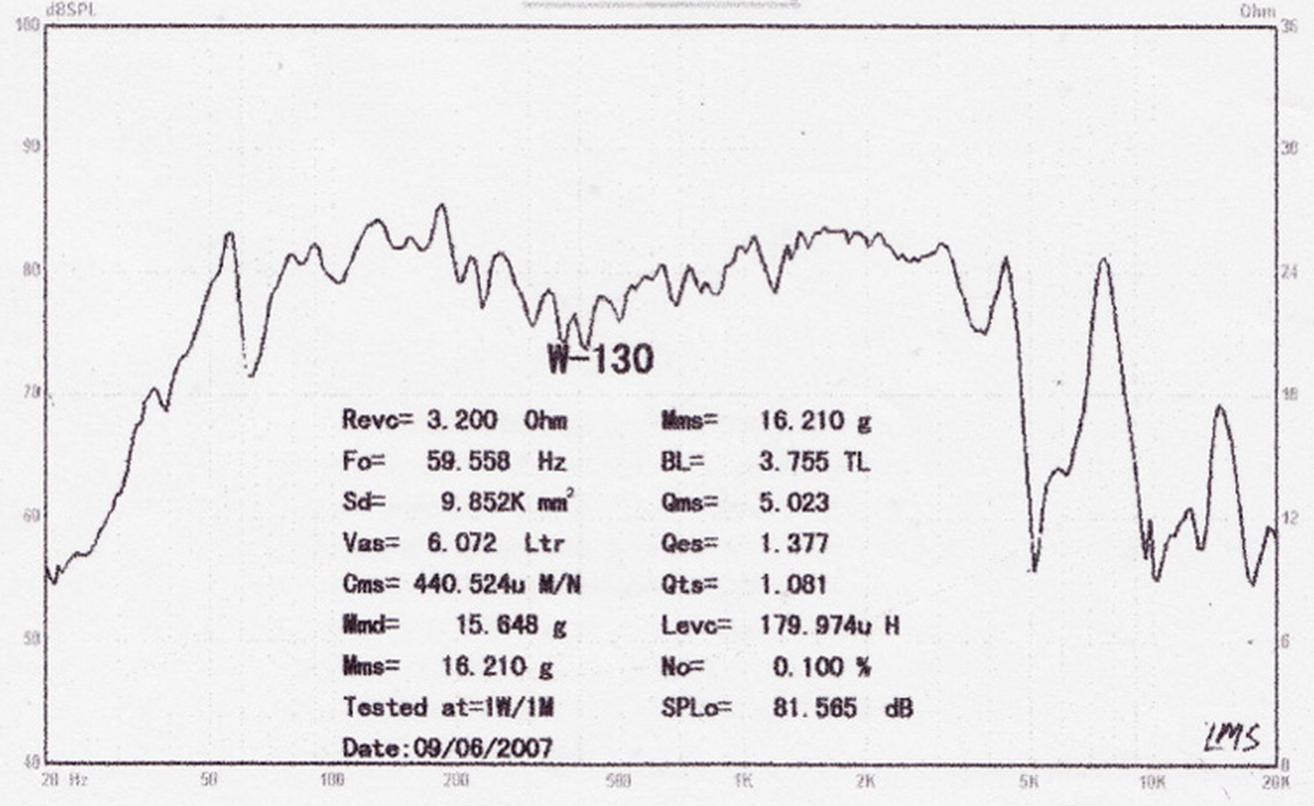

I don't see a design program for tapped horns on a mac. Here's the driver specs, can someone plug the numbers and give me a horn that is approximately the simple shape shown in the fist pic? I think tuning it to 50 Hz is probably low enough?
I would appreciate that greatly.

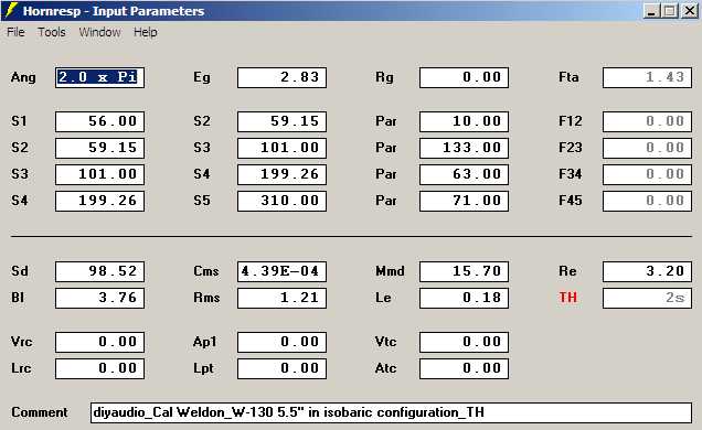

Also, to model in hornresp, assuming that the horn dimensions allow for two drivers, do you simply halve the vas, recompute cms et al., and adjust the DC resistance and impedance according to how you wire the drivers?
Hi Cal,
This driver is not suited to vented enclosures (Qts=1.081), and the Sd indicates a size of about 5.5", I would guess at a relatively small Xmax :). Just stuff them into a 1cft sealed box if you want to try them isobarically.

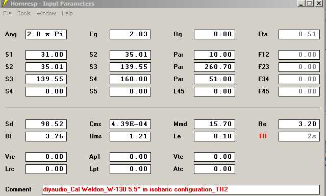

Anyway, here it is in Hornresp, TH isobaric pair:

Hi ghettosynth,
To model isobaric driver arrangements in Hornresp:
- enter the driver as you normally would, and
- under Edit - Driver Arrangement select Isobaric, and however many isobaric configurations you want Hornresp to use, e.g. 2 iso pairs in series with 2 parallel branches.
Hornresp will do the calculations for you.

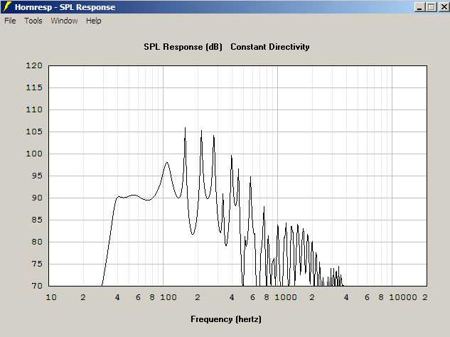

Here's the easiest way to visualize how the isobaric tapped horn will provide more output:
We know that the box size of a VAS config can be halved. But another option is to use the same size box, with four woofers.
In that configuration, we'll have the following advantages over the same box with one woofer:
1) Due to the fact that we have four voice coils, the amount of power going into each coil will be reduced by 75%. YES it is true that our efficiency rating is exactly the same for a four woofer isobaric versus a single woofer setup. And that may seem like a criminal waste of money. But a 75% reduction in voice coil power is significant.
2) Due to the fact that we have twice the cone area, excursion is halved for the same SPL level.
Combine those two things together, a reduction in displacement AND a reduction in voice coil heat, and you have a recipe for a MONSTER of a tapped horn.
Or, better yet, split the horn in half. Instead of using two isobaric pairs in one cabinet, use one isobaric pair in the cabinet, and put the other sub somewhere else in the room. You'll still enjoy all the advantages of isobaric, and you'll also get the benefits of the Geddes multi sub approach.
You can model all of this in hornresp by the way; just take a design, copy it to a new page, and substitute two series-wired isobaric woofers wired in parallel for the single woofer of the original design.
Let's start with a real world example, ok?
This is XOC1's TH, as documented on this forum
Here's the output of the XOC1 sub, with 1000 watts into 4ohms and a B&C 15TBX100 woofer. But we can't hit that SPL, because we're displacement limited.
So in my next post, I'll show you how to address that using isobaric woofers...
The graph above pits four of the Alpine Type S 10" woofer against one of the B&C 15TBX100s. The enclosure is identical; it's XOC1's box.
In the graph, we see that performance is similar; the response shape is mostly dictated by the horn, not the driver. Four of the Alpines cost about $50 more than one of the B&Cs. But the Alpines have 50% more displacement, and four of the Alpines have 70% more voice coil area than the B&C.
Now let's have some fun!
Here's two variations on XOC1's box.
The first uses four of the Alpine tens.
The second uses SIXTEEN of the Alpine tens, but in isobaric pairs. (Box size is exactly the same.)
Here's the frequency response.
Yes, it's exactly the same.
Here's the impedance curve. Same here too.

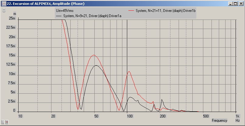

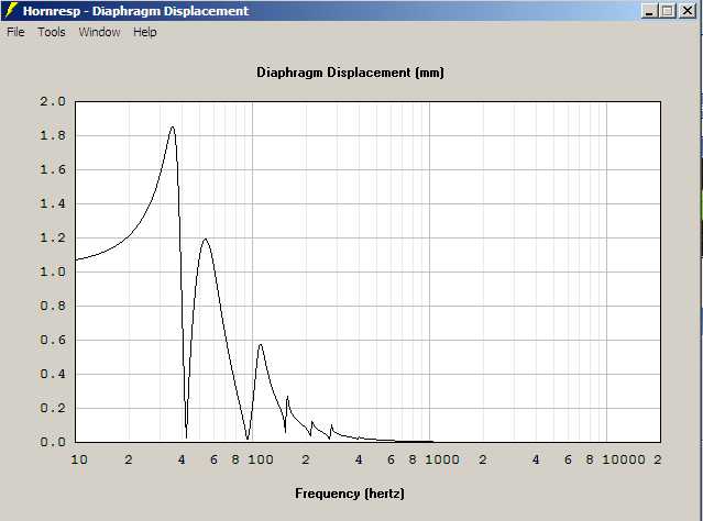

Ah, here's the money shot!
The isobaric box has half the excursion. And since subs are generally limited by displacement, that means the isobaric box will get louder than the conventional box, as long as you have enough power to get there.
The icing on the cake is you have four times as many voice coils. So thermal modulation and thermal compression will be dramatically reduced.

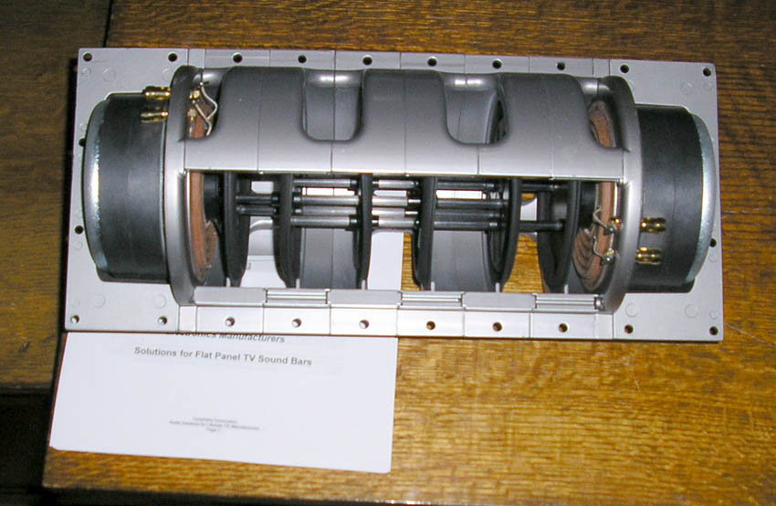

You could mount the drivers like the Tymphany LAT
or...

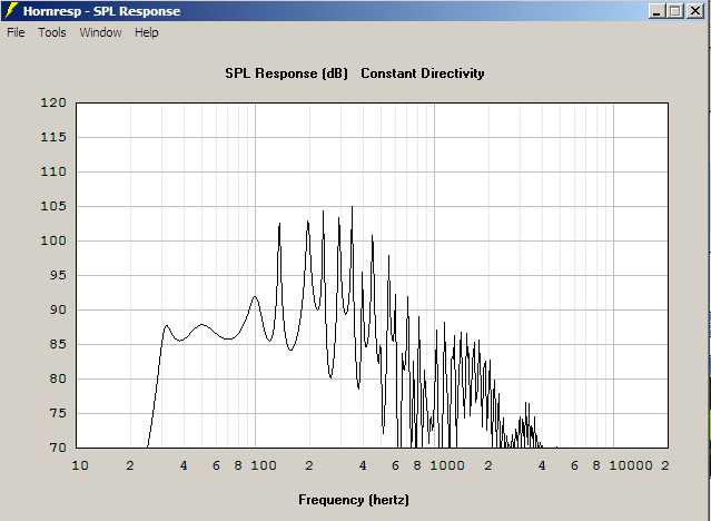

Patrick,
One slight problem with isobaric driver setups is that they aren't perfect. The models assume that the two cones are rigidly coupled, whereas there is actually a compliance between them. Exporting the above Hornresp simulations to AkAbak and allowing a volume between the cones shows that the driver excursions become quite mismatched at some frequencies. Instead of the expected 6 dB increase in output for 4x the drivers at xmax, you only get about 5 dB because the mouth-side drivers reach xmax before the throat-side drivers.
The diameter of the driver's mouth is 230 mm, and the mouth opening is 24 mm deep. That's about a litre. Add about another half litre for the volume of the cone. Double this because the drivers are face to face. Putting that between the drivers in AkAbak gives the attached excursion for the two drivers. The black trace is the "inside" driver nearest the throat.
Still, 5 dB more in the same size enclosure is a lot better than nothing. :)
Incidentally, instead of modelling the horn with 4x and 16x drivers, I divided the horn areas by 4 and used 1 driver and 4 drivers.
