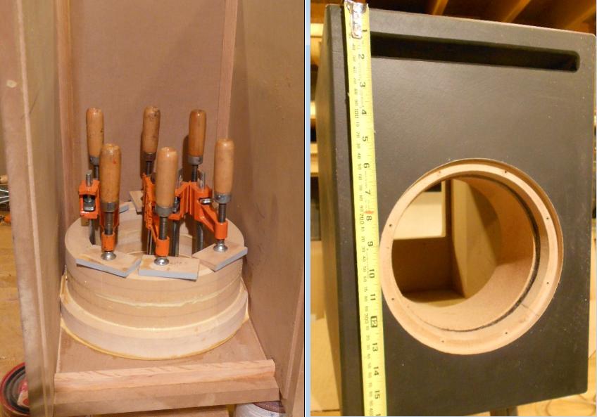

Tunnels - more fun than than a barrel of monkeys - I've been gluing up round mdf disks, and then gluing the stack to the back of the front baffle; of course minimizing the space/distance. Very easy to route here and there to attach/center the drivers. Glued in some cork in one of the tunnels, I though that also was a good idea.

Cutting wood rings is a snap - Pic

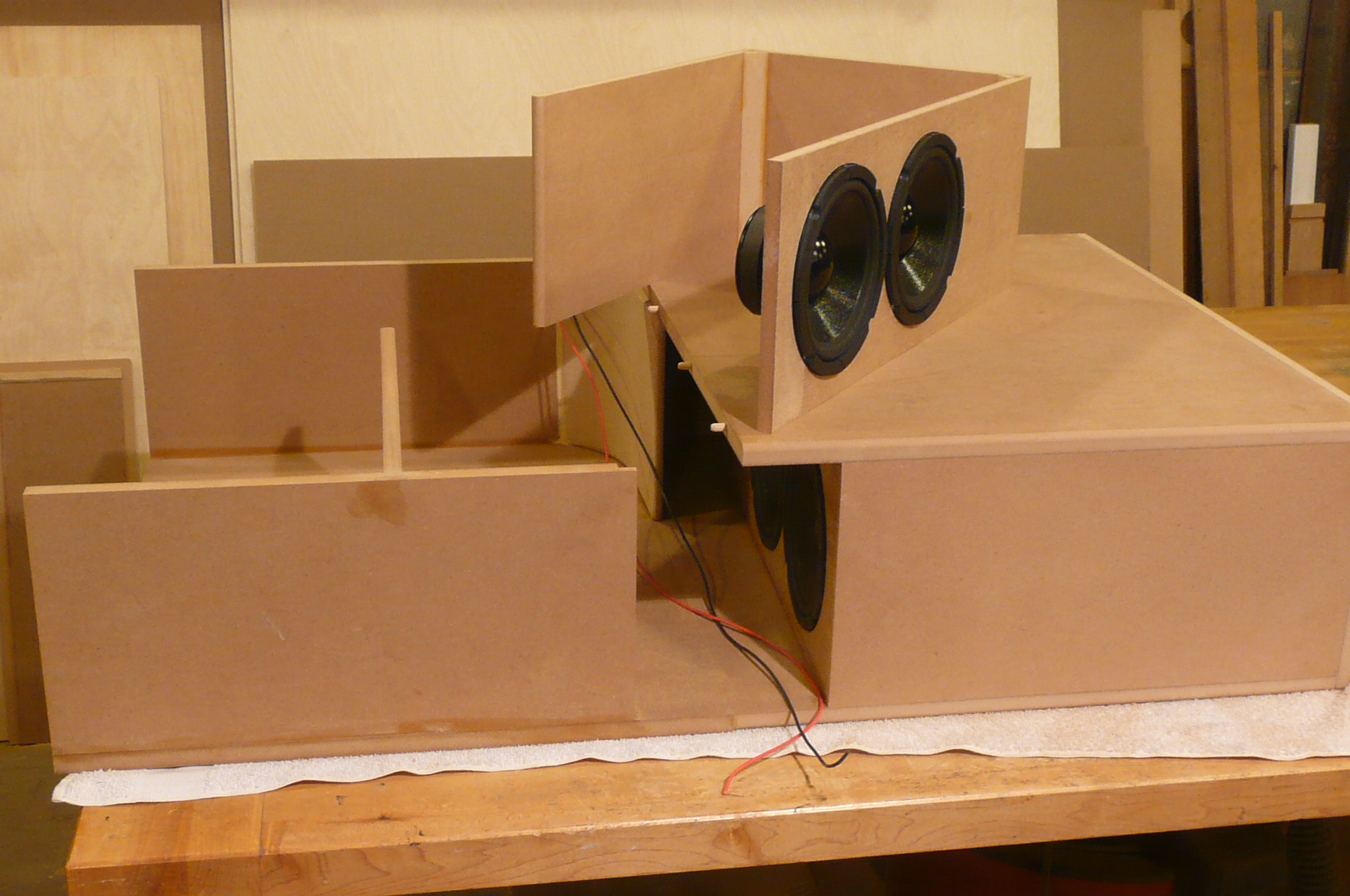

The tall boxes are 21" x 9" x 50.5" (not including the 4.5" riser).
A couple of thoughts here:
I used the 48" length and added a small piece to add up to the length; which can be reinforced on the inside with bracing.
Still using the double tall box - it's not stealth-y but we do enjoy it. No problems so far and not using any protection filters (sub-sonic).
Other than that - this all started with folded boxes that are more compact.
pic is a double folded box using 4 drivers.

Thanks for the tips! This will end up under a 16" x 53" piece of granite behind the sofa as a sofa table, so I can be pretty flexible with dimensions. The port will probably be best on one of the short sides, unless I build some legs and make it down firing like that other folded box in your pic. Actually, my wife may prefer that, for aesthetic reasons.
My only limitations are small vehicles with which to transport plywood and how straight I can cut with my circular saw. Getting a repeatable width for the interior dividers would be tough, I think. I could match everything with my flush trim bit on my router, but I'd have to start with one perfect piece :) Pre-ripped stock or standard boards are a big advantage for me when I can use them.
