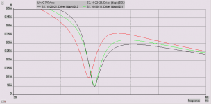

Try and avoid using isobaric configuration in a ported enclosure. You won't get the same excursion-limited SPL as you would with a single driver, due to the enclosure resonance changing the effective rear enclosure volume.
See the attached graph, showing excursion.
The red line is the excursion of the outer driver of a clamshell pair.
The black line is the excursion of the inner driver.
The green line is the excursion of a single driver with T-S specs equal to the combined clamshell pair.
Most of the time, the volume of the rear enclosure is much larger than the volume of the space in the clamshell, so the two drivers move almost together.
But at port resonance, the back-pressure of the enclosure resonance has the same effect as making the enclosure much smaller, and the ratio of the two volumes becomes smaller. The volume of the clamshell space becomes significant.

The air between the drivers has compliance (is compressible). It can be mimimised by minimising the volume between the drivers. Clamshell ({}) usually results in a smaller volume than daisy chain ({ {).
