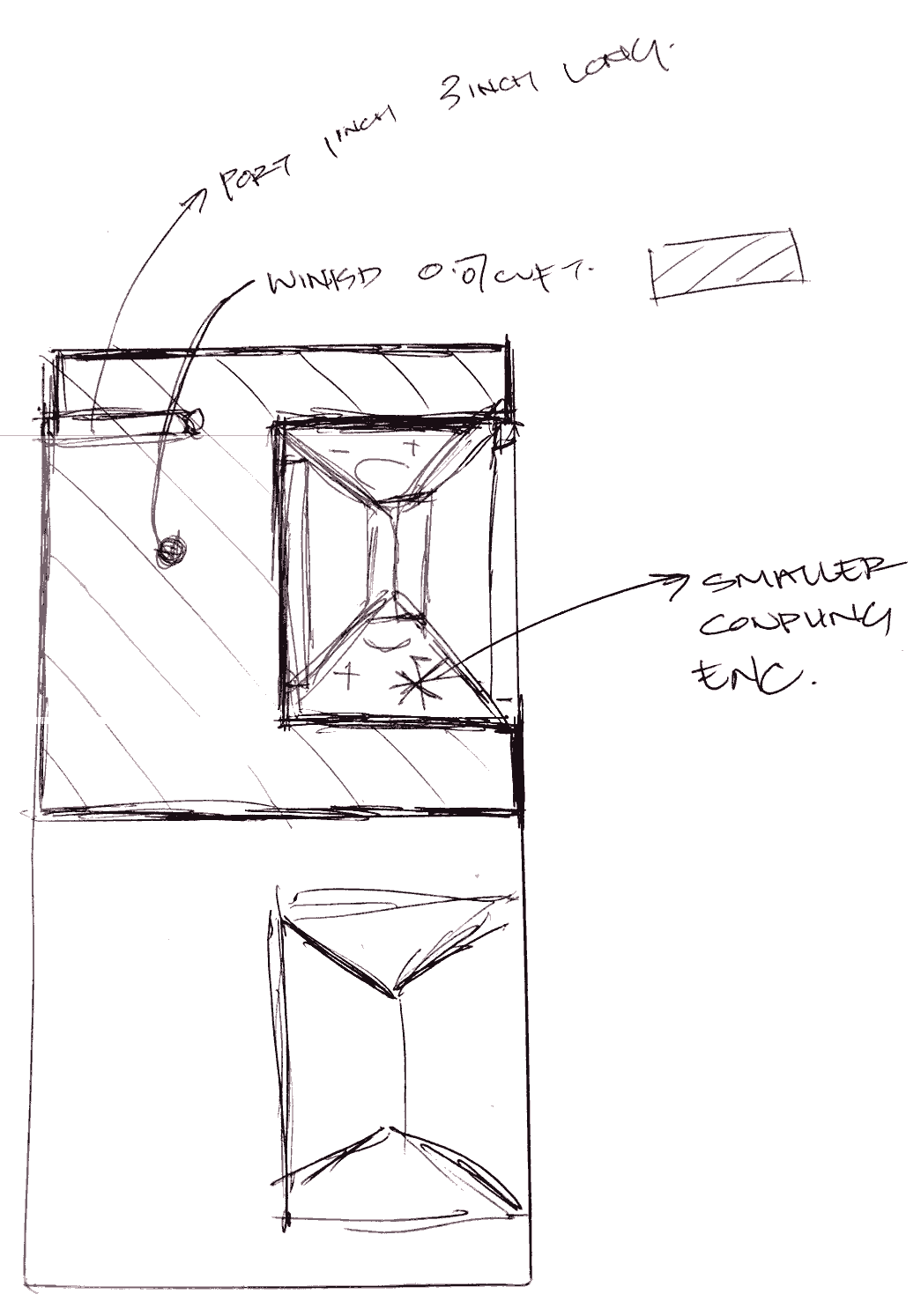

Cheers, I'll have a look at bipole. I get confused as if this was a traditional setup it would be a no no to leave out the divider (ie allowing the two drivers to share the one enclosure). If the push push setup is just doubling what you would normally calc for one, it isn't really appealing to what I want to achieve.
Getting mixed feedback about the similar push push setup in the isobaric setup as well, I get the impression that you are meant to touch the drivers at the rear and the enclosure size is halved, but not sure if then the driver at the rear is meant to go into another chamber like your previous picture. For example, if I use WiniSD and size an iso I get 0.07cuft for a particular pair of drivers, would that be the smaller box on the push push iso, or the total volume of that same picture. Or if isobaric is really only for mids and sub's or if a full range could actually be used without affecting the mids and highs....

I think it is helpful, I may have to read it a couple of times, but I think I understand. The smaller box isnt really the calc, it's more the rear chamber that relates to my WiniSD box size. If the magnets are touching it needs to be wired differently, but if it is driver facing magnet of the other it is wired in parallel.
I would like to try this in a way to a) keep the box size down and use the bigger drivers. I think the internal volume required for what I'm thinking would be 0.16 cuft (ie 0.08cuft per pair, 0.06 for main chamber). I recently used a similar sizing with the ND65'S and was underwhelmed with it and have a couple of TEBM65'S I could experiment with, but it means pulling apart a functional boombox
I have no idea what this thing will sound like as I have only ever built a port box with one driver in it.

Ok, couldn't be bothered searching for a free cad package, my work computer is at, you guessed it work , my kids have nicked my scale rule for dodgy sketch is all I can do...
Ok first sketch was what I thought I was doing, which looks like the boominator but not assuming the right things, as what I thought i was doing wasn't what it actually should have been.

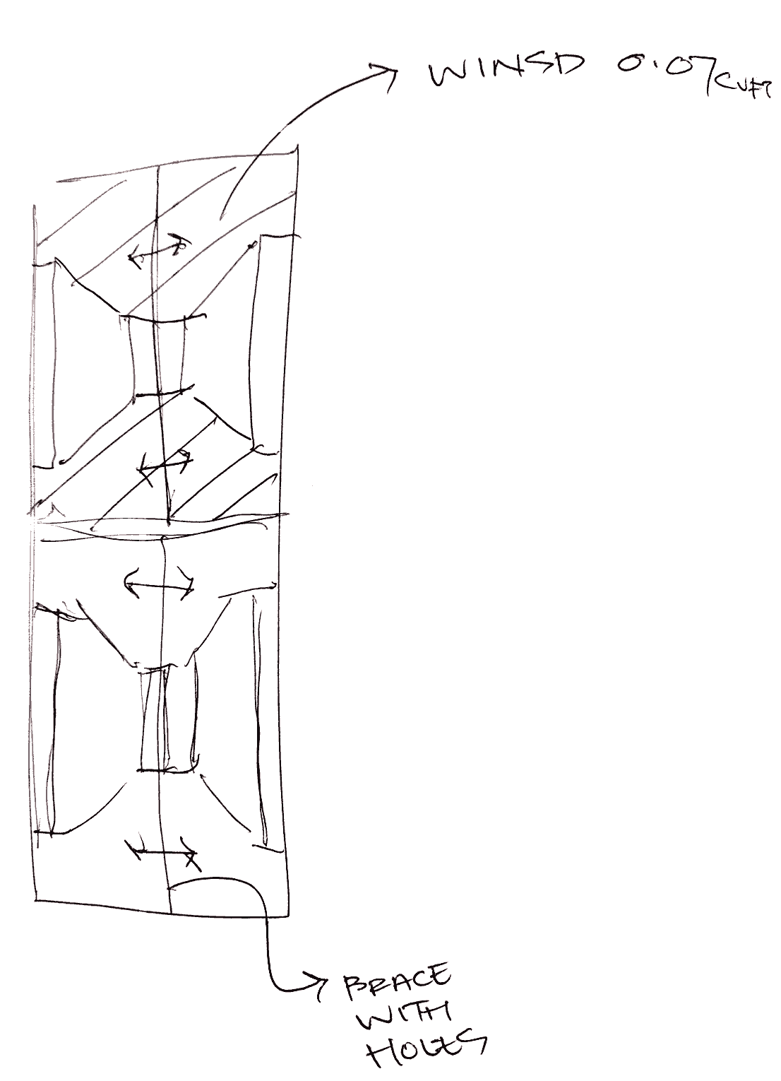

The second sketch is what I take from reading the last couple of posts, where the is a small chamber and a larger one which the enclosure sizing relates to.
Am I off the mark thinking the method can be used in the application I was intending?
