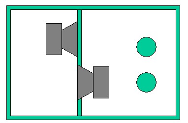

I don't know if I arrived in time, but I like this bandpass configuration.

TL bass is usually better defined than bandpass. there are exceptios ofcourse.
you have to choose your poison. if you are willing to have a big box TL might be teh way to go if teh woofers have a Fs in te region of 30-35hz you might have a winner.
only thing with TLs is that I am not sure if you can average the line lenght when you are using 2 drivers. Head says yes. heart says no.
push pull isobairk bandpass is another option sort of what sapito suggested but with the woofers facing each other.

Sorry, I misread the post Navin; I thought that you were saying the 16.5cm drivers were for a TL...
How big would a TL sub be? It seems to be that the subs are around the correct specs (Fs of 33.7Hz).
I have done a 2-second sketch of what I understand by an isobaric TL...Can you tell me if I'm on the right track? What response could I expect from these?
Thanks!
Gaz

Are you building a "classic" tapered pipe or have you modeled it to get an optimim design? The AP17 should work OK in a pipe but it would probably do better in a TL.
The 8s look best suited for a vented box, and as i am prone to do, i'd suggest a push-push arrangement. The prime purpose of isobarik is to reduce the box size (i think there are other, subtler benefits too) at the expense of efficiency and radiating area.

A classic pipe like this has only a small chance of working well -- you'd be better off with a sealed box than this, particularily given you will have a sub.
Software is available starting here.
Why would you go against the TL sub idea? I hadn't thought about an Isobarik TL sub - but now it's been mentioned, I quite like the idea...
Because your driver's Q is too low to do well in a TL.
