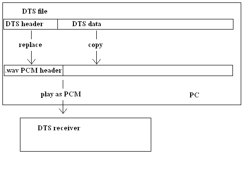

What do you mean decoded? What I'm saying is, take DTS data and copy it directly in a wave file with a header specifying PCM. If a player is bit-perfect, over the S/PDIF would come out a stream identical to a DTS file being played. Neither the OS will know that the PCM is really DTS encoded data, nor will the receiver know that the DTS stream it's receiving was stored in a PCM container.XXHE said:I don't think this can be useful. When the stream is decoded (into PCM) there's no receiver applicable anymore, and nothing will show "green lights" for a properly encoded stream.
Decoded like : it is PCM already, and DTS is invisible (has gone ... it's just interleaved channels now).
I know what you mean, but the point is, once it's PCM nothing can go wrong anymore, so it is now allowed to be not bit perfect, and everyting will play. Please keep in mind : the only thing that can hold back would be a decoder (which doesn't understand which the bits are mangled with). But the decoder is just not there in your example ...
Might it help : I play DTS-software-decoded, hence PCM right through XP's mixer. All is fine. Nothing *can* go wrong ...
And it is not bit perfect.
Ok ?

As you like. But where did you read this is about a raw DTS stream ? maybe I don't see it, but as far as I'm concerned this was about decoded DTS into PCM and my saying that nothing will hold back from playing that (assuming that the soundcard can handle the interleaved channels).
I know abzug tried to make it additionally clear with a picture, but apparently I don't get the grasp of his point.
My point is : you can't use the DTS stream to test for bit perfect because Vista just will switch in bit perfect mode because of seeing the DTS (etc. btw).
First decode it into PCM (at least that's what I think abzug hunts for) and it has become the most normal WAV which will just play. Bit perfect or not.
No, you can have a WAV file containing DTS bitstream. You can play this file back via ASIO and it will be decoded into 5.1 audio if you have an external decoder attached via SPDIF.
This is the whole point of Abzug's post... you play a DTS encoded WAV back, which the player believes is PCM (although it is NOT), and if the player (and sound card) is not 100% bit-perfect, the external decoder will not decode the DTS stream successfully.
This test has been known and used for a long time. I suggest you get a program such as SoundForge that allows you to save AC3 and DTS bitstreams inside a WAV file.

My whole point was to prevent decoding of the DTS by the OS/software and fool the computer into treating DTS data as if it were PCM. I thought that point is very simple and everyone here understood it.
If you take a wav file and replace a part of its PCM data with data you copy from a DTS file, it will go through the sound subsystem as if it were PCM--because if the system is bit-perfect, then it doesn't care about the contents of the PCM stream--it just forwards it, so it will be treated the same way regardless of what data you put into it.
How would Vista know the stream is DTS if you put the DTS data into a wav file which specifies it's a PCM stream? Vista will treat the data as PCM if you tell it it's PCM!XXHE said:Vista will switch to Bit Perfect once it detects such a stream (and it does).

Ah ... ok, now I understand too.
Please allow me to explain (if I ever can) why at least *I* don't think this way :
Your mentioned "sound system" consists of two main parts only : validating the (WAV) file, and attaching the DAC (driver) to the "audio session" of the program, feeding that with the data used in mentioned validating (and the remainder of the sound system is the program pushing the bytes. Keep in mind, this is WASAPI programming, not DSound, ASIO, KS).
Both processes use the same data, and when your example would be fed to it, it will fail I think. Just because it's not consistent.
When I say that both processes (validating the file and attaching to the driver) use the same data, this is actually not true, because it can me mangled. XX does that too, because otherwise e.g. an 96/24 file just can't play in Exclusive Mode. This is a bug in there, and is related to the inherent format of the 24 file which consists of 3 bytes, while the DAC needs (padding to) 4 bytes. It just doesn't match when you again hear "both processes use the same data".
I expect similar with DTS (etc.), but sadly can't try it, because I too don't have a DTS receiver.
I think this all is related to reports from people, where one says the DTS test succeeds and the other does not with the same player (incl. WMP IIRC). It depends on the DAC ! or better, what the soundcard driver needs for padding.
It gets more complex when we see that the test already can fail because the format won't get (accepted) right. So this is unrelated to bit perfectness now and highly related to the player in combination (!) with the soundcard driver (or USB for that matter).
Ok, whether it can work or not is one, but two is that if one didn't set it up properly but the DTS light goes on, one could be fooled by Vista's switch to Exclusive Mode and *that* is bit perfect always.
