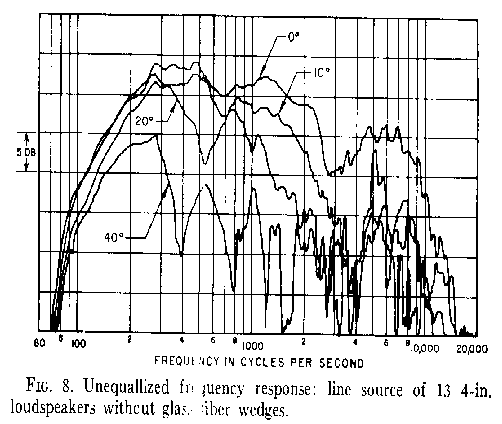

Here is the frequency response of thirteen 4 inch speakers in a line source array. The authors eventually got smoother-but not flat response, from a combo of glass fiber wedges in front of the speakers. Flat response to 2,000 Hz was achieved with a simple equalizer circuit.
This is from an article, Constant Directional Characteristics From A Line Source Array by David Klepper and Douglas Steele, which was published in the Journal of The Audio Engineering Society in July, 1963.
Since it was a small graph, I had t fill in some blotchy parts around 500 Hz with MSPaint. But not much.

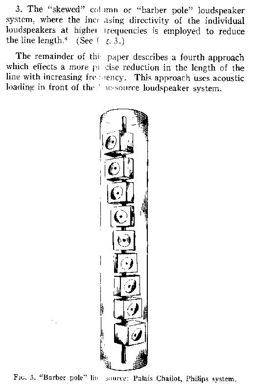

However, for a line array, at least one company tried bbaker's approach. How successfully it worked out, I don't know. From the article above in the Journal of The Audio Engineering Society, here is all the info the article contains on this configuration.
Just thought I would throw this in for fun.
PS: This is a snippet from the article. The Barber Pole enclosure is not the authors' enclosure. They include it in the article just as a quick survey of work already done on Line Arrays. In case it is not clear, the Barber Pole enclosure does not contain any fiberglass wedges in front of the speakers. The authors' enclosure, which they go on to describe, has them. The Barber Pole does not.

That first chart in the thread-reposted below-shows the response for thirteen 4 inch speakers mounted in a vertical array. I noticed something surprising.
The off-axis response at 40 degrees off-axis is a shocking 17 dB below the on-axis response at 2,000 Hz! A single 4 inch speaker does much much better than that. With off-axis response like that, one of the best features that you would think an array gives you-horizontal off-axis response similar to a single driver of it's diameter but cone excursion much, much less-would appear to be imaginary. There are 10 inchers around which give better off-axis response than that!!
Does anybody have any idea why this would be?

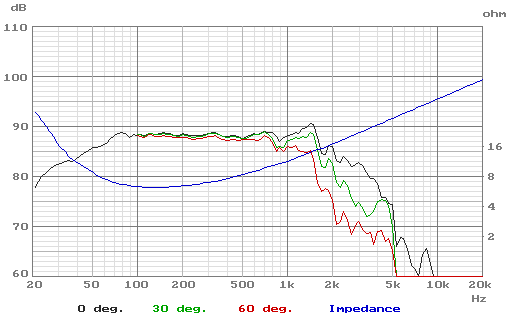

Here is the response graph, both on and off axis, for the 10" Peerless CSX 10" woofer, 850146. The cone area is 7 times as large as a 4" speakers, yet note the vastly superior off-axis response. Look at the 2,000 Hz line. At 60 degrees off axis, (red line), the Peerless 10" has significantly better response than the 4" line array does at only 40 degree off axis!
For the sake of Line Array fans, I can only hope that this is not the usual thing. If it is, why build a Line Array?
