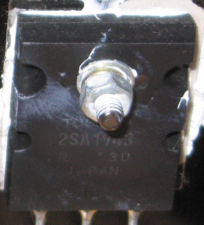

Regardind power transistors, in the Rod Elliot somebody mentioned fake 2sa1943/2sc5200,
http://sound.westhost.com/fake/counterfeit-p2.htm#1943
Sadly, no images nor measurements or additional tips-with exception of something very important: fakes are a failure per se, and don´t work for a long time . There is a nice description of what a genuine looks like: in the real thing is very difficult to read the markings. You need very good light, and maybe some optical aid. More so, the plastic encasing is of black dull colour.
The fakes, instead, have the markings printed against a shiny surface, and the lettering is easy to read.
A time ago I checked mine, and the difficult to read the markings was readily apparent. Apparently, the ones in the Greg photos are identical to the iones I have. I believe that they`re OK.
Hope yours too.
Enjoy, and cheers.
