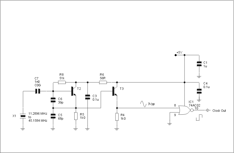

Is this cristal clock schematic would have a low jitter ?
Hello
Do it need improvements ?
Thank you
Bye
Gaetan

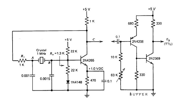

Hello
Digging a bit more in the forum I also found the LC clock, image included.
Agree that comparator can be better but I have none of them and have a lot of inverter chips.
I know the Kwak clock but it use a comparator.
Thank
Bye
Gaetan

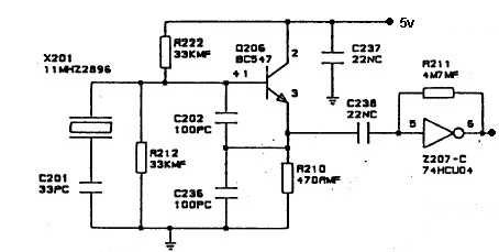

Hello
I've done a Google search, it's a bit puzzeling, some texts say that the Pierce crystal oscillators are much noisyer than the colpitts crystal oscillators, others texts say that the Pierce crystal oscillators are the better .... ??
Between the Pierce and the colpitts crystal oscillators, which one do have the lowest jitter ?
Btw, I include an image of a Pierce crystal oscillators.
Thank
Bye
Gaetan
In the link I attached in Post 3, the various circuits are rated for their stability and power supply rejection. There is little mention of phase noise.
Here is a couple more to consider :
http://www.wenzel.com/pdffiles1/pdfs/xtalosc.pdf
Library
Library
I always try to understand the subject first before copying anything from the net.
As for oscillators, I am still in the middle of that process, since early this year.
Just wish to have more (free) time.
Patrick
