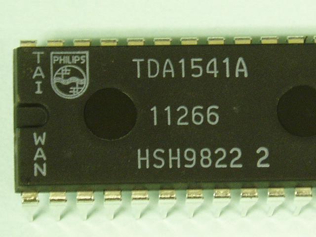

Hi guys,
can you take a look and see if this is a real TDA1541A?
TDA1541A
Taiwan
11266
HSH9822 2
I thought HSH was the factory code for Holland, and RSH was the code for Taiwan, no?
Do they still make them in 1998?
Thanks!
Looks real as far as I can tell.Why?look at the A and 4 both have curved lines whereas fakes have straight lines. The surface finish is probably sanded to silkscreen new markings which look thicker and bolder.Compare top and bottom finish and you'll know what I mean.As for the prefix HSH ,may not be important other than this may be a good fake.
But seriouslly I think it's the real McCoy as I have bought fakes myself,remarked 1541 that is.
