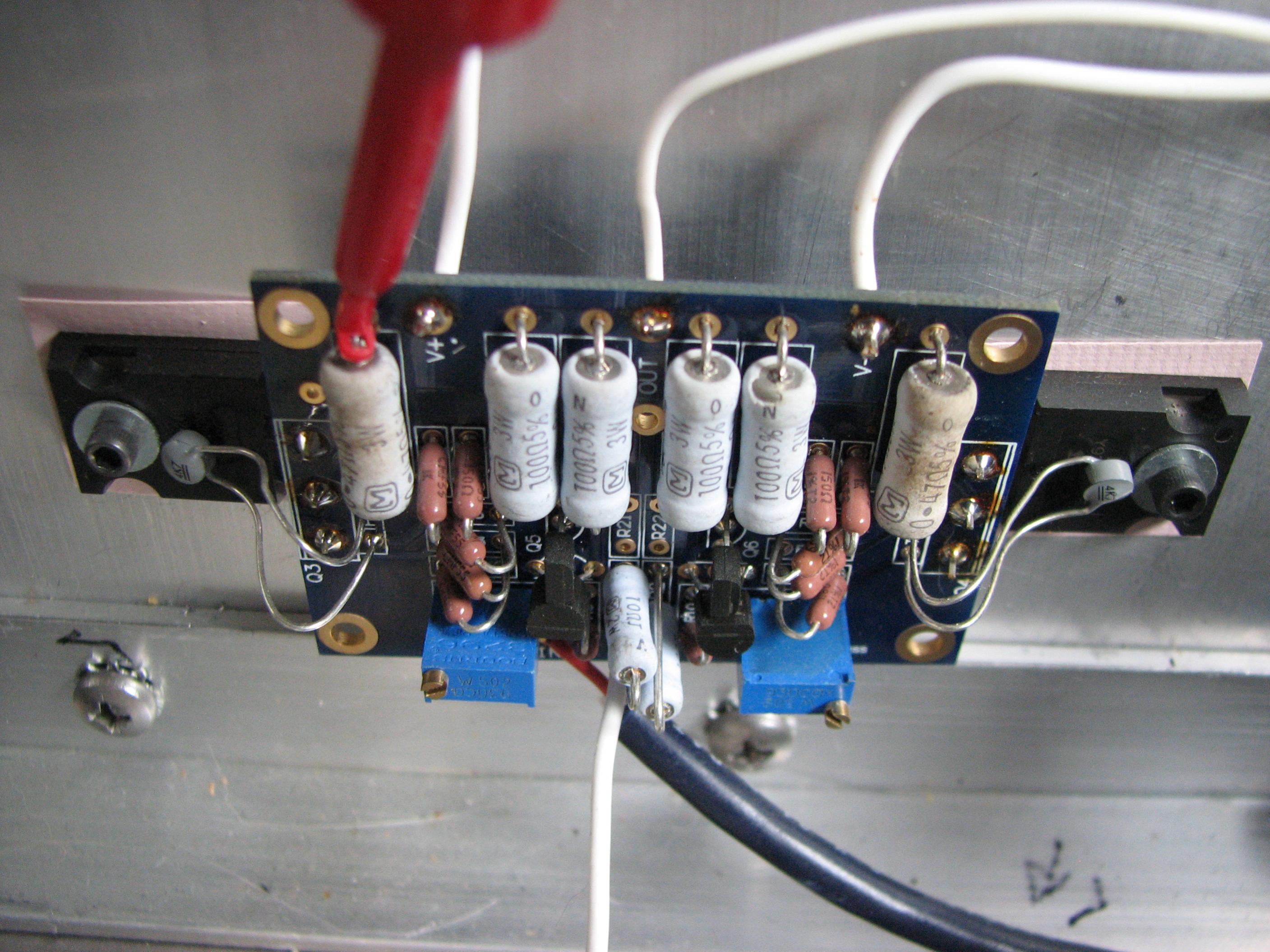

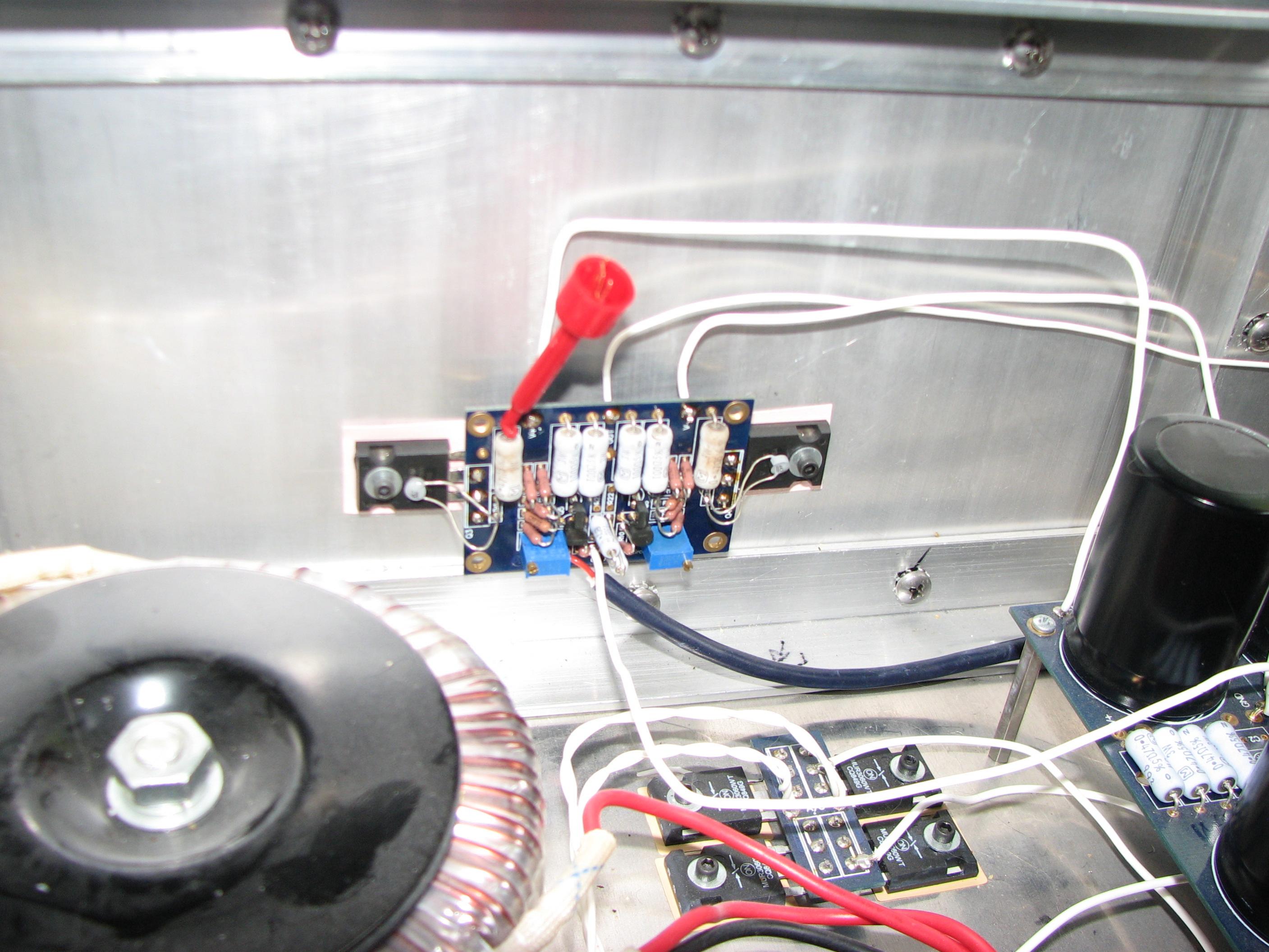

While checking bias on my F-5, I noticed something I hadnt noticed before. On one channel, (the other does not have this toasty feature) I noticed some browning of the two resistors that are used to measure off of when setting bias.
These are Peter Daniels boards BTW.
This amp sounds fine, bias is steady and has been running since 2010 or 2011 with no problems. I never noticed this before, the other channel does not have this. Both are right at the .59 on the bias . I though I smelled something a little hot, dont know if that was it or this has been there. Seemed odd it was only 1 channel.

Joined 2003
Something happened to run lots of current through them. They should not
be seeing more than a watt or so on the stock build with normal use.
:cool:
Any thing I should check? The mosfet closest to that end always ran a little hotter than the others.
Bias has been at normal amount for several years. Ideas as to maintainence for this age and sitiation?

I think I would put in new ones and leave the leads long so that you can
put some distance between them and the hot transistors.

I can do that, it would just be a mstter of mounting the boards to the sink ( they are "dead bug" mounted right now) then running leads to the fets.
I understand getting it away from the heat of the resistor (the little thermoiistors are REALLY hot but I cant get the fet away from them) and of course as creator of this amp I take your word for it, but could you explain to me how this aids the problem? Not doubting at all, just want to understand. I am a babe in the woods here and feared something about the amp or power supply had gone bad.

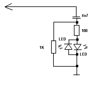

I recall Zen Mod I believe, showing a small device easily put together with an led that would indicate the amp showing any oscillation. I am searching for that post. If anyone knows of it, I would appreciate a heads up. I am searching through the gigantic F-5 thread, I believe that was where it was.
In the mean time I have been experimenting. I hooked up the B-1 to my tube power amp, and all seemed fine, unless I brought the dreaded Roku device near it. If I got the interconnect in contact with the B-1's RCA, the noise began, just like the F-5 exhibited. I am hooking up my BA-3 pre to see if it also has this problem. My tube preamp with tube power amp played it fine...if the BA-3 pre plays it with streamer box, I will switch tube power amp with F-5. If that combo plays it, I suspect the B-1.
Even if all this proves out, it does not necessarily mean the this noise festival is connected to the tanned resistors, but this is the only odd behavior this amp (F-5) has ever shown. With inputs shorted, or which ever pre attached it is dead silent unless I try to attach the roku streamer box. If BA-3 plays it, tube pre plays it, then I will look hard at the B-1.
In the mean time, searching for the Oscillation detecting device schematic.

Joined 2003
it will help you if you have "decent" HF oscillation
That was quick, thank you Zen mod. Let's see if I have all the goodies. In mean time, hooked up the BA-3 pre to tube power amp, and it, like the Tube preamp (AVA Super Pass II) plays the dreaded streaming box fine...

Now let's look in box of goods and see If I can cobble together Zen Mod device. do resistors need to be of any certain wattage? I think I have tons of 1/4 watters. Digging for caps, I have plenty of LEDs, hope blue is good!

The first thing I see is the Panasonic "3W" resistor. Ha!
The resistor size is more appropriate for a 1W part, which then should be derated by 50%.
There are no miracles - if a resistor is small for its rating, it will run hot, as it will not have enough surface area to shed the power. If you are cool with the resistor running hot, fine - keep in mind, though, that the printed circuit board and adjacent parts may not be tolerant of the extra heat. Space the hot part off the board using kinks in the leads (common), teflon sleeving, or ceramic beads, and keep it away from other parts that won't appreciate the sauna bath (just about everything else, but including film caps, electrolytics, and semis. Or, use a larger part that will run cooler for the same dissipation.

Here's a 3W, 390 ohm Panasonic metal oxide resistor, running with 20V across it (~1W) dissipation. Temperature is close to 100C. It might have gotten hotter, but there was a very slight breeze in my lab area, and I only let the part toast for 5 minutes or so. It actually did a little better than I thought it would - I was expecting about 120C. It doesn't take much to get the small parts toasty..
