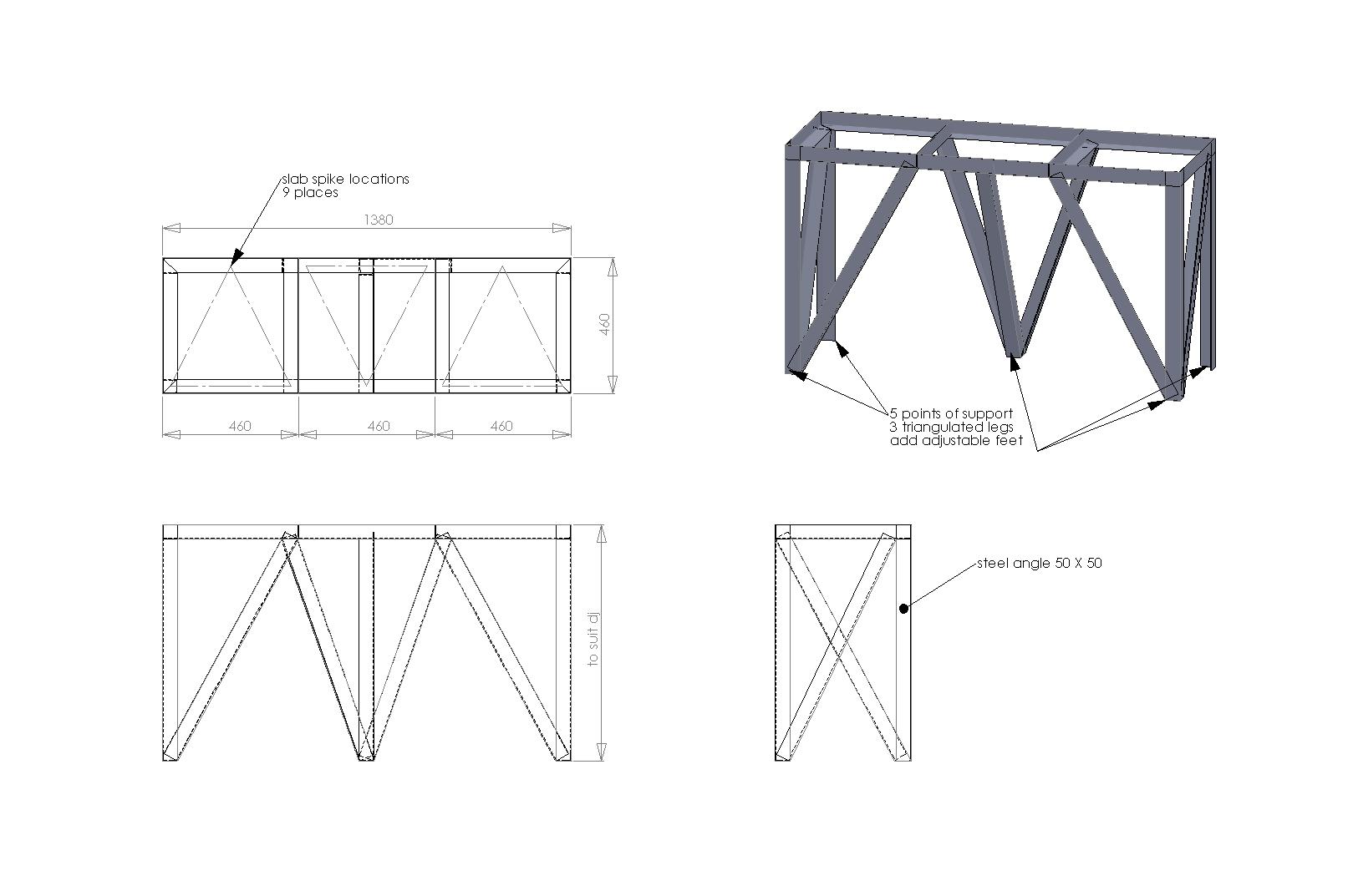

I also built a steel frame made from angle iron. This was a 5 leg table. 3 of the legs were triangulated for rigidity. the other two were just outriggers for stablity. All of the 5 legs had adjustable feet for accomodating different floor levels. The 450mm slabs fitted in the top framework, and were supported by 3spikes each. The stone slabs sat on top of the square 450mm paving slab sandwich and were supported by 3 coins to make another tripod assembly.
The deck was then placed on that. The whole thing was portable. The frame would fit on the van roofrack.
Given a solid floor you could drop the needle on to a stationary deck and turn up the gain with the decks in front of a 5Kw stack without any feedback:D
Sketch attached to give you an idea of how I built my frame table.
I also added a 3D PDF for reference!
