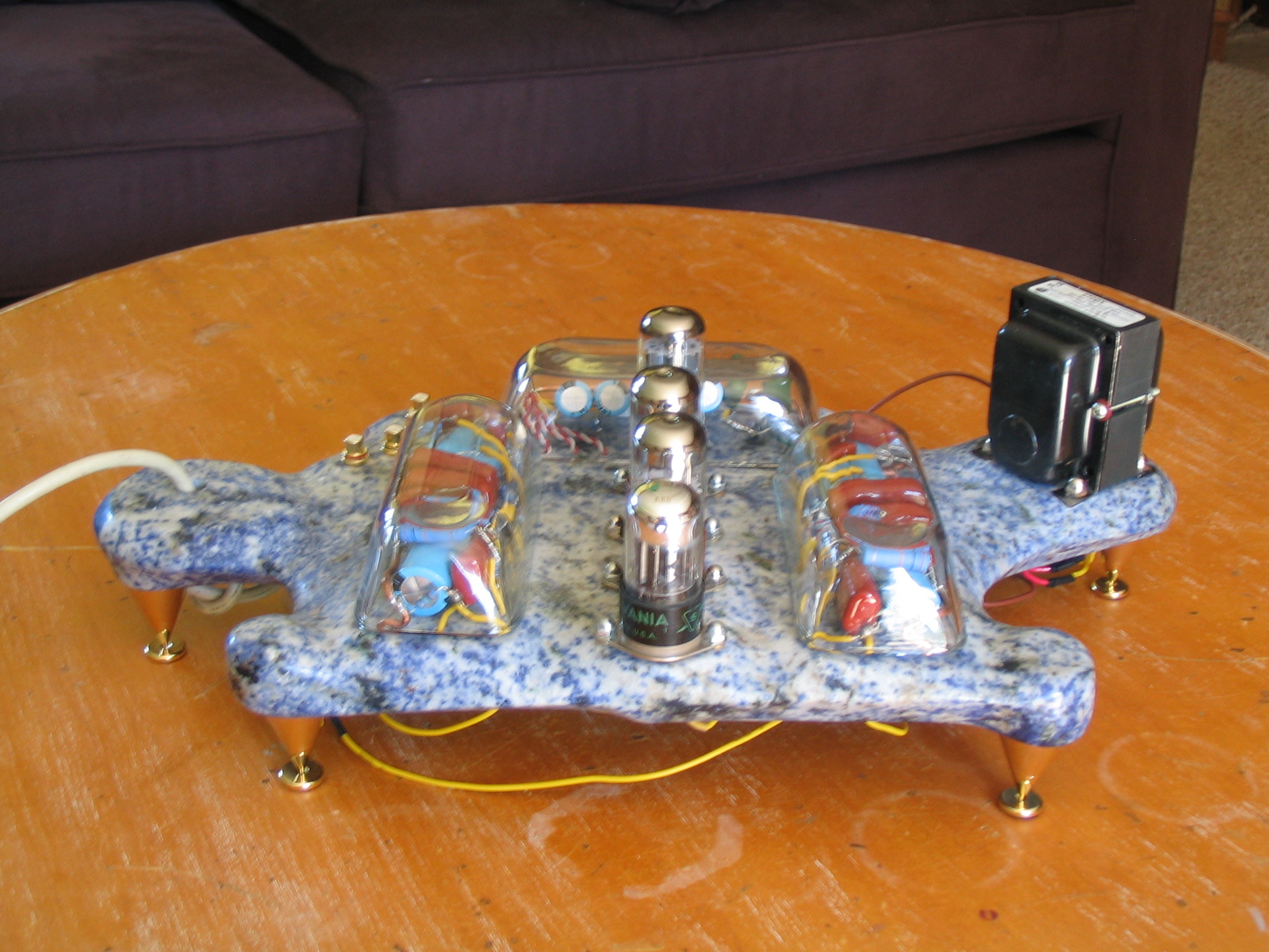

The volume pot and selector switch are going into a Lionel transformer (see pic).
Man, I looooove that Lionel transformer!! Now I want one.
The passive parts under the butter covers is way cool, too. Bravo!

Hey DJN
This Blue Marble Tube Preamp sculpture is Cool, Real piece of Art.
Best Regards
Thanks Banat. The chassis for this tube crossover/pre amp has over 200 brass and copper parts. Should be wild.
