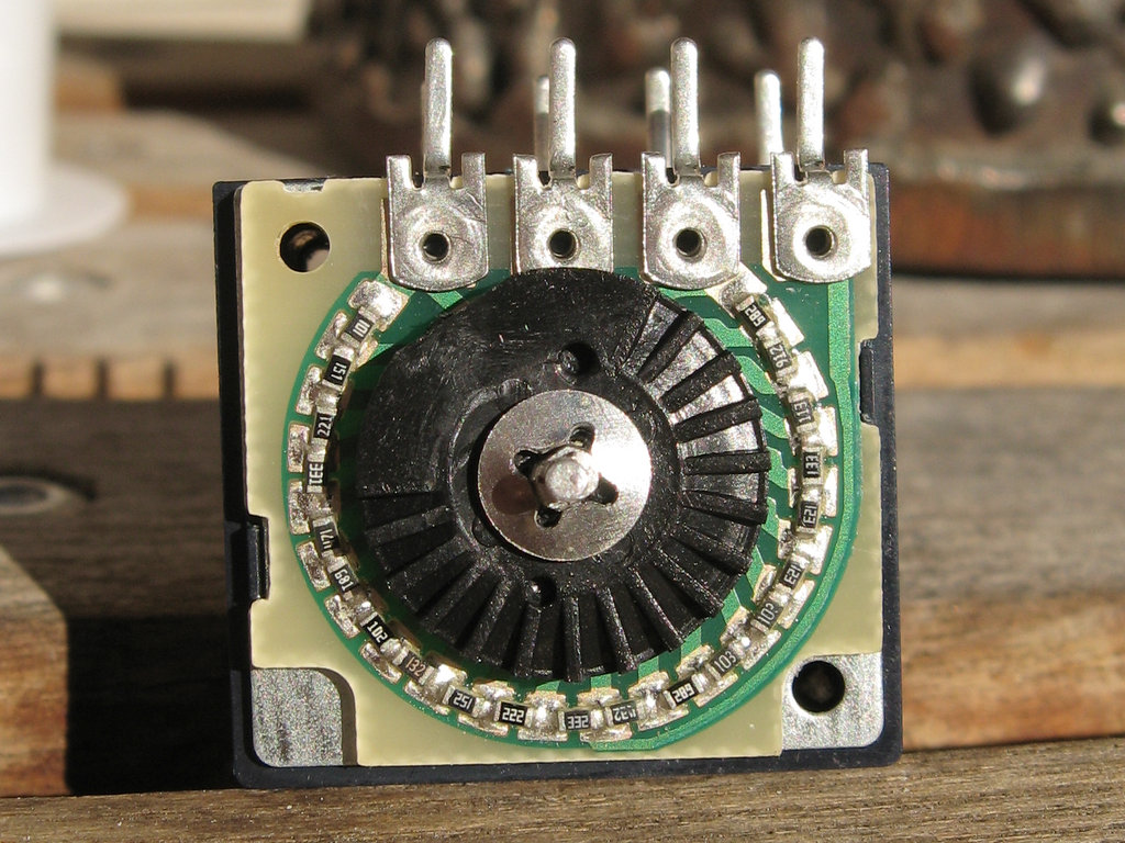

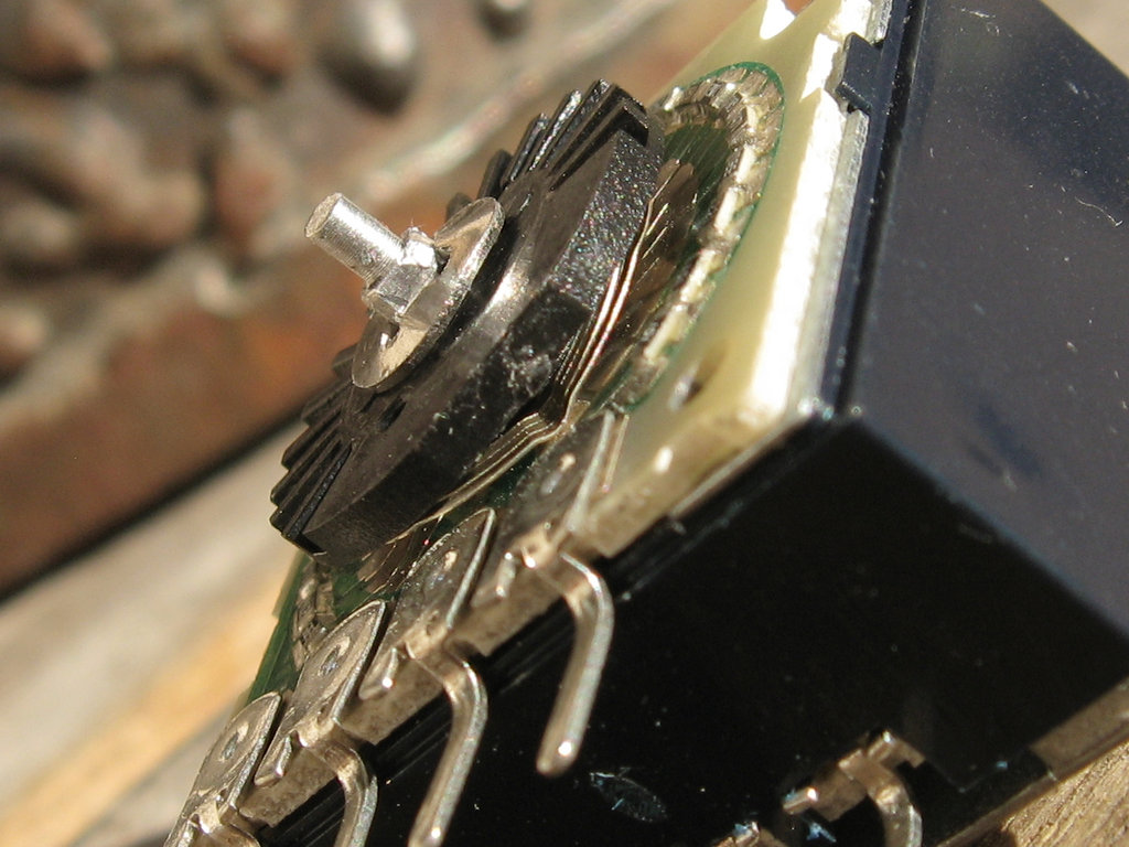

These look interesting 1pc Potentiometer 100k Log Alps Audio Amp Volume Control Pot Stereo W Loudness | eBay they appear to be centre tapped and could be used for an "automatic" loudness control?
Those "ALPS Pots" are actually stepped attenuators, and for sure have nothing to do with ALPS. But they're quite good quality for the price.
I've taken couple of these apart, just to check the "innards" for quality of soldering etc. When assembling, I threaded the "post" with (IIRC) M2.5x0.45 thread die and used a nut there instead of that locking washer.
Resistors are 0603.

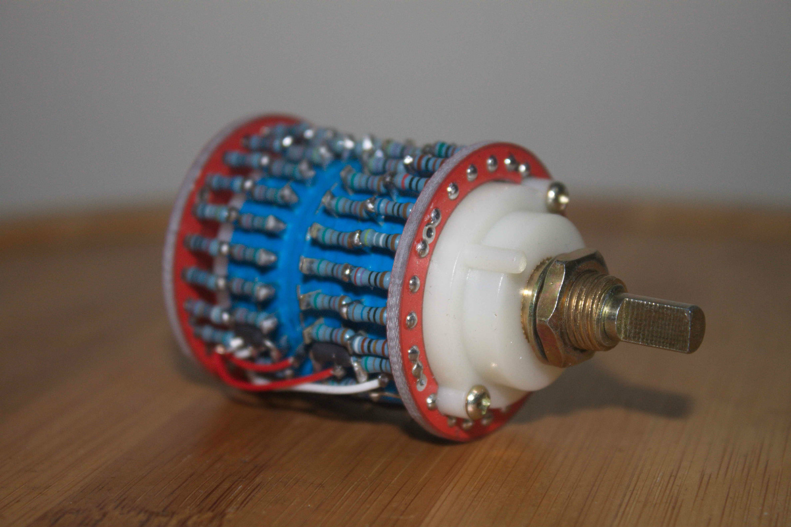

I am suspicious about the ultimate quality of the Alps Blue pots. It turned out inferior to a series attenuator in some tests ... the sound was much cleaner with the attenuator.
The difference between a good knife and a scalpel ...
Going back was not easy. I related the superior performance of the attenuator also to a better contact of the wiper.
The efficiency of contact is very important in my view. Just changing speaker plugs with better ones cleaned up the sound remarkably.
Sometimes even on this model (RK27112) there are crackling effects while rotates.
Best solution is to open the attenuator for cleaning.
For the starlock retaining washer (in use for saving the shaft) a removing tool is necessary.
From where I can order such a tool ?
