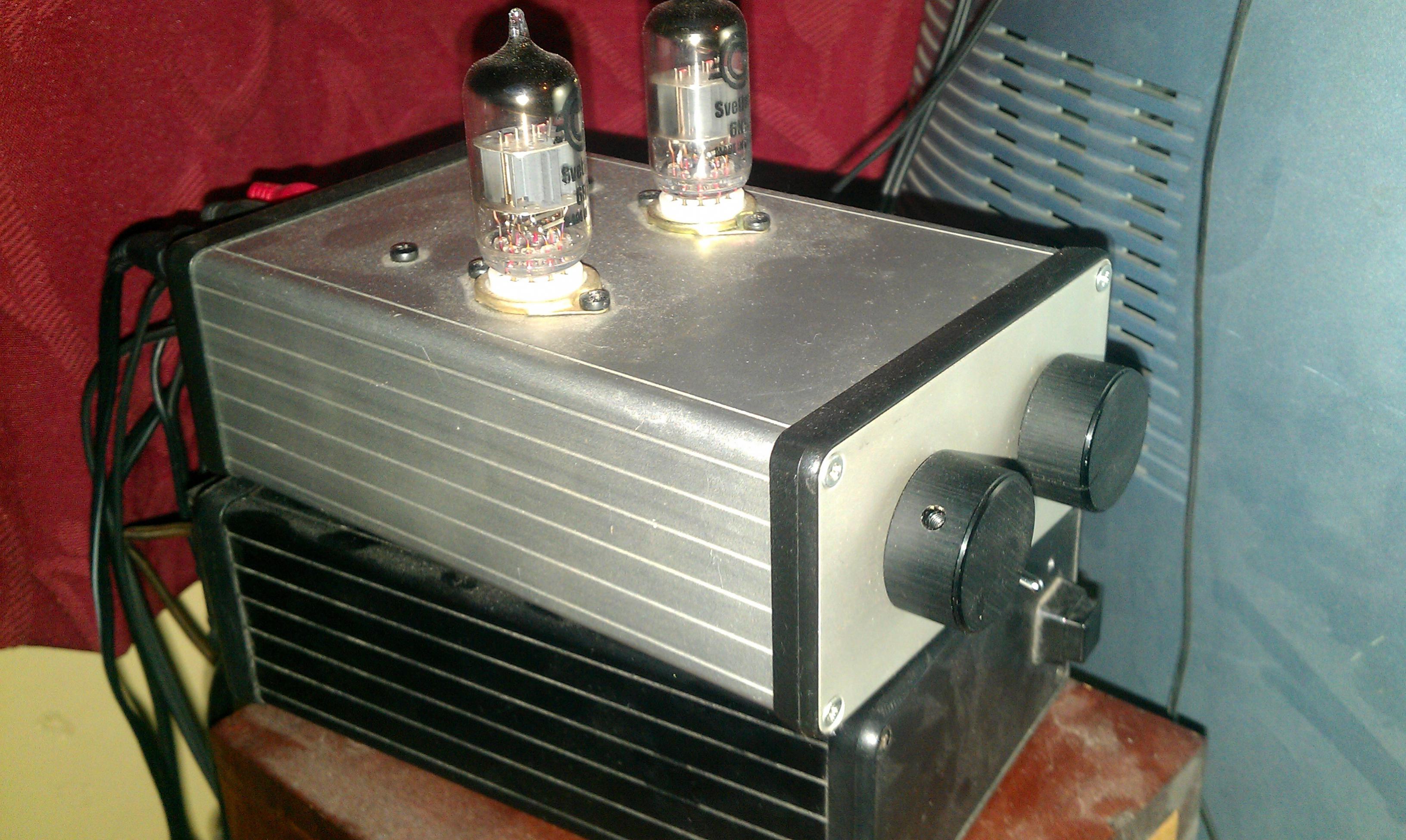

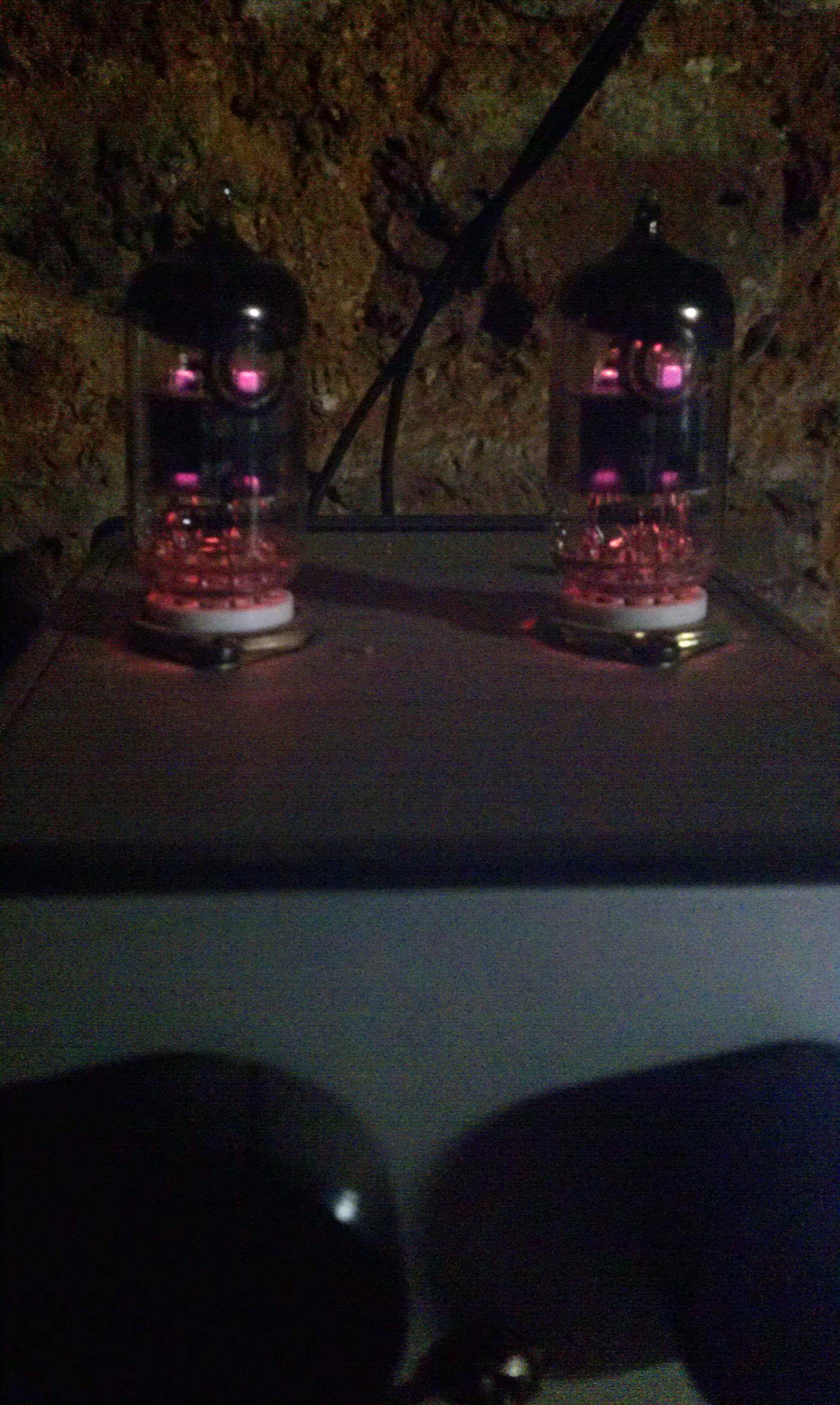

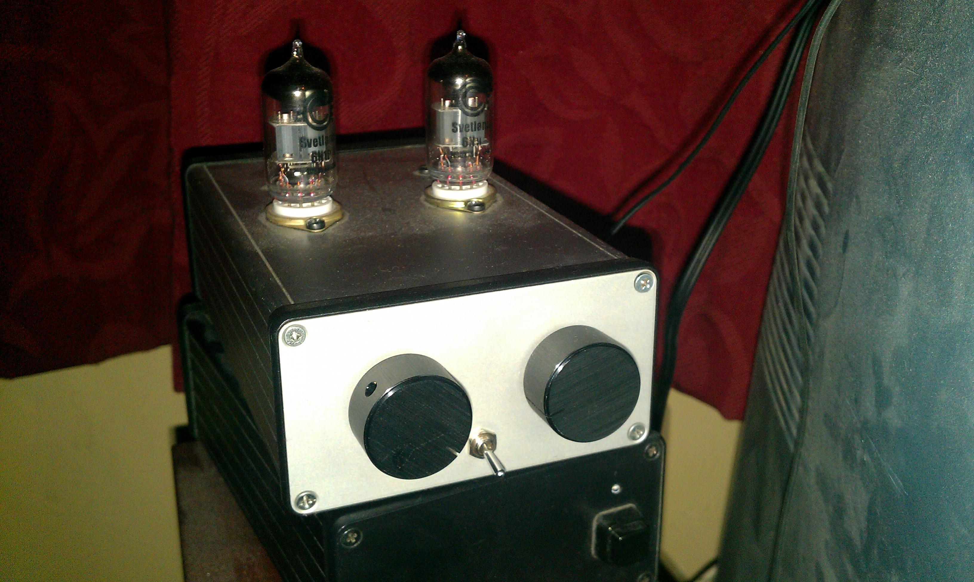

I did one very similar idea to that several years ago however in place of each FETs I used a triode element of 6N1P valve. I had 6 inputs from standard 2x6 way selector pot, Alps volume pot and packed it all into Hammond case complete with transformer inverter. This inverter allowed me to use 12V AC "wall-wart" power supply. Surprising was (I used it with LM1875 gainclones) - no hum and no switch on or off thump apparent!
Here's what it came out like...
