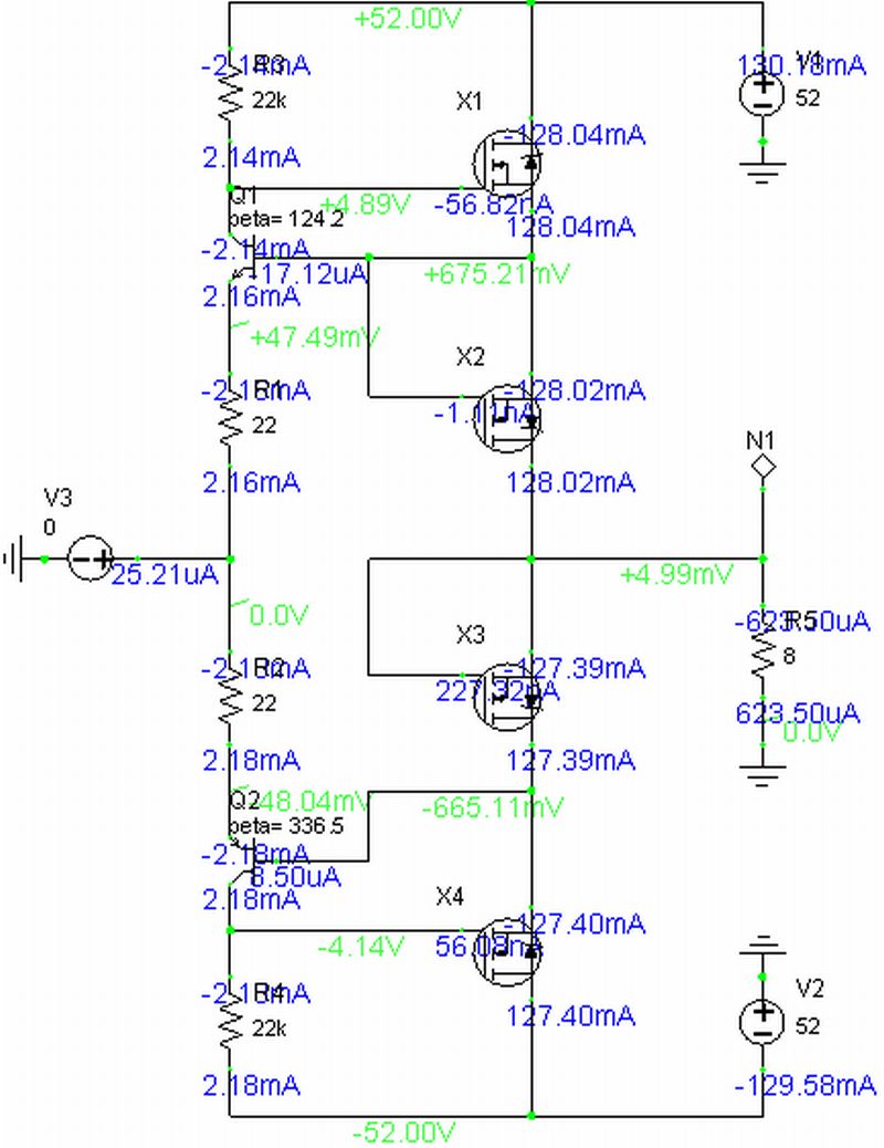

remove power section and use AN7062 as the driver of something like this.

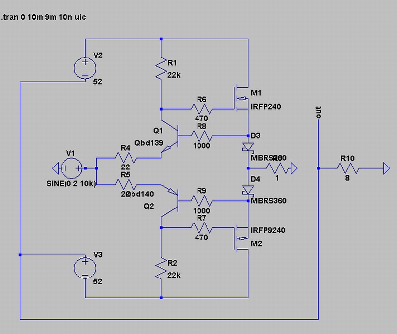

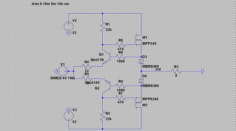

Measuring current in ltspice is easy, just pass the cursor over a component and a current probe appears, then just left click the component to get a graph of the current.
fOr power, do the same thing but hold alt and a thermometer appears.

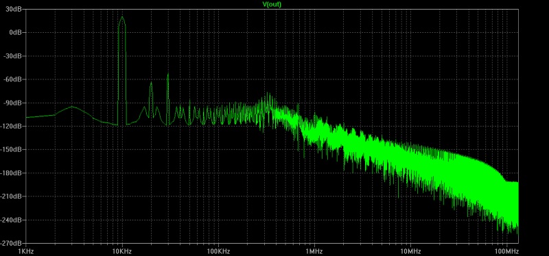

is there way to read static voltage and current in LTSpice?
Did you read that 3A was constant or sine through shottkys?
Maybe I made something wrong, passing over the part I got the probe and after leftclick got voltage on the graph, not the current...
Power measurement with alt pressed did not work:scratch:...
