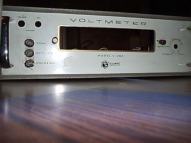

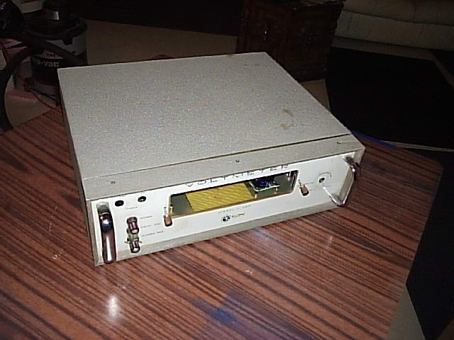

Feel BAD gutting a working Volmeter for the case!
Found a case for the phono preamp

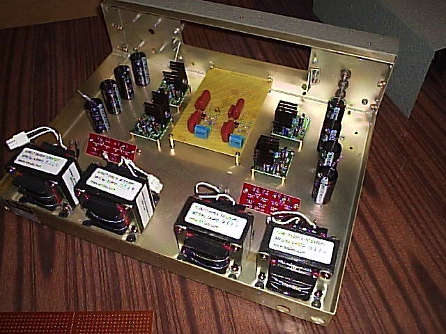

Trying out the layout inside. The problem is not sure how the super regulator supposed to be connected. The bridge rectifiers are BrianGT pcbs MUR850 the caps are 50V 10000uf per rail. The transformers are 40VCT 5 amp each center tap but I will only use half of each so I needed 4 altogether. I think this PSU is bigger than my high cap LM3875 GC! Way overkill monster phono stage!
It is bigger than my turntable:D Size matter or not?

Mikett said:
The type and size of transformer is not a huge critical factor as its effect is diluted by the regulator. You can go to some pretty high voltages by using the 317/337 preregulator since the voltage rating is the differential voltage (40-42V) and will drop the voltage to just a few above the desired above voltage. Thus a 40Vct is no problem at all, bringing about 28V down to 15V or so. Just attach a heatsink on the preregs.
The one difference which a transformer can make (particularly for a phono-preamp) is the energy it radiates itself -- EI cores and torroids have different patterns.
The other difference is that attibutable to from the tank circuit formed by the secondary inductance, the diode's capacitance AND the capacitance between primary and secondary windings. The ringing can be dealt with by placing a RC across each diode, or across the diode bridge. If you don't have the equipment to measure the transformer inductance, try using 10nF and 220R in series.
