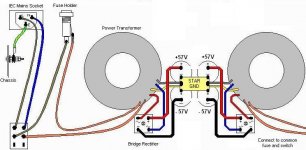

The speakers returns should connect direct to the star earth .
Check out the signal ground from the input terminals, they should go to the signal ground on the amp PCB or an appropriate clean ground.
You should have two ground returns to the star earth from each amp PCB, a signal ground and a power ground. All dirty returns (decoupling and zobel) should be connected to the power ground and not the signal ground. Alternatively the zobel can be mounted off board on the speaker output terminals.
Next the safety earth on the mains input needs a resistive connection (and/or //capacitor) to ground. BUT which ground???
keep it inside the PSU casing and connect to ONE power ground, or take a separate wire all the way to the star ground, or to the PCB clean grounds? Which one? or all of them (just kidding).

Andrew T - please forgive my newbieness, and this relates to your first post in this thread - what is a "dirty ground"? and what is a "clean ground"?

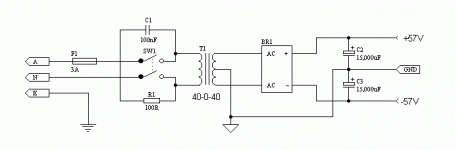

also - what is the purpose of the resistor between the PE and power ground? Rod Elliot talks of a capacitor, but does not mention a resistor...
is it a safety thing (probably) or a filtering thing (possibly)?
also - you seem to indicate that the signal ground should be kept away from the "dirty grounds"
how is this done with a single "star" ground point?
is the signal ground preferrably connected directly to the amp. board?
with the speaker returns connected to the power ground (star point?)
but these will all be connected anyways due to the star earth pattern on the PCB board???
BTW - is this simplified attached picture of how the grounds connect in a star correct???

Basically, yes, it's what I meant.
Well, you *could* connect both PSU lines together, but you shouldn't do it. The reason why even separate supllies would 'cross-talk' is that they would share a common current path, i.e. a piece of wire (with internal resistance) that would 'modulate' the ground potential, thus making it 'dirty'. I'll get back to this in a minute...
Nope, sorry. You could give this a try (as it is easy) but it could sacrifice distortion performance of your amplifiers significantly (and you probably only recognise it at loud listening levels, i.e. never in case you don't compare).

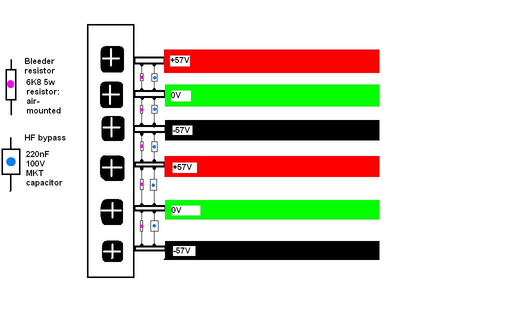

Basically, 'bleeding' is another safety feature. The capacitors are happy with storing charges, and their internal resistance would dissipate the stored energy over time, anyway.
But it helps to have the supply discharged in a 'defined' amount of time. First, it helps to prevent arcing when handling with the cabling during testing or setup, and second it helps to prevent arcing even days later, when you've already forgotten when it was turned on the last time...

The connections between the respective capacitors are just right. Now let me explain why, because it has something to do with...
Wire has resistance, and Ohm's law dictates that a resistance, conducting current, drops voltage. This voltage is an AC waveform depending on current draw and wire resistance.
A 'clean' ground (that is not influenced by such introduced AC modulation) gets dirty just by connecting it to the (ground) return path of a part in the amp which draws higher currents. If, say, your signal input shares a piece of ground wire with your power ground on the amps (for local bypass capacitors and snubbers), then the signal ground will get modulated with the AC voltage that the piece of wire drops (due to 'shared' currents from the amp board).
It's as basic as Ohm's law R=U/I. The voltage in a piece of ground wire can thus be calculated as U=R*I, with R from a table (depending on your wire material, width/cross-section and length) and the (maximum) current that flows through that resistance.
Say, your shared ground has 10mOhm of internal resistance and it conducts 1A. This translates to U = 10mOhm*1A = 10mV of modulation amplitude on your signal ground. As the amplifier actually amplifies the difference between it's input wire and it's respective ground, a 10mV 'hum' between those two lines will be 'seen' by the amp.
If you amp has a gain of (say) 20, this hum gets amplifed to 10mV*20 = 200mV at the speaker output. Clearly audible, as it will produce P = U*U/R = 200mV*200mV/4Ohms = 10mW into a speaker.
It's a filtering thing. It's not absolutely neccessary and could be a piece of wire in case of a 'perfectly' working grounding scheme. But a resistance between circuit (power) ground and PE damps ground loop currents a little, without ruining safety too much.

re: bleeder resistor - yes - it was late when i drew that picture (lol!)
so are you saying 6800ohm is too high? maybe 4700ohm or less?
It's not too high, I was just asking what you intended with the resistors...
I've seen an ugly picture of a guy's hand on the net. He had an accident during repair of a low voltage power supply that was not yet 'bleeded'. His wedding ring shorted the capacitor terminals and melted. I'd say he lost the finger, at least partially...
also - do you think the rectifiers need bypass capacitors too - like 100nF?
Just like the others, I would recommend properly calculated 'snubbering' at the amplifiers.

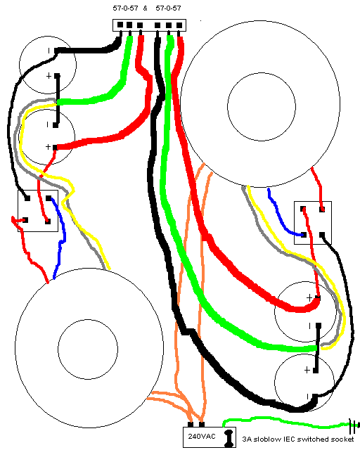

does that diagram have three 'earth' points or just one?
it looks like three to me - two in the PSU enclosure and one in the amplifier enclosure...
if it is just one, then i will be VERY happy,
if it is three - how can i resolve this when using two seperate enclosures?

and if you say my twin enclosure diagram has the 0V lines connected "just right" - are you saying that the layout for my connections as best as we can get with a twin enclosure setup?

Finally the safety gound thing is filtering;- some deigners use a switched set of resistor//cap//diodes//dead short connecting safety to star. If you omit the resistor and use the dead short the amp has 2 connections to chassis and a potential hum then exists. A bit complex but your separate PSU may deserve this, try different connections until a quiet solution emerges.

- is my PSU layout OK?
