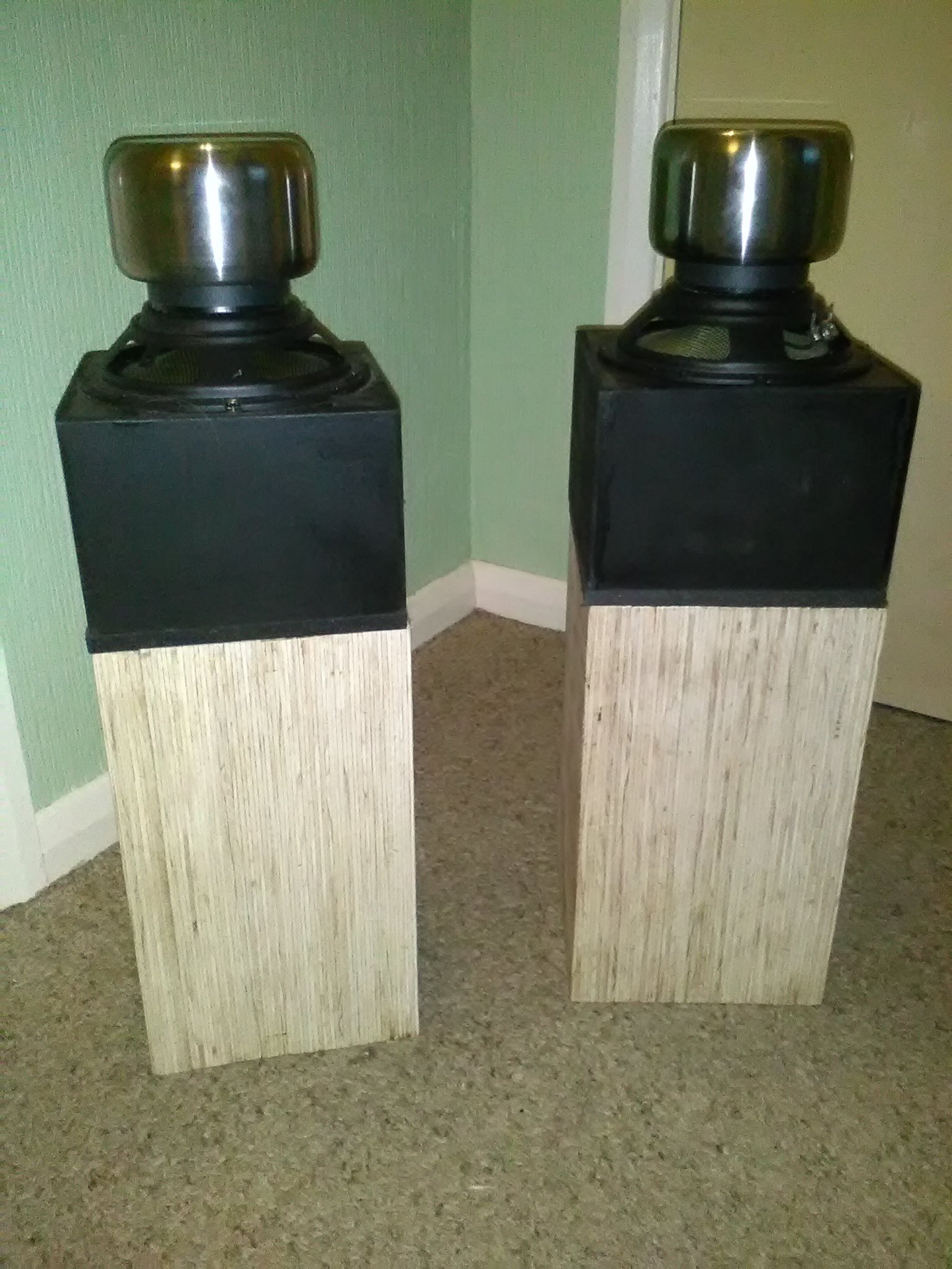

Get yourself a 15. Solder some wires to the terms or otherwise ensure rock solid connection. Hold it in your hands and light it up, live at a pretty normal level. Hold it by the magnet. Hold it by the basket legs. Hold it by the rim. All will become clear :)

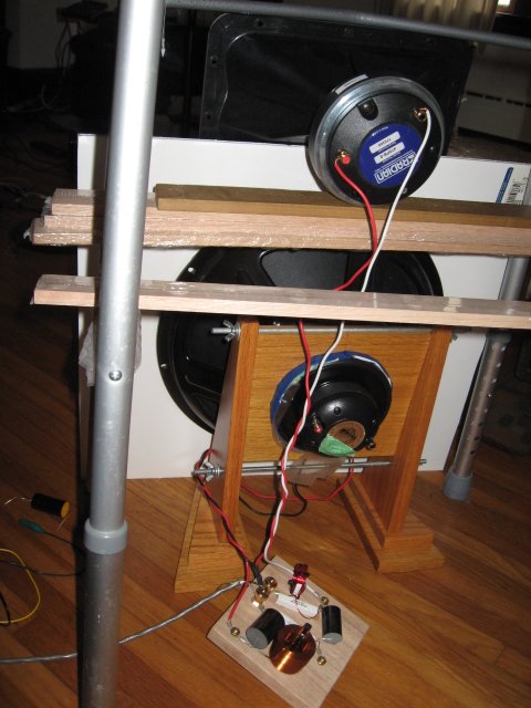

I first did it on OB experiments so I could knife-up various posterboard baffles and take some curves and mess around listening. Stole the idea from Darrell Hawthorne (his was prettier). Mine isn't even fastened/glued--the "cups" fall right out when things aren't tightened--and you just cut new ones for a new diameter when messing about.
Doing it permanently in a real cab is a pain in the shorts. After busting my brain, brute force is always simplest/cheapest--simple normal (but thick) and brace brace brace. It's not only panel radiation, but what's conducted (transmitted) through the things as we all know. When I was young, I liked "warmth". Now, I can't stand the stuff and prefer clean. It's speakers, man--everything costs something (or three other things).

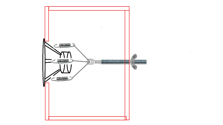

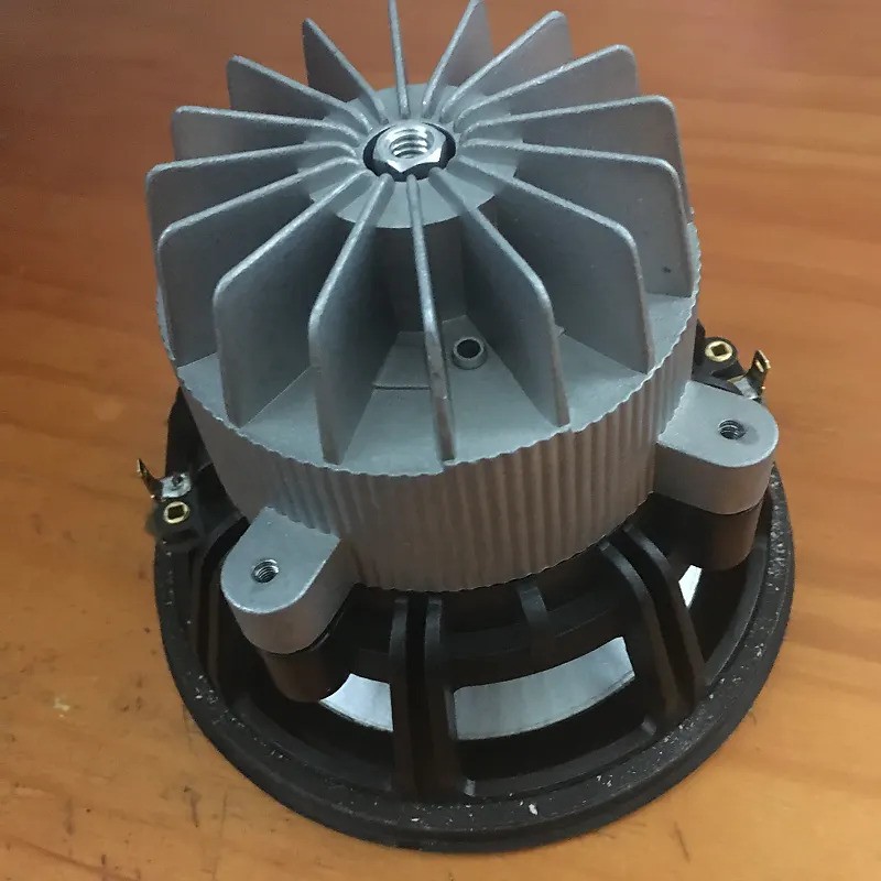

Energy did this in two different ways in their Veritas line: cup supporting the woofer magnet in the 1.8 (and likely in the 2.8) and a threaded nut in the back of the woofer in the 2.2/2.3/2.4 line, with a threaded rod that went through the cabinet from the back of the magnet to the rear of the cabinet.
In the 2.x series, there is a hex nut in the back, that tightens to pull the woofer in towards the back of the cabinet. In fact, there are no screws around the speaker rim - it's held on via that threaded rod.
They had problems with the first iteration of the 2.x series, because the glue that held the magnet to the basket would eventually dry out and give way. This was resolved in the "i" series (2nd iteration) of those speakers, where the magnet was held on to the frame with 3 pretty hefty screws.
Here's an example of the later "i" series woofers

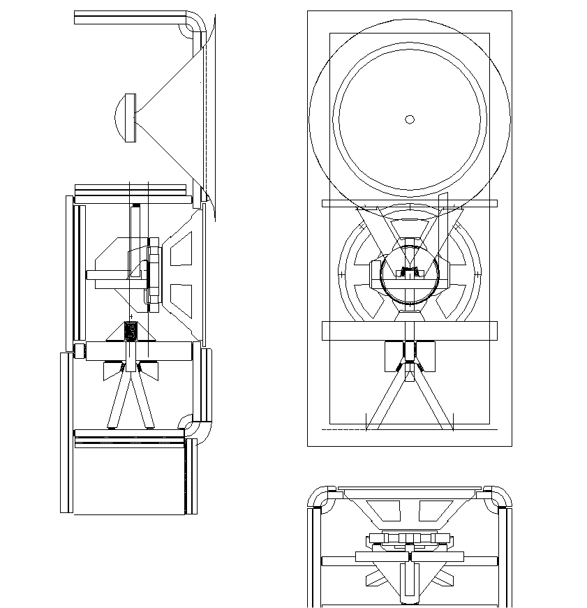

Yes, one of the cases i found as well, however if i read thecimage and text correctly it prevents thecheavy magnet from sacking under itsxweight. It does nod provide axridgid support in the axial direction.
Yes, for horn speakers the sagging problem is more dominant as horns are usually long and they 'fit' from far away (say ~1ft). Besides, when the bass develops in the woofer (often in the same cabinet), part of that energy could cause vibrational movements in the horn driver as well.
Horn drivers do not generally make bass frequencies, but if axial support is necessary (in addition to radial), it may very well be provided. Assuming the woofer to be in the same cabinet, some enclosure volume would be lost, but that should be straightforward to calculate and compensate for.
if You have access to the cabinet's inside, then one can mount the driver from inside against the front by using a large-headed machine screw pressing against the magnet.
I did that with my A-style folded Dipole, that btw. was too small to even use the original basket holes for fixing.
Besides only having to tighten 8 screws for 8 drivers -instead of 64- the cabinet considerably 'deadend' under the pressure/tension.

The approach described by @lrisbo is what i currently are designing, be it that the sagging mentioned by @newvirus2008 in this approach will lead to a unequal load on the 6 flexible mountings(flex washers). Therefore i will add a radial support for the magnet (which is about 1 kg).
Will post tomorrow some pictures on how ith might look like.

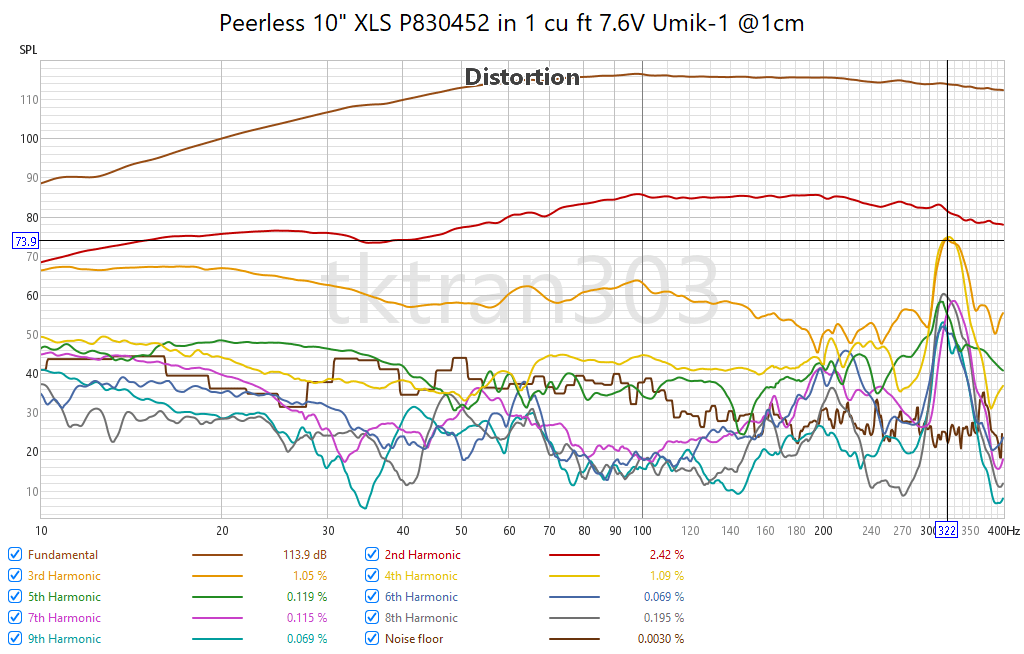

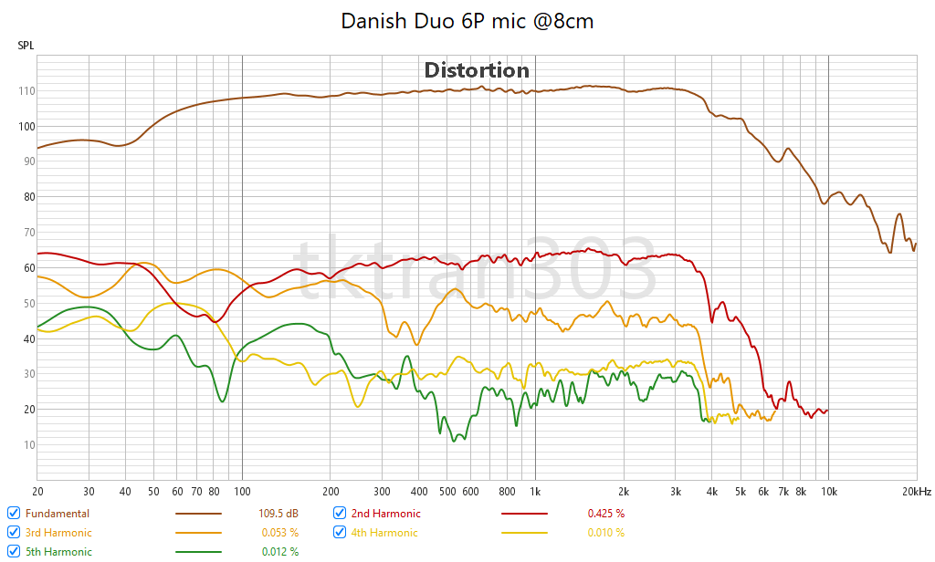

It's definitely worth doing. My apologies for the delay in getting back to you. Here's the data that I promised:

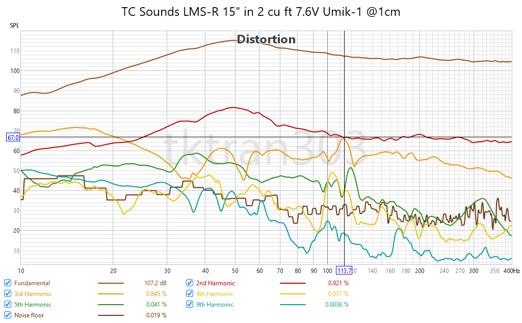

Below are measurements of 2 woofers, a 10" and a 15". In seaed boxes, taken in the near field.
At the cursor position is a resonance that can be measured by an elevation in all the harmonics.

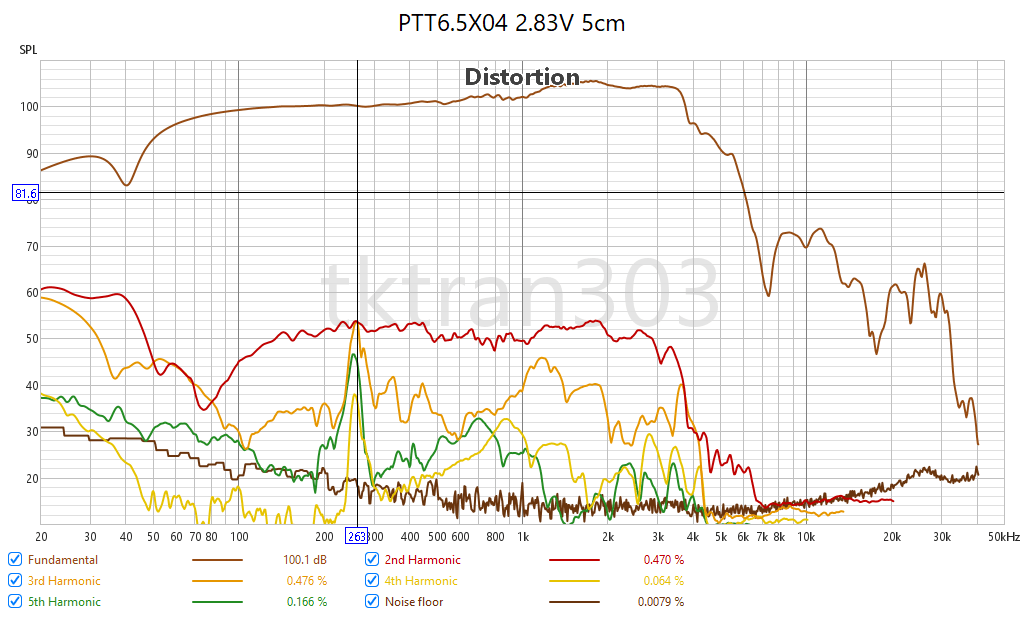

Here is a woofer that I also noted this:

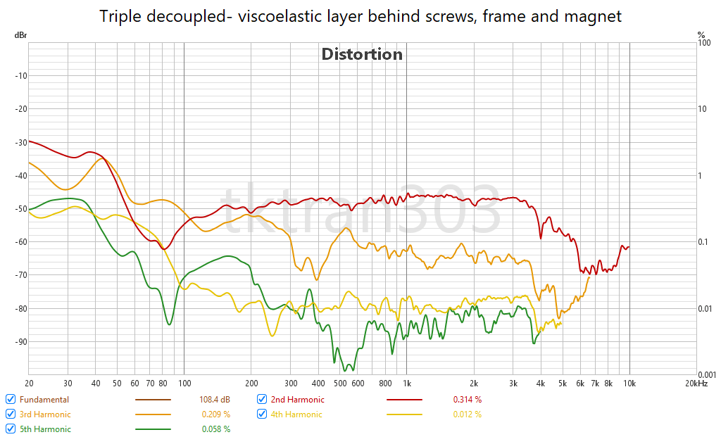

I used a viscoelastic layer behind the screws (between the mounting screws and the frame), behind the frame (between the frame/basket and the baffle) and behind the magnet (between magnet and brace). After this triple decoupling, this is how it measured:
As you can see, all harmonics that was previously seen has disappeared.
I shared this work with a few people privately, but thought it would be good to put it here for other to explore. A lot depends on your cabinet weight/stiffness and your driver. You may have to do some empirical testing to see the before and after effects.
You don't need an excellent microphone to be able to detect there. In fact I use the USB connected umik-1, which has a relatively high level of H2 as a 2nd mic to detect these. In fact, even if you don't have the ability to take distortion measurements in the nearfield, a logarithmic (or zoomed) impedance trace is also helpful. The resonances appears as blips in the impedance response that isn't seen in the manufacturer's datasheet.
