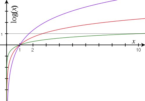

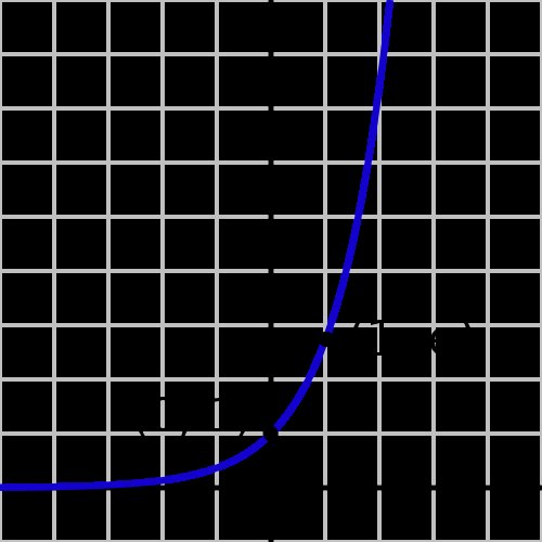

Hello Perfknee, here's a couple of graphs that should explain what I mean. Basically, what I am saying is that your monetary investment (possibly time also) increases exponentially (whether DIY or purchased) and the performance grows logarithmically, reference the two graphs.
The first graph is an exponential growth, the second logarithmic
Peace,
Dave
Thanks Dave for trying to clarify. I don't mean to beat this to death, but I still don't get what the second graph is about... what are the horizontal and vertical axes of the two graphs?
The first graph is exactly the "Performance Knee" that I was talking about, with performance (vertical axis) versus price (horizontal axis). The "Knee" where I like to buy is right in the horizontal middle of that graph.
