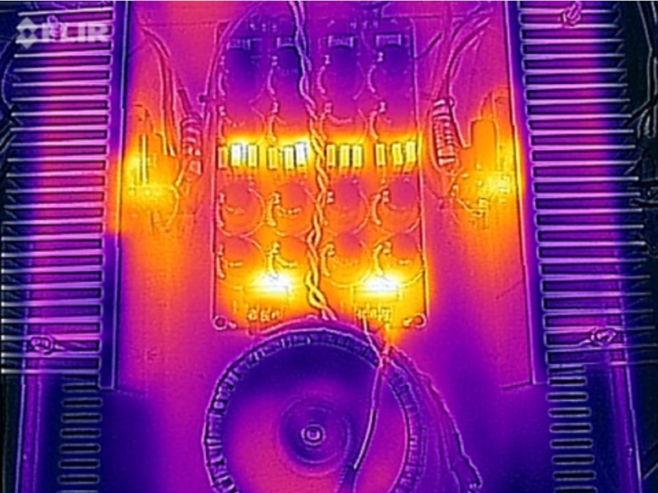

I always have a fan on my guitar amp designs.
The heat sink is right inside the enclosure on a pcb.
The enclosure I use has plenty of vent holes to get a good air flow through it.
Adding a fan does make noise though, unless you have one that is speed controlled via feedback.
I have a Marshall 100 watt amp with a tiny fan on a heat sink about 30mm by 30mm.
For some reason they use cheap fans and they don't last very long.
I had to replace mine.
