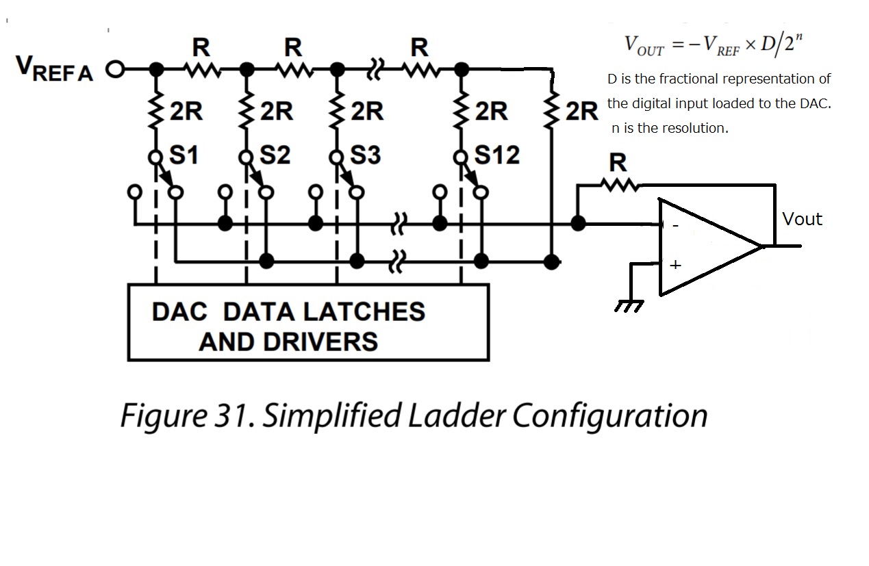

Actually that is exactly how single-balanced transistor mixers are normally made: a differential pair is driven so hard by the LO that it acts as a switch and the RF is superimposed on the tail current.
In any case, any type of DAC multiplies its (dimensionless) digital input signal with a voltage or current reference to produce an output voltage or current and therefore acts as a mixer between the digital code and the reference.

I partially agree with you about a mixer. It's correct every DACs are multiplying between the reference and the input signal like the attached pic. But the input of a DAC is digital code. The multiplying is between the analog reference and the digital input. An RF mixer such as a superheterodyne is done by two analog inputs.
But you need to consider another "mixer" effect for a multiplying DAC. It's crosstalk from digital input to the reference and analog output. When I think about this type of "mixer," I can remember some cases which had a chance caused by "mixer." I wrote before crosstalk from base to collector could be neglectable. Some are so, and others are not so. This is one factor of degrading SNR, sometimes inherent to a DAC chip and inherent to a PCB, IMHO.

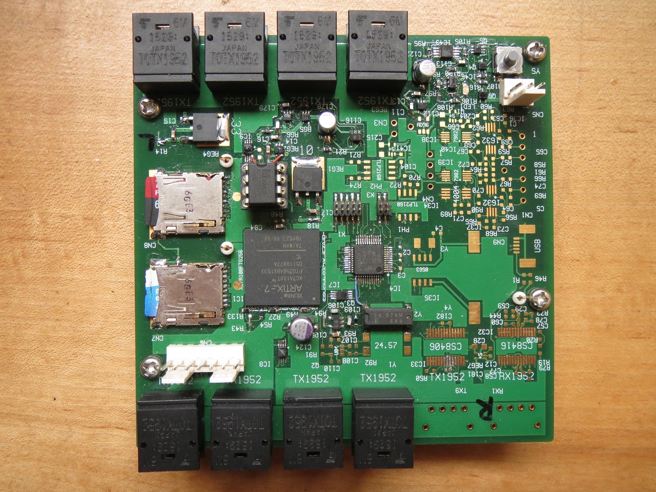

Crosstalk from the sigma-delta modulate to the reference and to the clock is indeed a problem. It is the main reason why I went from a point-to-point wired version to a four-layer board for my valve DAC; on the point-to-point wired version, simply touching the insulating jacket of a thin coaxial cable that carried the sigma-delta modulate was enough to increase the noise floor by 10 dB or so. I now have all digital stuff on the bottom side, all analogue and mixed-signal circuitry on the top side and use the inner layers as shields and as signal return paths.
Your valve DAC is a fascinating approach. I think PCB layout is more dominating than a DAC chip. Modern DACs have excellent performance which can be achieved only in the best circumstances. PCB layout and power supply are important. PCB layout usually has less attention than power.
I also use four-layer PCB but has another layer structure as you. Almost every part except for bypass capacitors are on the top layer. Analog signals are also on the top layer. The remaining area of the top is the ground plane for a shield.Digital signals are the inner layer(L2). The ground plane is the inner layer(L3). Digital signals are almost sandwiched between the top side ground plane and inner ground plane(L3). The bottom side is power.
My intention is a decrease of radiation noise from digital signals. Inner layer digital signals are less radiative. This is the only attempt for an audio system. This requires more vias than a usual layout. In some applications, many vias cause problems. This is the good layout for high SNR application as long as I have experienced.

Nice board! I posted some photos of my DAC here:
