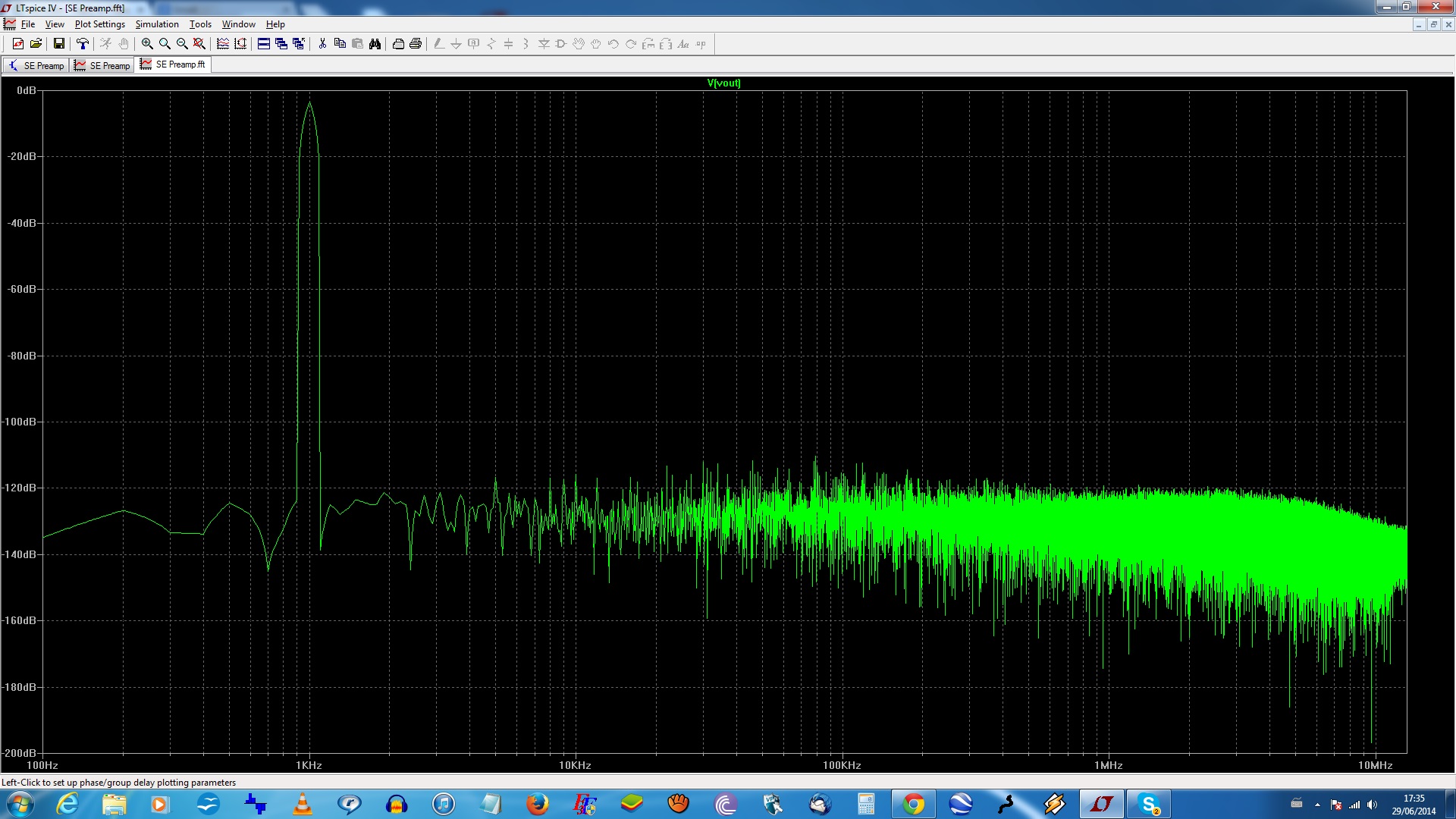

That could very well be ... this is interesting for me because i am designing my first line driver preamp unity gain ... the fft is attached (thanks a lot again Mr Mooly )
Not bad for a single npn i guess
Maybe i should be less obsessed by distortion

I tend to focus on noise rather than distortion. That's because distortion as shown in your first plot is an artifact of the measurement stimulus. Single sinewaves are highly improbable in music so in my view are an idiotic way to test an amplifier. When an amp is stimulated with music (by which I mean the kind I mainly listen to, classical instrumental, orchestral and choral) the non-linearities in the amp produce modulation noise (noise correlated with the signal), not discrete harmonics.
Sine wave measurements (single, dual tone-CCIF, multitone) are the straight way to detect exactly the same nonlinearities (and than find way to supress them) , those caused "modulation noise" (intermodulation) at music reproduction..Here is nothing else, no magical "X" distortion. Amp with distortion as in first plot will create with complex signal very high intermodulation backround .Single sinewaves are highly improbable in music so in my view are an idiotic way to test an amplifier. When an amp is stimulated with music (by which I mean the kind I mainly listen to, classical instrumental, orchestral and choral) the non-linearities in the amp produce modulation noise (noise correlated with the signal), not discrete harmonics.
