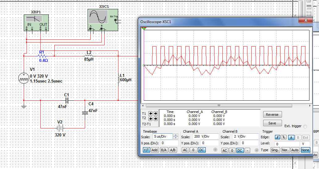

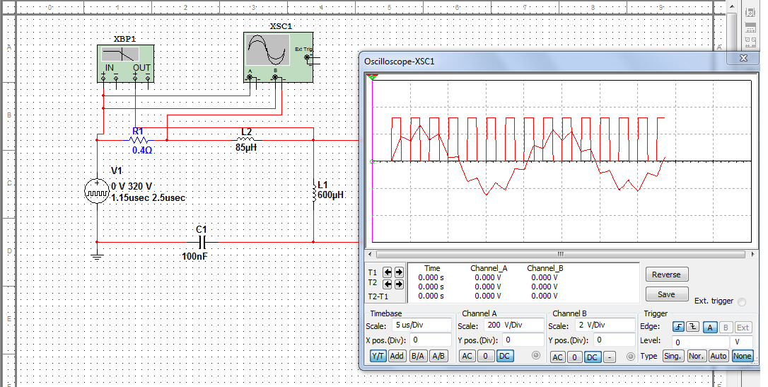

I used a single 100nf 500 volt AC capacitor.
Do you mean put two 47nf in parallel ?
No, see the atached pictures.
Nigel_your is the single capacitor. Nigel_split is the split capacitor.
The error is because of the IRS27951 longer first impulse. At startup the middle of the split capacitor has voltage of half the primary supply voltage. So this cause less current transient at startup. It can solve the problem.

Using 2x47nF as I drawn on schematic will decrease the current transient at startup. Also a lower Rdson FET will have less voltage drop.
Also you can cahnge the 100nF to a single 47nF, then recalculate values for a higher frequency etc... This will decrease power output,and also peak current.
