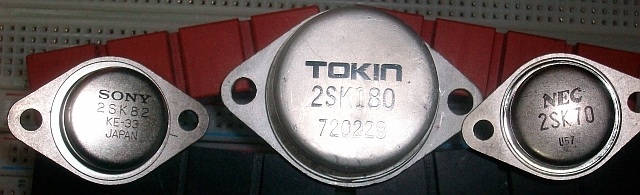

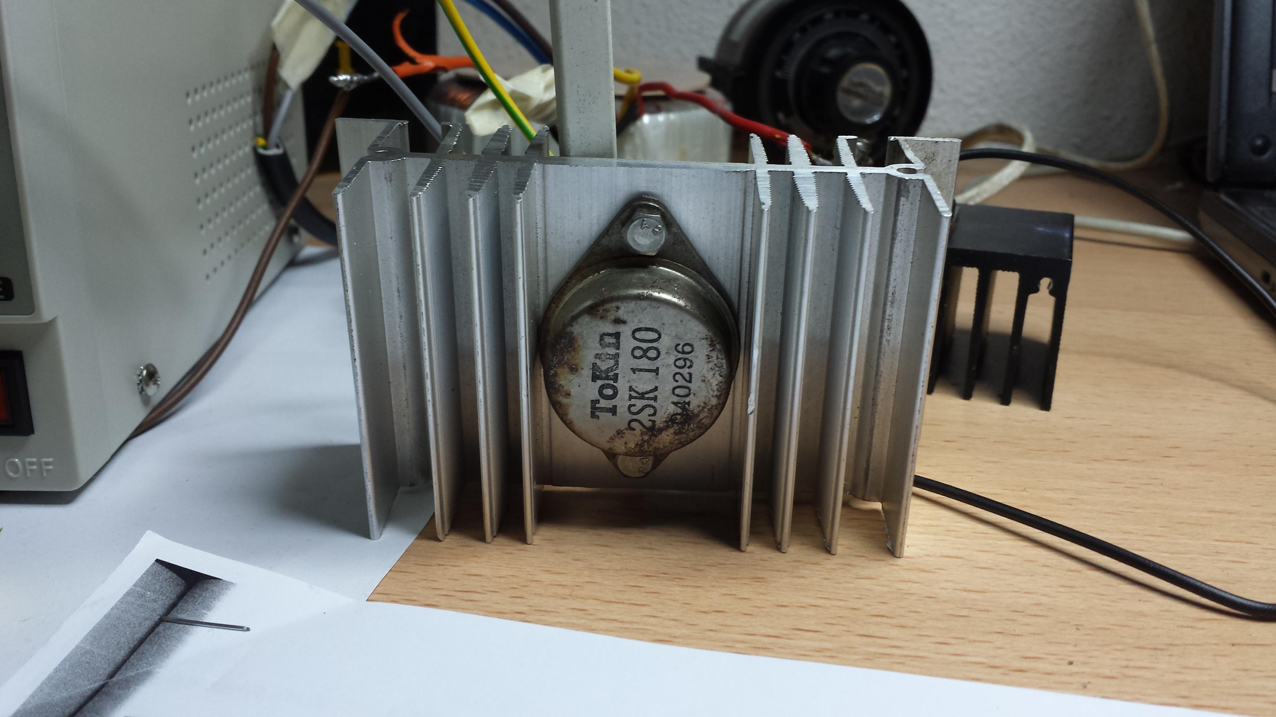

Hello DIYspaceW. I have four pieces and I buyed from ebay source. There is not a lot sources, only a few. But they are very old stock and are a little oxidized, but electricaly are good. I check the four mine and are OK.

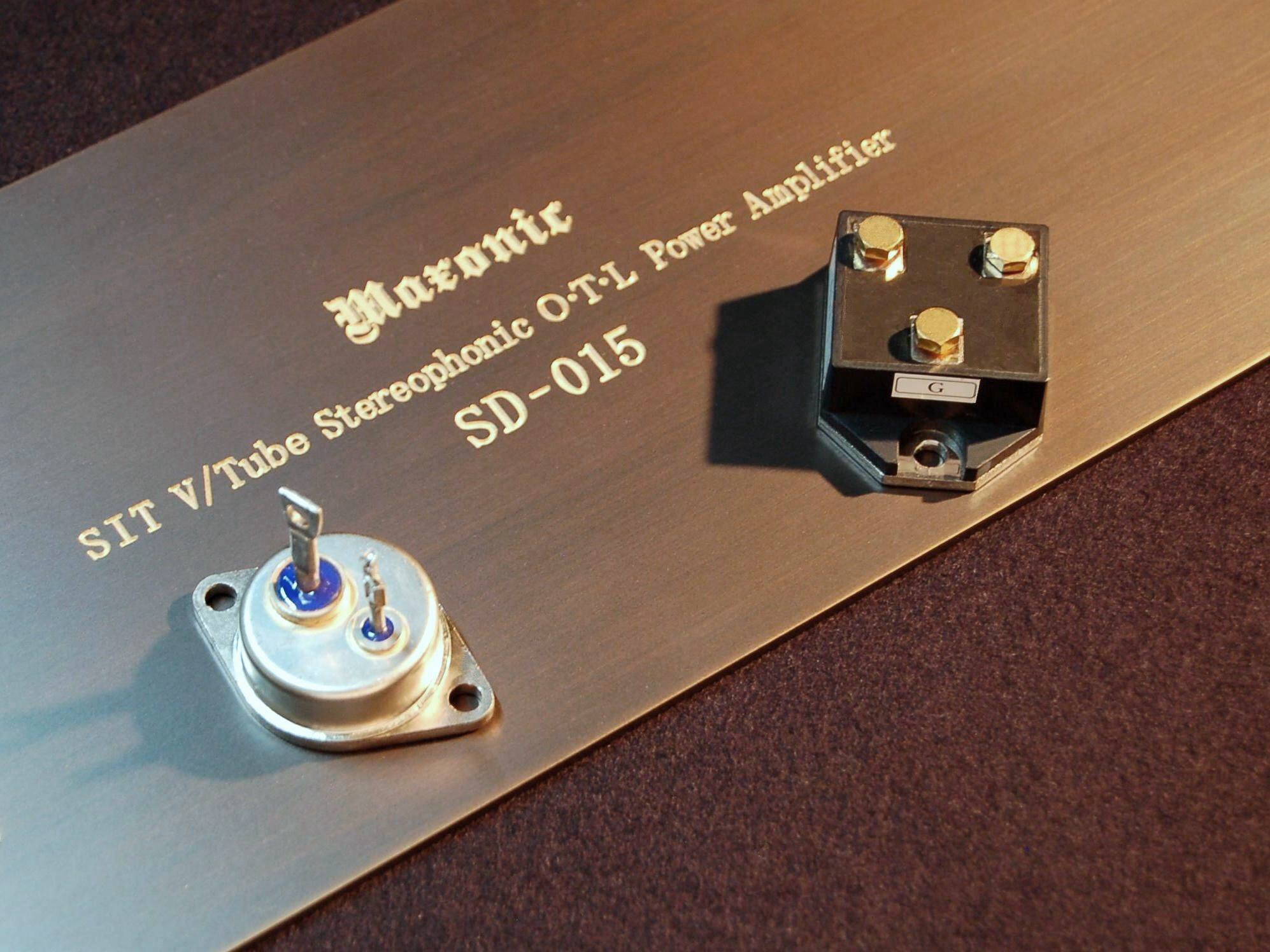

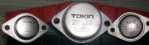

Ironamp with Tokin SIT's ?
Can this transistors be adapted to Ironamp topology ?
I have find 100% genuine supply of 2SK182ES version of SIT 's in Japan.
He send me all datasheet of device but is not pdf i be try send if possible or You can ask him directly.
Anyway this is e-mail i have received from Sibatech .Inc
Best regards :)
" Many thanks for your inquiry on Maxonic/ SIT to our website.
Although "2SK77B" is not available from Maxonic, "2SK-182ES" SIT is
possible instead by \19,500/piece (Plus shipping cost) (Left side round
shaped device on attached photo)
Thank you very much again for your kind attention in advance and we look
forward to your kind response, soon.
Yours Sincerely
Hiroshi Ishihara
Director
Sibatech,Inc.
No.1301,8-25-22
Higashisuna, Koto-ku,Tokyo
Japan 136-0074
TEL:813-3645-1646
FAX:813-3645-1948
E-mail: <hishihara@sibatech.co.jp>
URL:Sibatech, inc. High-quality Audio Equipment from Japan "
