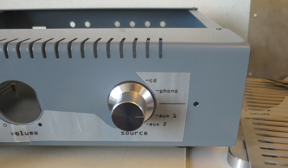

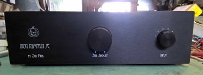

case almost done and i want to realize a mini jack input on the front (randomly people come by, saying "i got a version of Gary Peacock NOT messed up by Keith Jarret", but just on the i Pod..
But mini Jacks put gnd r/l together, does this mess up seperate ground scheme, or doesn´t it matter because it´s in front of the buffer?
tnx!
Edit: I have minijack that does not connect signalgnd to chassis

it is messing with overal GND scheme
however , considering that (separate) channel GNDs are meeting together at chassis , each having 10-15R NTC in line , that means they're separated effectively with 20-30R
when you introduce input having common ground for both channels , to avoid shorting your precious separated channel GNDs , series resistor in one lead is a must

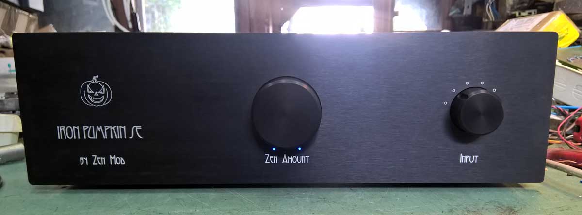

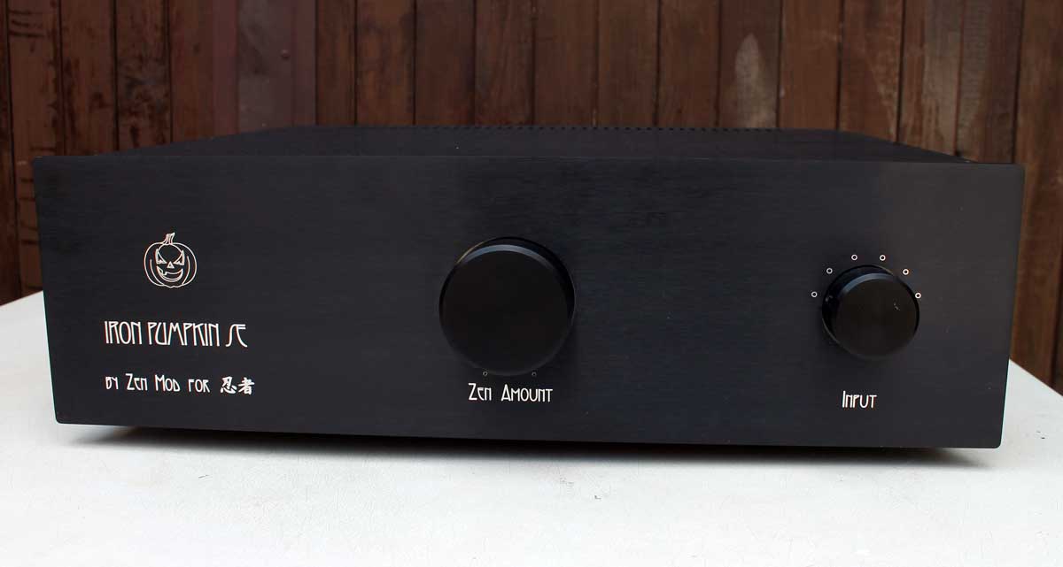

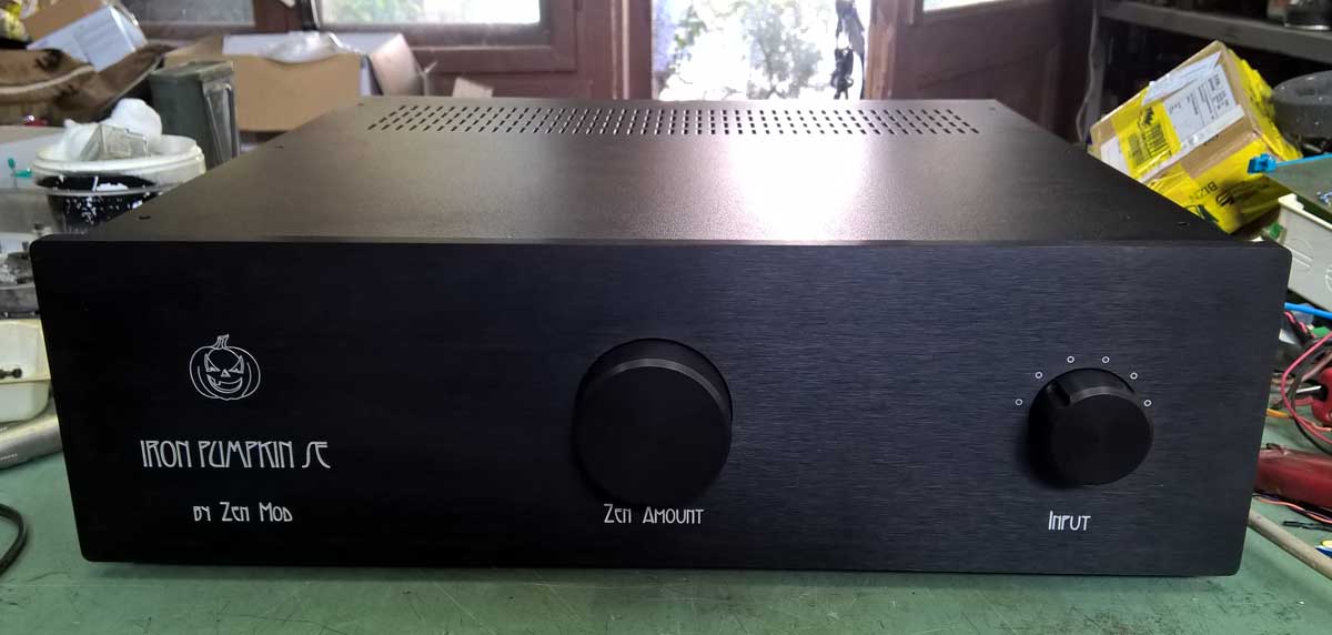

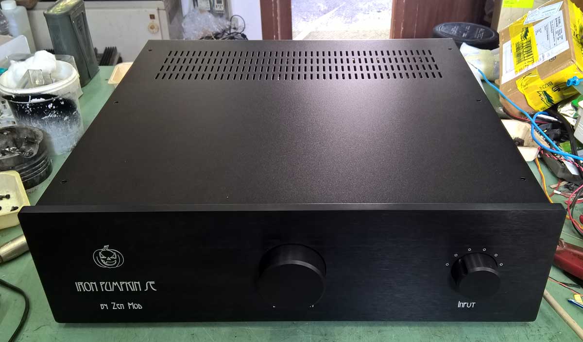

3HE : Slim Line 03/350 frontale 10mm NERO e coperchi in alluminio 3mm
2HE possible , but veeery tight in height , and no height for base plate
my own is in pesante (Hillbilly , for less fluent in "Talian ) 3HE/400 , all steel , except front plate
