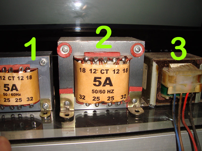

but I gonna confused with this image from my real world
no 1 = must be fake, 5A * 64v = 320VA to small for that power
dimension 3" * 2.5" * 1.75" (stack)
primary wire = 0.25mm diameter
secondary wire = 0.7mm diameter
no 2 = maybe its okay, 5A * 64v = 320VA, or maybe 5 * 32 = 160VA?
dimension 3.75" * 3.25" * 2.15"
primary wire = 0.5mm diameter
secondary wire = 1.2mm diameter
no 3 = was used in 30watt amp so its maybe quite good transformer, even the iron core is black in color, anyone know what is this core name?
all trafo for 220 volt ac input
the AWG table make me more confuse, from the shop that I bought wire they ask me in mm diameter not AWG's.
Can anyone show me the right AWG to metric conversion.
then for 0.25mm 0.5mm or 0.7mm diameter how much currents can flow safely?
Please tell me the actual reliable VA for no 1 & 2 ?
so my mind can be clear

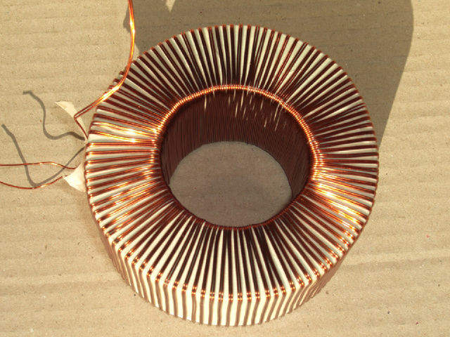

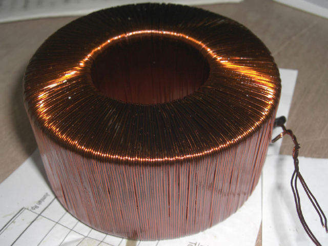

What about this toroid?
I hope this one is more interesting to discuss :)
but I still waiting someone to tell me the approximate VA for no 1 & 2?
Anyone can give me new formula for this trafo, please?
few years ago I made it,
it's okay or bad trafo
even the formula to make this trafo, I don't know
Maybe better if any suggestion to testing to know it is good or not
