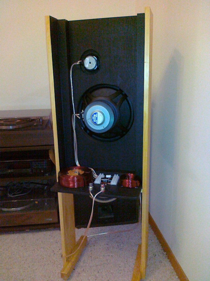

I have my crossovers 90% rebuilt - going from stock components with high-quality components replacing the caps, resistors, speakerwire, and adding Blackhole 5 inside the enclosure which has elevated the sound tremendously. The only thing left as stock on my crossovers are the inductors for the midrange woofers, which are iron core. Although I have not had any issues with them, I have read that air-core inductors are actually better. I am thinking of moving to air-core to add texture to the sound. (My tweeter inductor is air-core and has been replaced with a Jantzen air-core inductor, I am quite happy with it and will not replace it any further.)
The specifications of my laminated iron core inductors are:
Set One:
4.1mH, DCR 0.60 ohms, 18AWG
1.0mH, DCR 0.25 ohms, 18AWG
Crossover Frequencies: 800 and 1500 Hertz
(I assume the third crossover frequency - 3000 Hertz - is for the tweeter inductor)
Set Two:
2.0mH, DCR 0.50 ohms, 18AWG
0.5mH, DCR 0.20 ohms, 18AWG
14mH, DCR 11.35 ohms, 26AWG (this one is air-core, I should be able to find a suitable replacement from Jantzen)
The crossover frequencies are unknown for this set, however, there are only midrange drivers. There is no tweeter involved in this set.
Is there a formula for replacing these iron cores with Air-Cores? When replacing, I will need to keep the DCR the same. I take it I need to keep the mH the same as well. Do I need to keep the AWG the same, or can I use a larger AWG (going with a smaller number)?

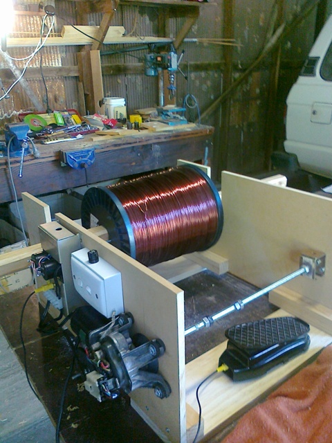

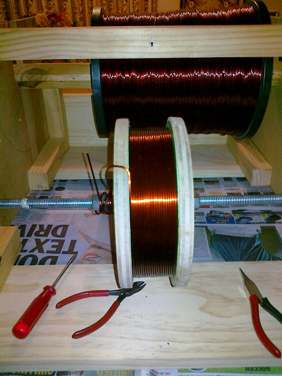

The hard part is finding a supply of wire long enough. I ended up buying 50kg of 2mm wire to wind my own crossover inductors, 20mH and 2mH. Way more than I really wanted.
Tried a hand winder, couldn't keep the tension constant. So designed and built my own electric winder based on a scrap yard windscreen wiper motor. Had to make a pulse width modulated drive circuit to give variable speed control with good torque - 2 mm wire is quite stiff. Had to steal the foot control from you-know-who's sewing machine as well. Photo attached of the winding machine and the finished inductors. It took months to find the copper and sort out the winder and only days to actually do the coils.
The 20mH ended up weighing about 5kg. Its very big.
The end result is worth all the effort.
