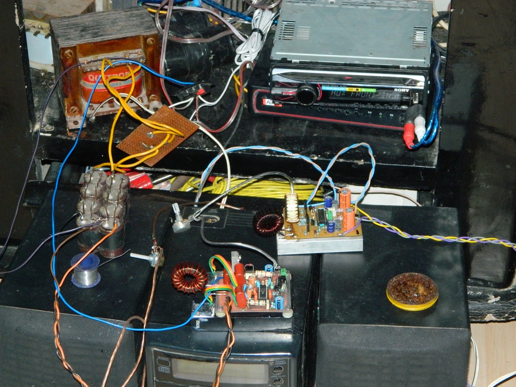

greetings at last managed to make amp work using IRFN250 supply
voltage 50 0 50 dc just some pics
warm regards
andrew lebon

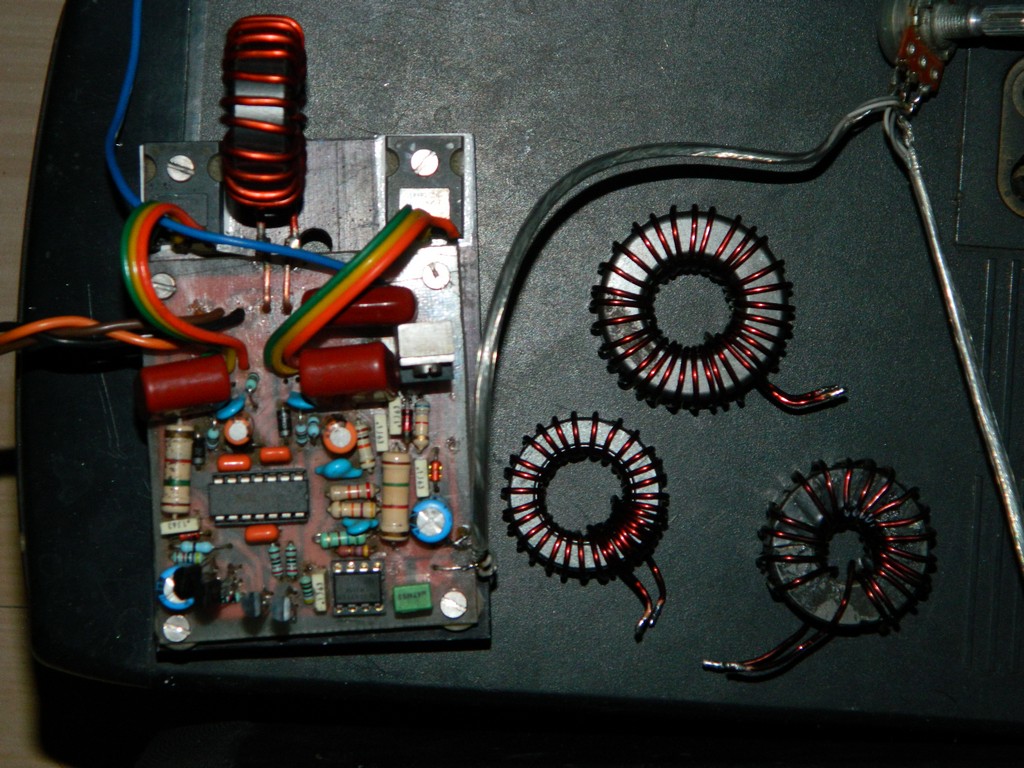

Hi Fredos,
my coil is T106-2 core ordered from USA and 63 turns = 54uH that's the material you advice for switching amp isn't it ?
When you tell a bigger cap you mean 680n or 1u ?
= decrease cut off frequency of the output filter to minimize ripple at the output , that's it ?
Yeah ! the sound is great bass are deep and high are very clear...
very surprised of the result on a single sided board.
No real life high power test : only small jbl at home ;-) .
Thanks a lot.
The next step is overload protection setup...
Learning a lot about class d amp.
just a bit affraid to push it to clipping (bad experience before : 4 fets and 2 drivers blown...).
do you think duty cycle limiter is necessary to avoid clipping ?
Alexis.
Try air cored coil from one of Your speaker crossovers. It will heat itself a little, depending on DC resistance, but it will never go into saturation. Then try to use 5 100nF foil capacitors instead of one 470nf. Smaller capacitors have bigger specific ripple current allowed. also decouple PS not only + to - but also to the cold side of the filter capacitor, using also several smaller capacitors. Reduce loop area of those decoupling networks by tight mounting. Forget the PCB, use spider web technique..., all in the air, but with short and fat connections.
