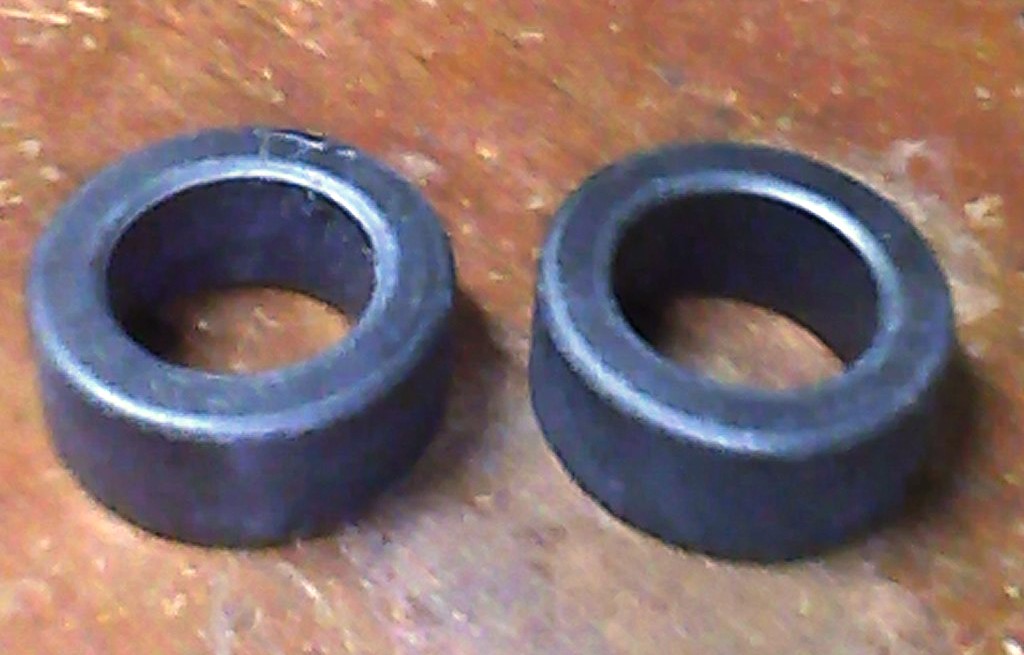

Hi chacalpowers,
Is this toroids good for smps?
Kiko,
Are those toroids #77 material? If so, they are ideal for SMPS main TRANSFORMERS. They look like FT-140-77s. I have used them in car DC-DC power supplies and off-line AC-DC SMPSs and they work great. Useable frequencies up to 100kHz, too.
