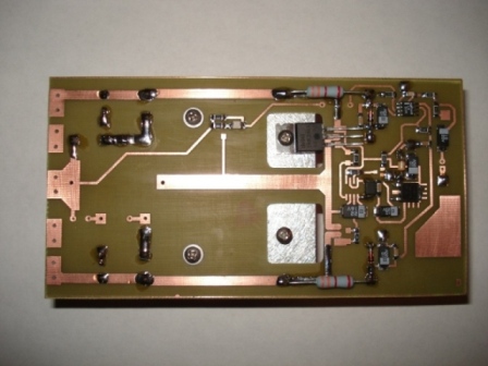

Ir2104+ Irf540
Here is picture of my PCB and some components markings on.

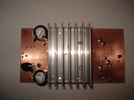

PCB is double sided.PArts are on top side and GND is all bottom side.Heatsink will me mounted on bottom side of PCB.I will cut off PCb where IRF540 are and mount them on heatsink.

Judging by the questions about elementary electronics that you make, you don't seem to be ready at all for such a project (and there is already too much low-quality class D out there giving us a bad name :dead: )
The theoretical maximum RMS power output is V^2/(2*R) where V is peak output voltage, that you can assume to be rail voltage (40V for your case). Do the math. For class D you have to ensure that both the MOSFETs and the output inductor can handle the required peak current for the rated impedance (at least 10A for 40V on 4 ohms). Inductor must not saturate.
Concerning the gate driver, have you looked at the datasheet? In top right side of the first page you will find a square filled with big numbers and letters in it. Those numbers and letters are YELLING something like "don't even try this IC for class D", and you should learn to interpret them before continuing the project.
Ok you can do an amplifier but, the problem will be the quality. If I were you would use 2110,2113 perhaps 2011. The IC you would like to use has internal ~500ns deadtime which will cause crossover distorsion like an unproper biased classAB amplifier. Also the IC has long ton/off speeds and has low drive capability. I think an expert "Eva" can give more explanation.
Any way I do not know if are they pin compitable but , try HIP2100/2111(ISL2111/2110) or LM5104/5105 . You should consider your driver selection.
Good luck!
You will get plenty of ringing at approx 30Mhz and you will have to add approx a dozen more components and make some changes in the layout to fix it (probably calling for a new improved board) so don't put too much effort in assembling this one.
You have laid the board in the very same way as all those class AB designers (that don't have a clue about high frequency PCB parasitistics) have been doing for the past 30 years.
Do you have a 40Mhz or better oscilloscope capable of showing some stuff up to 100Mhz? You are going to need it.

In your PCB you will have in excess of 500A/us current slopes flowing in a loop with an area of approx. 40 square centimeters... So yes, yo are a good RF designer, indeed you know how to build good antennas.. :D:D:D The ground plane improves things a lot, but it's not enough with so large loops.
BTW: You will also have 5Vp-p or so of 30Mhz stuff escaping to the outer world through the power wirings. I suppose this is more applied "RF" engineering :D The joke about PCB dielectric is very good, too. You still have to learn to interpret MOSFET and gate drive datasheets, you failed this exam (and it was very simple math with amperes, coulombs and nanoseconds...)

I'm not an engineer and judging by what I see everyday I wouldn't like to be one... RF is too complex for me, particularly power RF (maybe some day I will get crazy enough for that), but I have a good understanding of class D and switching power electronics.
I seldom use simulation for anything but conceptual RLC analysis, and any program is good for this. Simulation for switching electronics is mostly useless because there are too much device-dependent non-linear parasitistics to model. You get to your goal quicker by building a prototype and checking everything with oscilloscope.
PCB dielectric absorption is a joke when you only have one single RF transient every 3 microseconds and the upper resonance of the power network is at or below 100Mhz (this limit is imposed by TO-220 packages so you get little or nothing happening above 100Mhz). Anyway, FR4 is lossy which is the desirable RF behaviour for anything used in switching power electronics.
BTW: Sorry, but evidence tells me that you are a commercial class AB designer trying class D. The way in which you laid out the power rails in your board leaves very little room for doubt. The way in which you placed the heatsink and the size chosen also scream Class-AB. If you manage to correct all the pitfalls and get decent switching, you may be able to play full power music into 8 ohms with NO heatsink :D This is class-D.

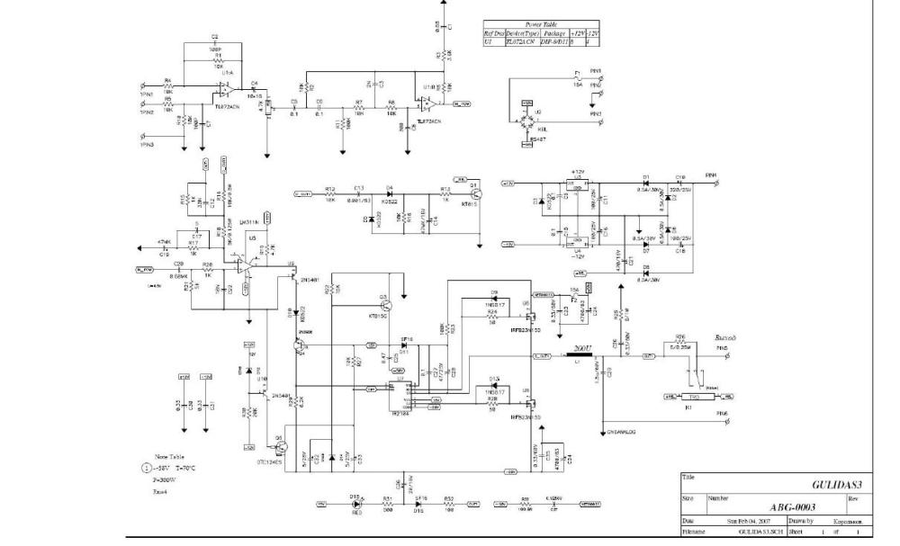

Zox2003,
I know the site you are refering and also I have these shematics. If I am not wrong there should be some another shematics there(in same topic) which is more logical in your case.
Ok make an analysis; the output inductor cut of frequency in your shematic? L=200uH C= 1.5uf R=4ohms. One can easily guess, it is for a sw amplifier. The other shematics(one FB and the other HB) that I am refering have 50uh/0,68nf combination and uses IR2010S drivers. Againg calculate the output filter cutoff frequency. If you are a really RF desing engineer these are really quick calculations for you.
