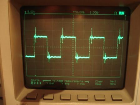

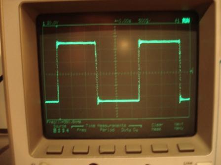

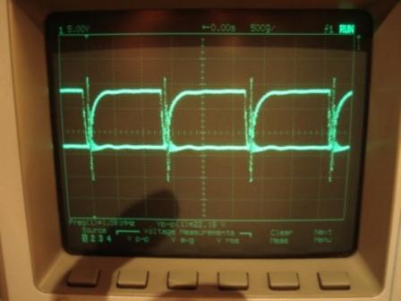

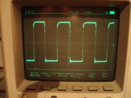

Here are soe pictures:
output
Ouch, you have massive ringing and it's on every oscilloscope measurement, so there is a strong common-mode and radiated component. If this is the no-load no-signal behaviour, then you are likely to have strong cross-conduction.
The ringing characteristic is inherent to the PCB layout and placement of decoupling capacitors, but it should not be excited in such a strong way when the amplifier is idle. You should not have any cross-conduction with IR2010 because it has 30ns of built-in dead time, but this amount of ringing indeed tells that you have. I think something is wrong with gate drive.

BTW: If you do more oscilloscope pictures, try to make them more detailed, like the ones that I posted. The edges are the interesting part of the signals and should be "zoomed", while there is nothing interesting in the flat portions. Showing several signal periods is also of little interest when they are all the same. Also, try to use dual trace mode to show, for example, Vg-s against Vd-s, or input to the IR2010 against Vg-s, etc...
There ia a 4 ohm dummy load on output and no input signal.
Thanks for help EVA.When you said do not put diodes reversed-did you think of not putting diodes at all or "be carrefull do not put them reversed put them right way".
Why gate signals are not looking same?
