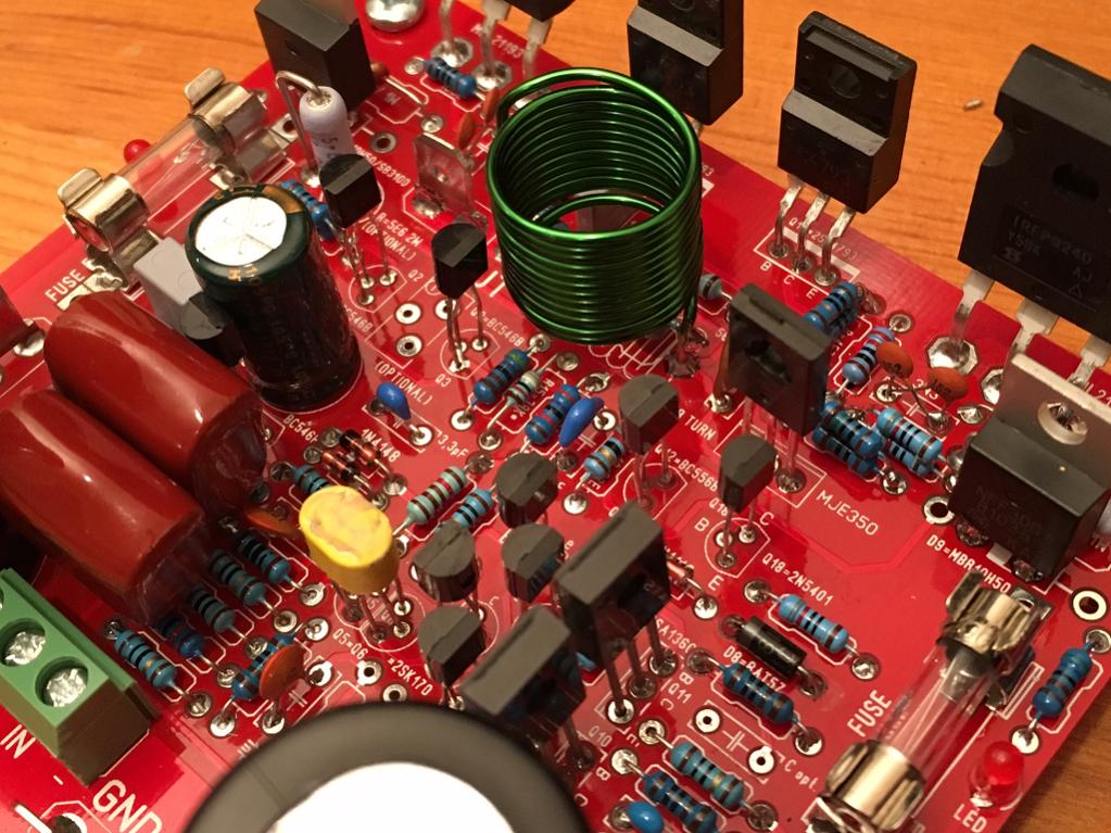

A few pics of my built...

Good job
Karl did one of the first "external" builds without much support and a lack of documentation. He did his homework and he was finished the job without a hassle. Worked flawlessly from the first power-up. :)
One long legged MJL would make the build perfect. You know....
Beautiful build Karl vd Berg! :cheers:
I like the idea of putting both amps on one heatsink. Are you running MOSFET output stage or BJT?
Thank you! :)
I used MJL21193 (fT 4MHz) BJT's here. Actually I'm waiting to put another pair of these without wires and on thicker heatsink.

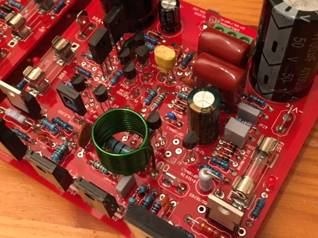

The new PDF files are nicer, and here are 2 pictures where optional component marks are placed for experiments. My boards have resistor R38 5.6 ohm (2W) and C13 of 47nF added, though.

I am using Piersma's BOM wherever possible. Some substitutions occur for resistors that I don't have so I ether use two values in series or parallel to achieve (same or close value). I actually placed an order with DigiKey and should have just gotten everything but failed to order a few items - there is just a lot of different stuff required on this amp. I mis-ordered the 2.7k and got a 27k instead. There is a 530pF and I got 560nF by accident... on and on :)
I did order the Schottky diode on the rails, but had a Schottky small signal one already as the BAT14 was not in stock at Digikey.
Sure, I will try to collect a list of all my substitutions.
In case you are wondering about input caps - those big maroon colored things are CBB MKT 2.2uF 250V. A tight fit for sure - fat fat pins.
Yes, those caps caught my attention, they are of really good quality. But I believe that the first 2.2uF input cap is *optional* for tests like other empty positions, see the C3(2) in brackets. Piersma can confirm it. I also soldered two 2.2uF input caps first, and later had the first cap removed like other resistor and another cap at left.

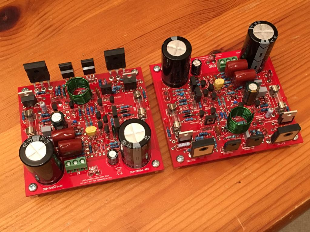

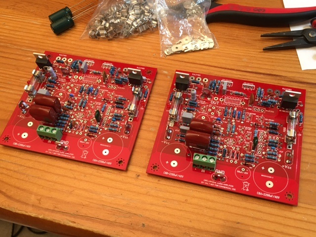

More progress, all transitors and electrolytics now in place. I did not have any 2200uF so put some pretty big 4700uF 63v ones in:)
I will mount to heatsink tomorrow and then test it then. Note that my Circlophone has the IRFP9240 hexFETs for the outputs.

I think I counted 9 different kinds of transistors on this amp!

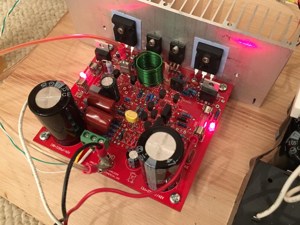

MOSFET Circlophone #1 is ALIVE. It fired right up no issues :)
I am getting 180mA quiescent bias current through the 0.56R resistor. Singing now - sounds fine. Running on 35v rails at present.
Edit: the DC offset is a bit high at 80mV - although I did not bother to match the 2SK170's - would that be the culprit?
