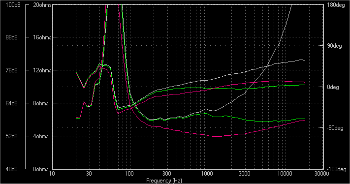

Just a quick general question, when tweaking the woofers crossover by increasing the capacitor value (in the impedence compensation network) will this have a negative effect on overall system impedence? ie: lowering it too much. I would like to ideally maintain roughly 6-8 ohms impedence overall. (woofer is rated 8 ohm)
Reason I ask is, this works really well with one of the systems I'm tweaking at the moment. But I had to increase the capacitor from 10uF to approx 22uF. Being a bit concerned, I then increased the resistor value from 6.8 ohm to 8.2 ohm thinking it will sort of counteract it without changing the sound too much. It sort of worked. (I think) Am I being too cautious?
I realise this is a very general question, but I'm just trying to get a grip on how the theory works.

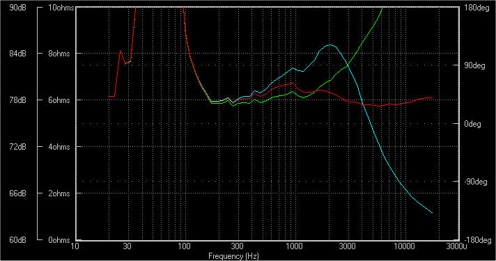

This is a good question, and I thought it would help if I showed an example. I used an example similar to the tutorial with a 6.8Ω resistor, an 8.2µF capacitor, which I then increased to 40µF which seemed extreme enough to prove a point. In all cases the grey traces are the raw driver, green is the normal case, and magenta is the extreme case.
The first image shows the effect of the impedance compensation on the driver. There are six traces, the lower three are the impedance curves that are normally shown, and the upper three are the impedance phase (which is not the same as acoustic phase). Although technically both work together, it is sometimes easier to just look at the normal impedance curve, but with regards to phase, just look at whether it is close to zero degrees or far from it meaning for example is it an easy 8 ohms to drive, or a not so easy 8 ohms to drive? If that helps.
So, the impedance drops to 4 ohms around 1kHz with the large value of capacitor, and as the phase is near zero degrees for that case, it will act similarly to a simple 4 ohm resistor, a load that most amps will handle.
The second image shows the impedance once the 1mH inductor is added. This is the impedance that matters because it is what the amp will see. By adding the inductor, the effect of using the larger capacitor is partially hidden from the amp... the impedance is well on the rise at 1kHz and upward.
The lowest impedance here is around 5 ohms. If you look at around 600Hz, the phase is a little further from 0 degrees although still less than 90 degrees. You could take a non-technical guess that this makes it equivalent to maybe a 4 ohm load at that point.
Summarising the effect of the larger capacitor (looking at the first plot), there is little difference at the highest frequencies because all capacitors act like a short circuit at high frequencies. The effect is to act on the impedance at a lower point than before, encroaching on the lower midrange as the capacitor grows in value.
I've also shown the frequency response on the second plot (the upper two traces) for interests sake. The end result it is showing in this case, is that the greatest effect of that inductor will be above 1kHz, and the large capacitor is producing an effect both above and below 1kHz. The impedance reduction below 1kHz may be an unwanted side effect, but if it gets you the result you want then it is valid, and in this case relatively harmless.

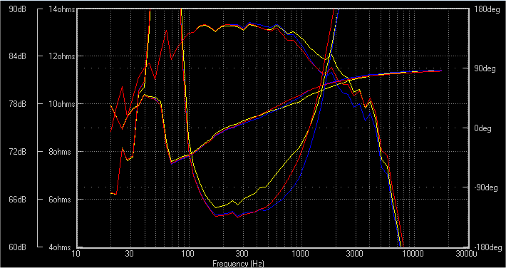

One last thing. Will increasing the resistor value from 6.8 to about 12 ohms sort of help bring it back up a bit? I'm guessing it will, but will that have any other side effects?
I've already done this as a trial and it doesn't seem to have made as much of an audible difference as increasing the capacitor did (which is good) so I've left the 12ohm in there for now.

By and large, increasing the resistor will compensate like you say... but there is a catch. Impedance is complex (literally meaning it has a phase component). Generally speaking, if you overlook this you'll be OK most of the time but I thought I'd stretch the point, starting with your stated values.
If you look at the first sim attached below, yellow is 6.8Ω / 8.2µF, blue is 6.8Ω / 22µF, and red is 12Ω / 22µF (I've also changed the scales). My example will not be the same as yours but it should give a good idea of what can happen.
Both 22µF cases have a more similar frequency response than the other so that may explain why they sound more similar. The impedance is also generally more high for the 12Ω / 22µF case but this case in fact shows the lowest point of any of them.
Taking it to an extreme with the second plot, I took 6.8Ω / 8.2µF, and changed the resistor to 25Ω, and to zero. If you look at the highest frequencies they are in order of the size of the resistors, but in the mid band, the higher the resistor, the lower the impedance.
