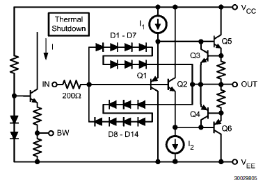

Ah, but the buffer is not an opamp. It is simply highly-matched and thermally coupled output stage transistors in a single package (see image from the datasheet attached).
The other point of the buffer is to reduce the load on the earlier stage and reduce the output impedance of the circuit.
Gosh, I should have taken the time to open the datasheet ! Thanks for replying Brian!
Actually when I saw the distortion figures I was convinced that it was an IC with 1000 transistors and heavy internal feeback loops...
Now, even if the interest of my question decreases with this new info...
just for the beauty of my understanding... if I'm just feeding a pre-amp that happens to use another buffer (namely , a B1 buffer by Nelson Pass) and still want to bypass the LME49600 Buffer (I know I'm getting heavy ) do I still need as much NFB in the Ventus (or even can I totally get away without NFB ?)
As always thanks for your replies!
Fred
