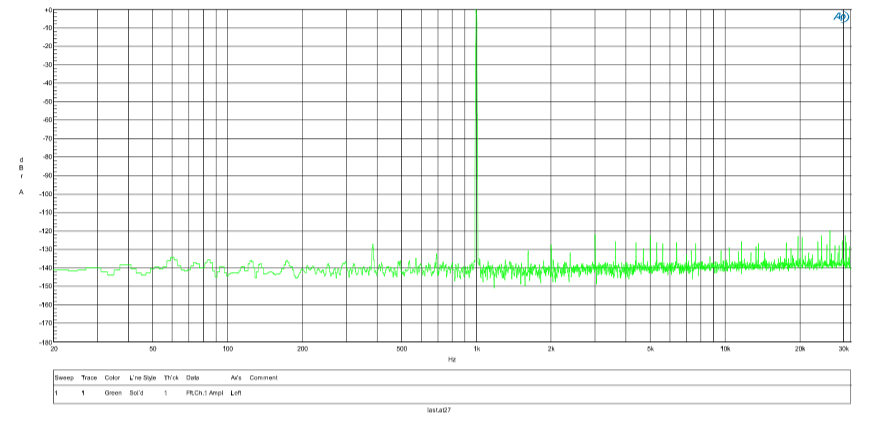

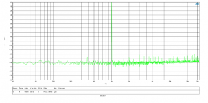

I don't have access to an AP (they cost about $30K) - but ESS measured the IVY circuit + ES9018(B32 in this case) for us. B-II,III etc are all using the same DAC (ES9018).
-117db THD+N and ~129db DNR(stereo)
That output stage was identical in function to the IVY-III. Mercury is also very similar.
I have measured (on PC using sound cards) all of my modules - but those measurements are limited by the capability of the sound card ADC etc. I don't consider them very accurate - just a sanity check.
Also note that for any balanced output DAC you need a fully differential ADC on the test instrument in order to measure it accurately. The balanced output will always be superior to the SE output - but measuring differential signals by the difference of 2 SE channels is not ideal - because single ended each channel will have its own errors. That's why I would love to have an AP. If anyone wants to donate one let me know. :)
