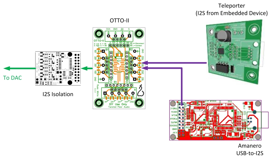

I'm setting my source up to be able to switch between a USB-to-I2S device (Amanero) and an embedded player (e.g. BBB). The latter will reside in a separate box with its I2S output "teleported" (TM 😛) to the D/A.
Parts are ordered and I'm now trying to choose between the attached layouts.
Will the Teleporter offer adequate isolation (Option A), or should I play it safe and isolate at the OTTO's output (Option B)? 😉

I assume you have another Teleporter near the OTTO for receiving...
If you want isolation, it seems to make sense to use layout 2.
Actually, the one pictured is supposed to be the receiving Teleporter. 😀
All boards depicted in the graphs above are going to be part of the D/A box.
The BBB (or a similar device) will reside in a separate enclosure (with a transmitting Teleporter); not shown here.
I was just wondering if the LVDS transmission (with no grounds connected between the transmitting and receiving box, i.e. no shielded cable or anything) would offer enough of an isolation. 🙂
Yes! It indeed should give you all the isolation you need. If you find you need to connect the grounds (too much potential between them) then you can always add in the isolator, and if you do the right place would be after the OTTO and just prior to the DAC.
