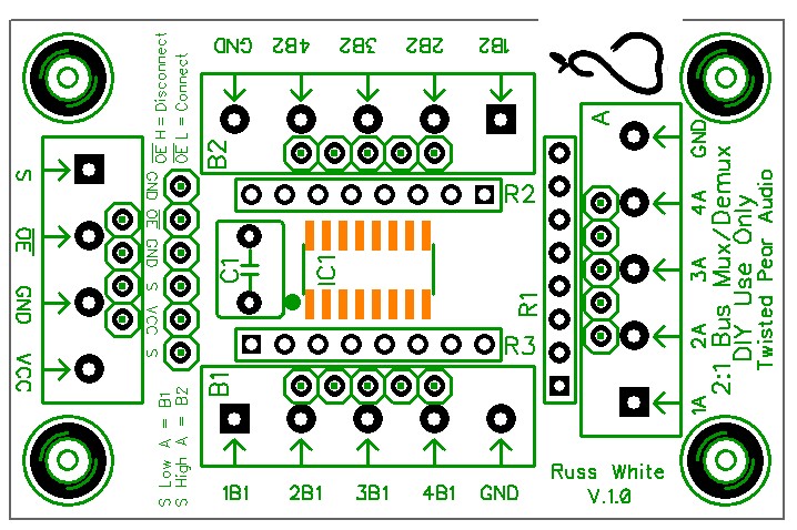

Introducing OTTO2
I think a picture is worth a thousand words.
I will just say it works beautifully - and I have tested it with signals up to 100Mhz master clocks. :)
We have a small qty available very soon, and more to come thereafter.
This cct can be used to switch between DSD sources and PCM or between two PCM sources etc.
The concept is simple. You have a common four channels(A) and two sets of 4 switched channels(B1 and B2). The set that is selected is dependent on the state of the "S" input. The OE(bar) input must be low (jumper to GND) for the output to be enabled.
Pretty easy.
The MUX works with a VCC input of 3.3V to 7V(max) I recommend 5-5.5V the signals that are used should be equal to or less than VCC.
