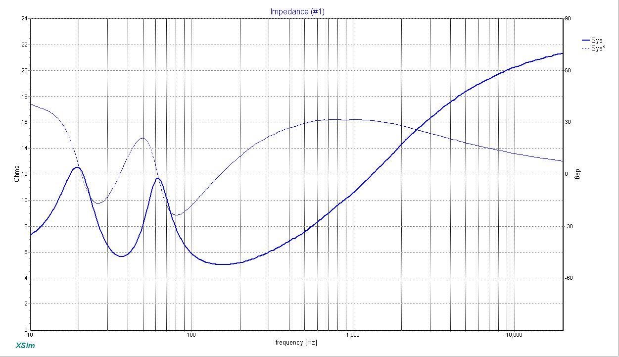

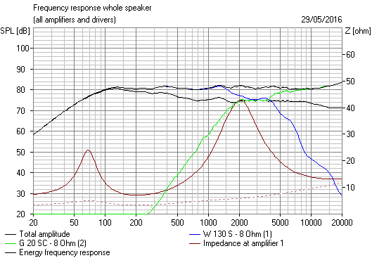

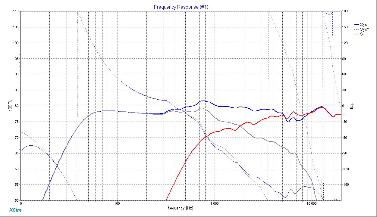

Can you please elaborate on the middle plot you posted? There is a 23dB dip in the FR at about 1800Hz.
The middle plot represents FR of the loudspeaker when the drivers are
connected in phase in relation to each other. DIYers often like to see
how things look when you invert one of the drivers and if there is a rather
deep null at XO frequency then it means that driver phase response
in this region is reasonably good aligned which shoud mean that it would
also sound ok. That doesn't mean it would not sound well if driver phase
were more apart.
In general, the simulation is based on manufacturer 2 pi data, simulated
on a baffle of yours, the same tuning and box volume. Considering so a
few parts, the performance is pretty good.

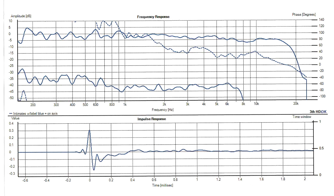

Ahah! I rummaged thru my original Intimates project file with hard copies I retained and found the 'smoking gun, so to speak. It shows FR top solid line, acoustic phase, dotted line and 3rd HD bottom line about 40dB down from the fundamental (~1%) in the tweeter's passband, perfectly acceptable for loudspeaker application. Since HOM defaults to a 0dB level, I don't recall the exact dB level used for the test but suspect it was in the range of 90dB.

Tremendous outbreak of courtesy there, Carl, especially since I have been critical sometimes. Well done. But just because Sonus Faber do it doesn't mean we can't engage some thought. :D
TBH, I haven't modelled a better crossover for a 5" bass and 1" tweeter than yours. 6dB per octave or thereabouts seems to work well. A 5" is almost a fullranger and seems to play nicely with a simple bass coil. If we push the crossover fairly high to 3kHz, all doubts about the IM distortion evaporate.
I did model this one time-aligned, which is not a biggie, but TBH a parallel crossover worked best. The series filter turned into a mess.

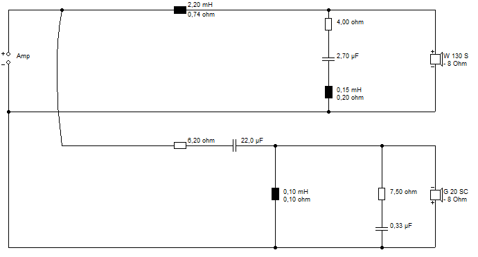

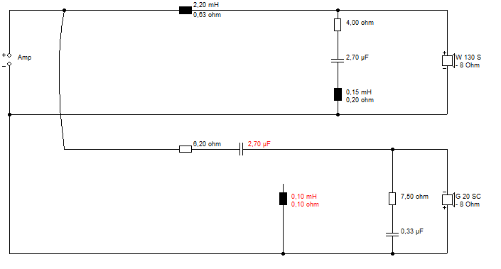

I found that a very low resistance 0.1mH shunt tweeter coil mapped to a 2.7uF series capacitor almost exactly, albeit with wildly different impedance.
chris737 is in a nice place, IMO. I did think some further crossover work might help the basic circuit. 8Khz bass notch, for instance. A zobel on the tweeter for the high frequency impedance flatness which amps like. And maybe a 22uF to cut out the bass leaking to the tweeter and keep the resistors cool. All worth trying IMO.

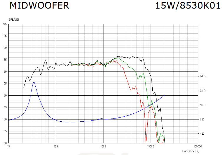

Aaahh, Steve you just can't resist throwing up some more sims, even if they aren't really relevant to the topic at hand. Mixing an image of a published SS bass/mid FR with a model and XO's for other drivers (Mordant Short)? is that really helpful or just self serving?

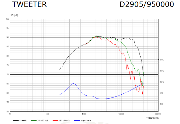

I was looking at the Scanspeak D2905/9500 tweeter today. It's one Lynn Olson knows well:

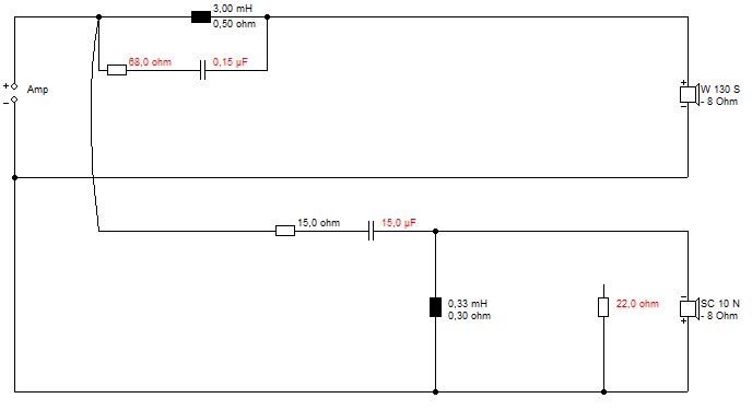

Lojzek's sim of Chris' speaker is interesting. It's a bassy speaker with that 3mH.
I see a high Q tweeter Fs issue at about 700Hz. I see a bit of breakup and a phase problem at 7kHz. Because the woofer is only 10dB down at that point. And the hot-running 15R resistor.
Most of that gets fixed in the circuit below. The 7-8kHz tank notch seems to work better than an LCR or a bass zobel here.
The 15uF doesn't affect FR much, but makes the circuit far less dependant on a high quality coil and avoids the heat issue.
The 22R is something I want to help the tweeter Fs and improve the HF impedance to the amplifier, but it will drop tweeter level 2dB unless you change the 15R to a 12R. I'd have to hear the speaker to know what is easiest. :)
IMO, all this is just applying general principles. We actually don't need to know much about the 5" and 1" drivers as long as they are flattish. :cool:

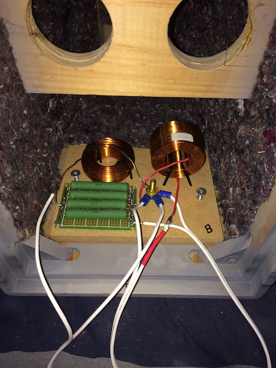

Re the resisitor(s)- I ran my 50W amp at full volume with a 6kHz input for about 10 minutes (I picked 6kHz for no other reason than it was the least painful sound to my wife's ears).
The 3 resistors peaked at 42 degrees C on my temp probe. They were just warm to the touch. A bigger amp would obviously heat them more, but I can't see them getting anywhere near their rated temperature. I believe the original Extrema crossover had a 50W resistor?
I don't recall the wattage on the Extrema resistor, but they sure had a humungus heat sink on the back side to help keep it cool.
