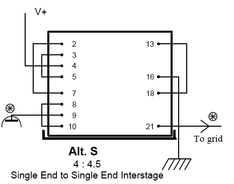

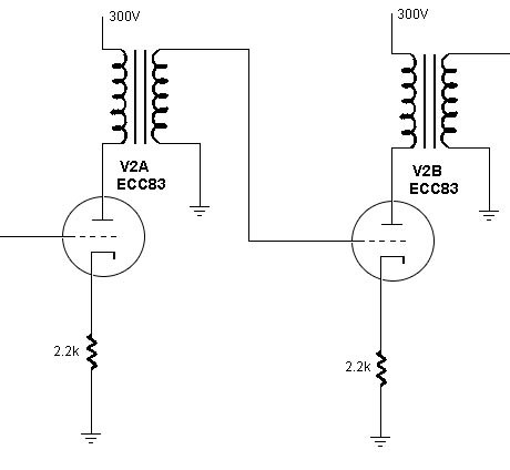

For low frequency the inductance of the transformer is important, but for high frequency also capacitances in the transformer are very important. The ideal choke or interstage transformer is not just a coil with a certain amount of windings but should be wound with the duty in mind. A good quality interstage transformer should be wound in isolated layers.
In a typical application of an interstage, or driver transformer for a P-P amplifier the primary is a single winding plate load to the drive tube and the secondary is bifilar, with the center tap going to the output tube negative bias supply. The secondary ends couple directly to the output tube grids. Other than the grid-stoppers, NO resistors are required. The driver tranny is actually usually a trifilar winding; having a 1:1:1 ratio. Jack at Electra-Print offers a bifilar winding that may be used as a phase splitter; the simpler winding offers better phase and frequency characteristics; the application is similar to the choke driven SE amp.
