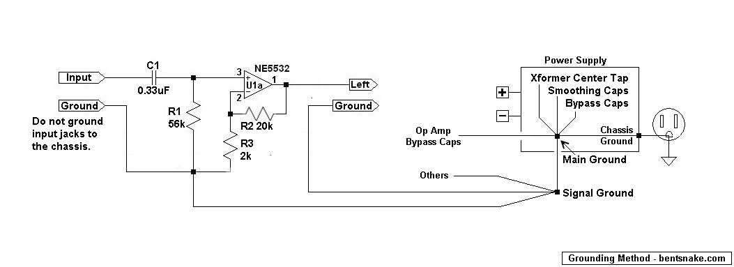

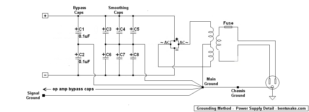

This is my understanding of the grounding method recommended by Douglas Self, the engineering department at Texas International, and others. If I've misinterpreted anybody I'd be very glad to be corrected by them.
This method is not as complicated as it might at first appear because most of the connections are at the power supply, where the transformer, smoothing capacitors, and bypass capacitors are already close together. The only component exterior to the power supply is the bypass capacitor(s) at the op amp pins.
PROBLEM: Distortion of the audio signal by much larger voltages, currents, random noise, and waveforms local to the power supply.
"Ground" is zero volts in theory only. In reality all conductors and connections have resistance, so the audio signal can be distorted according to E = IR.
SOLUTION: Keep audio signals out of the power supply loop as much as possible.
Current flow is always in a closed loop from and to the power source (the transformer), but there can be, and usually are, a great many of these closed loops, each with its own individual characteristics.
In this case the power supply itself is one closed loop, and each individual op amp is another. Of course a circuit could be infinitely divided into sub-closed-loops, but just keeping the audio signal loop away from the power supply loop is enough for this purpose.
Wiring connections are as shown in the schematic. Notice that the transformer, smoothing capacitor, and bypass capacitor grounds are all individual wires running the to the Main Ground point. There's no interconnection until the Main Ground point is reached.
The very simple concept is that audio signal ground returns must, like all currents, return to the transformer, but this return is made at the very last minute. thus minimizing interaction among loops.
Obviously "at the last minute," and "minimizing" are compromises, but then, all circuits are compromises.
NOTE: Here bypass capacitors are considered the same as decoupling capacitors. This is wrong in engineering terms, but popular usage confuses the two so what the heck. Besides, bypass is a shorter word so it fits better.

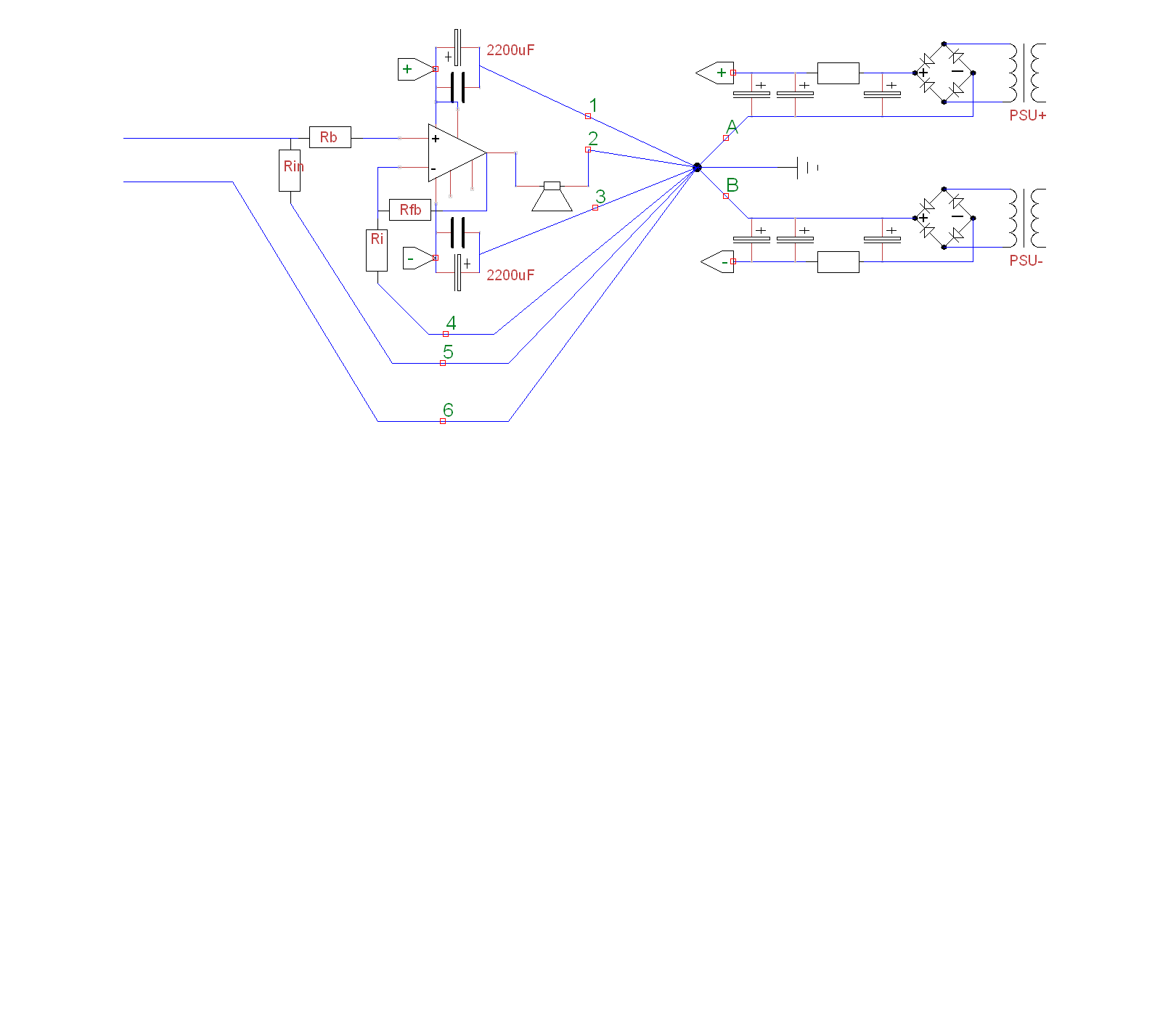

I think this is close to what Pjotter has build. I left out the RC to GND.
Yup, this is pretty much what i've done.
If that is what Pj has assembled, then I don't agree with much of what has been implemented.
It basically breaks the "rule" to keep Loop Areas of each circuit as small as possible.
eg.
look at the input circuit.
Signal Hot comes in from Input Socket, passes the Rin tapping, through Rb to +In. A fairly simple route.
Signal Return comes in from the Input Socket, goes to MAG, comes back from MAG to go through Rin into the Hot route.
That is a long route that is not necessary and includes lots of loop area and worse because of the LONG wire lengths must have high inductance.
That inductance will have a different impedance from the short Hot route. Is that more interference?
Local decoupling has long routes.
NFB tapping has a long route.

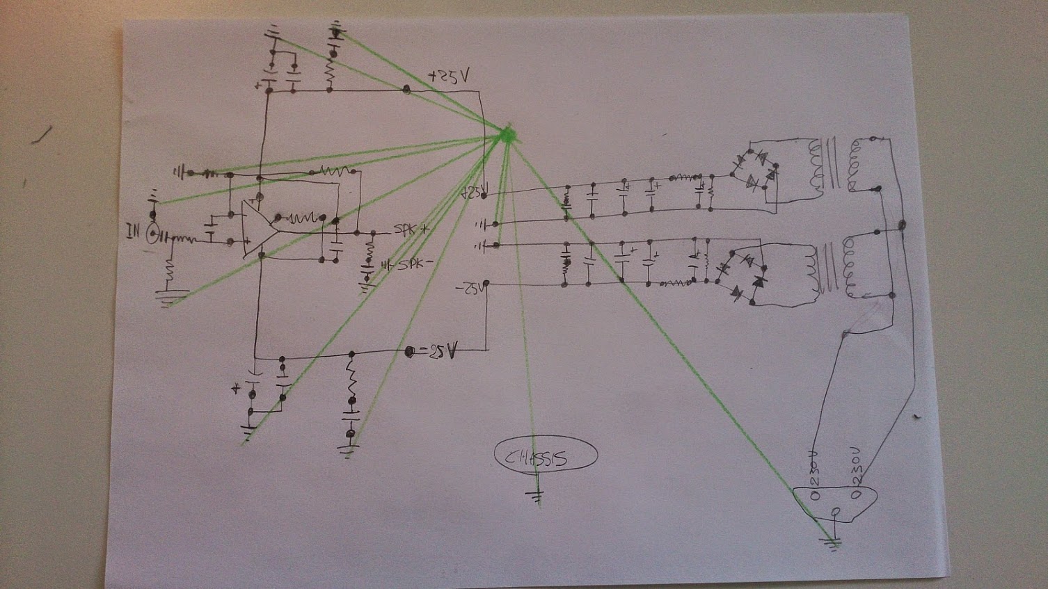

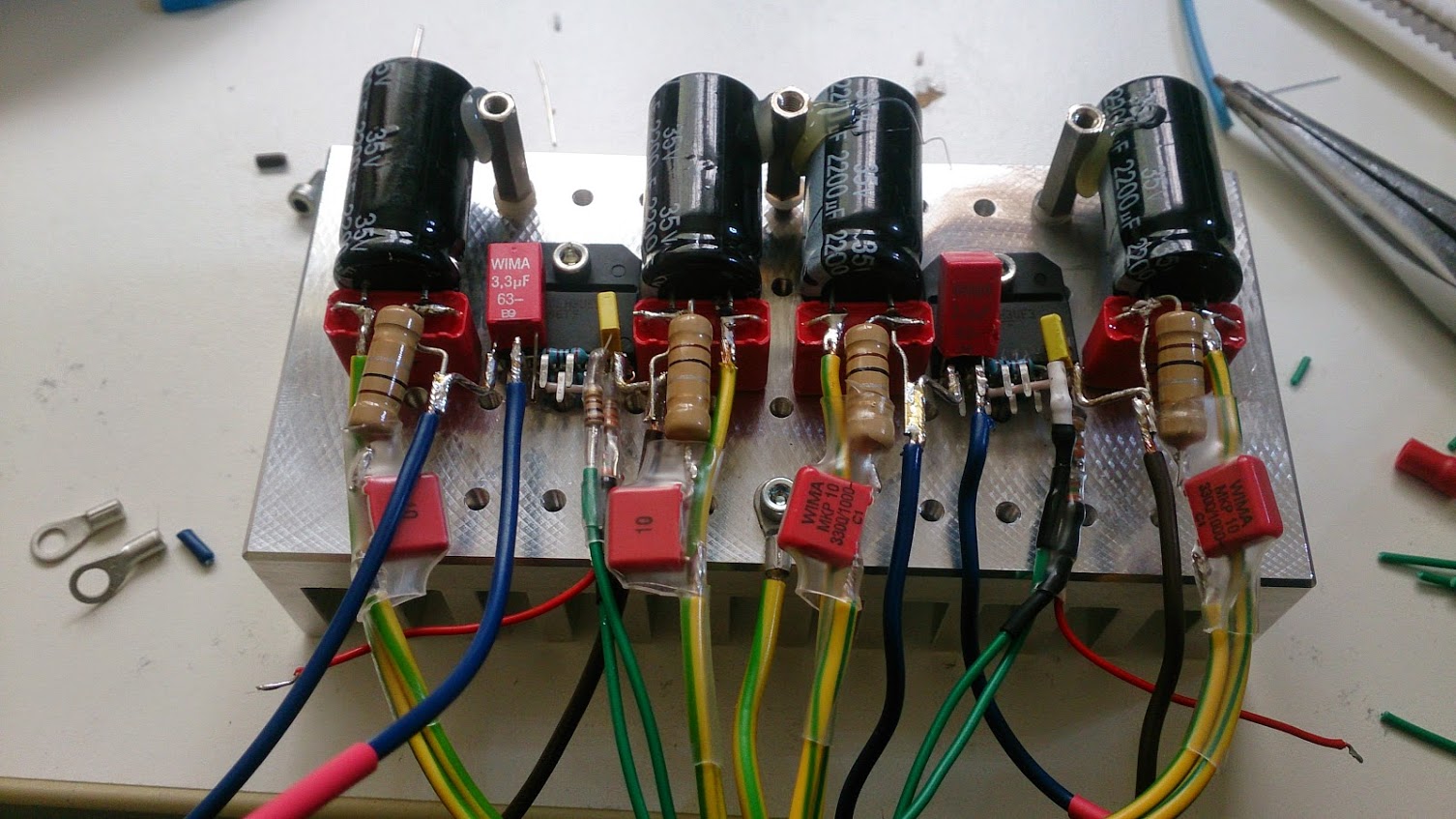

Great, thanks for the input. It really helps me making something that i couldn't have done all by myself.
I've included a schematic I've drawn, it's basically how everything is connected right now.
However i didn't included the "pre amp" stage in this schematic.
Perhaps i should have done that, if necessary i can do this.
Pjotter, whoa, nice looking work! Not to mention interesting use of hardware.
Sorry, but I have to say a word about hot glue. It works at around 300 degrees F, which is way hotter than the design specs of most components.

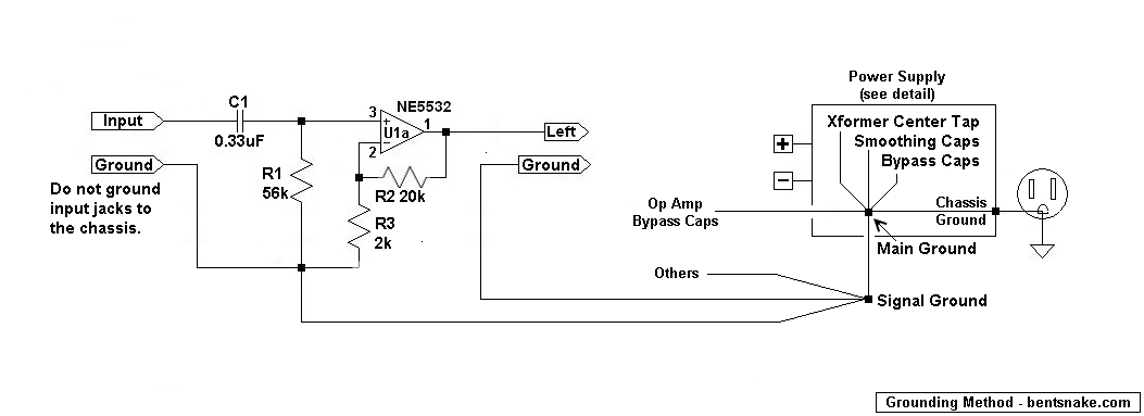

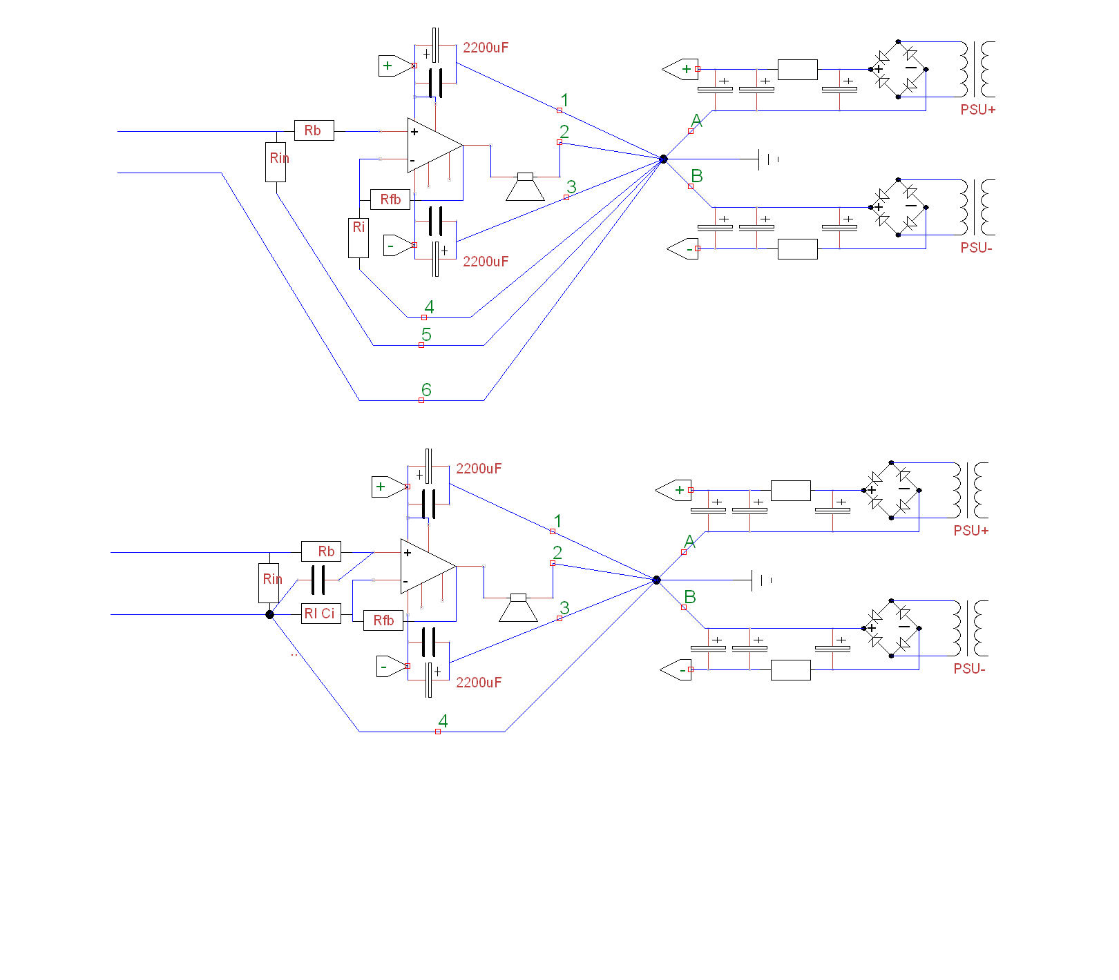

Meanwhile, I might as well finish the thought from post #21. The first circuit posted below is essentially the same as in post #21, re-posted just for convenience. The second circuit is a detail of the power supply connections.
The second circuit is simpler that it might seem just at a glance. Internal to the power supply there is:
1. A jumper from the ground side of the bypass capacitors to the transformer center tap, and:
2. A jumper from the ground side of the smoothing capacitors, also to the transformer center tap.
Otherwise things are not much different. The "signal ground" is the same zero-volt ground you expect to see on a power supply.
All of which commits pretty serious violence upon the rule of "One circuit, one ground, always and only." I'd actually much rather refer to a signal common, and a chassis common, therefore calling the Main Ground simply ground. But it appears popular usage decides otherwise, and I know what to do when I'm outnumbered (run).
As before, this is my understanding of the references cited (many times checked). If I've misinterpreted or misunderstood anybody I'd be very happy to be corrected by them.
