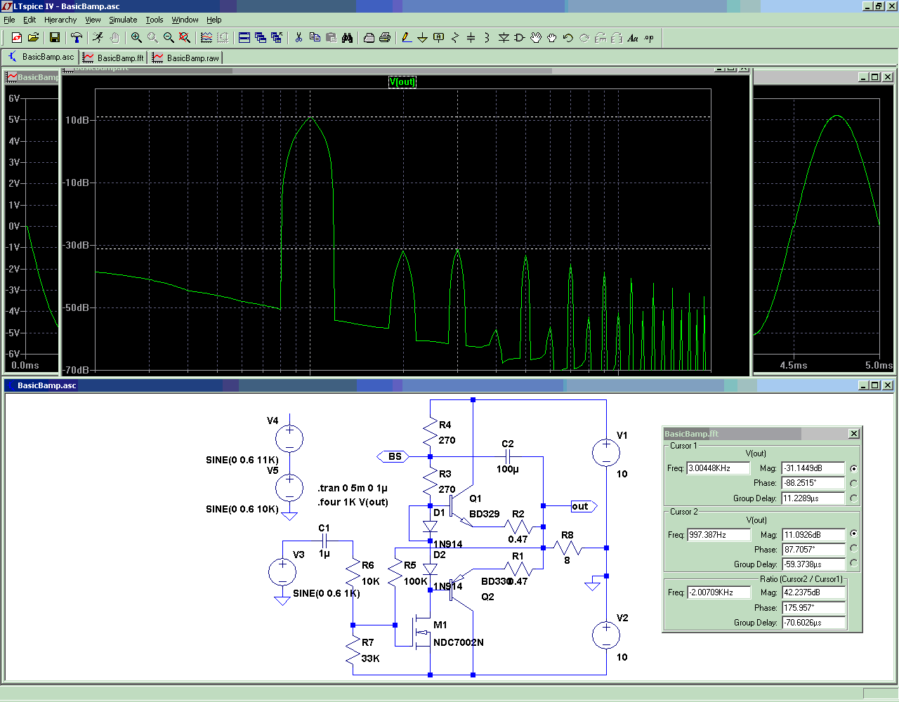

Generally speaking, IMD will give more information about a system, because higher order products will not necessarily result in DC or duplicate components.
But, when the performance of an amplifier or system is characterized by a single figure, the THD figure is much more relevant than the value of a single IMD product, because it encompasses all of the higher products.
This is clearly shown in the previous simulations.
It is extremely difficult to find realistic examples where the IMD figure is much higher than the THD figure.
jcx gave an example, but it is pretty unrealistic, it is just (cleverly) hand crafted to support his argument.
By contrast the example I gave is based on normal amplifier circuits, and shows the effects of typical distorsion mechanisms.

High oder nonlinearities produce increasingly more IMD. The combinations of intermodulation rise fast with the number of input tones and the order of nonlinearity. Just a moderately high order nonlinearity with a moderate number of input tones can produce tremendously more IM products than harmonics. A single-tone pure sine wave test does not excite much nonlinearity and is very far from the harsh reality (actually worthless).

Not true. A full amplitude sine wave will exercise most sources of non-linearity. The main exception is the re-entrant distortion caused by poor decoupling which I mentioned in an earlier post. Two sine waves at similar frequencies will excite that one. IM may be easier to measure than harmonics, and it may sound worse, but it is essentially just another manifestation of the same non-linearity.

There is a simple relationship between the level of harmonic distortion and IM distortion. Other things being equal, they would be at exactly the same level, as they are usually generated by the same mechanisms. Other things are not always equal, as I have said, hence they can vary from each other. The number of distortion products, but not their level, obviously relates to the number of distinct elements in the input signal (which is perhaps what you mean by "signal complexity"). IM distortion is not chiefly determined by high frequency performance, as IM can occur at any frequency. I am repeating myself, so there seems little point in continuing this discussion. Please read a good book on trigonometry, then you will begin to understand amplifier distortion.

It goes like this. The non-linearity at 19/20 kHz causes an error that has a 2nd order (f2-f1) product at 1 kHz. The amplifier's loop gain at 1 kHz corrects this error. What's more this distortion is of the same order as a 2nd harmonic. If the amplifier has low 2nd order harmonics (a bridged amplifier, for instance), but high 3rd harmonic then THD will be higher than the CCIF-2 IM measurement.
