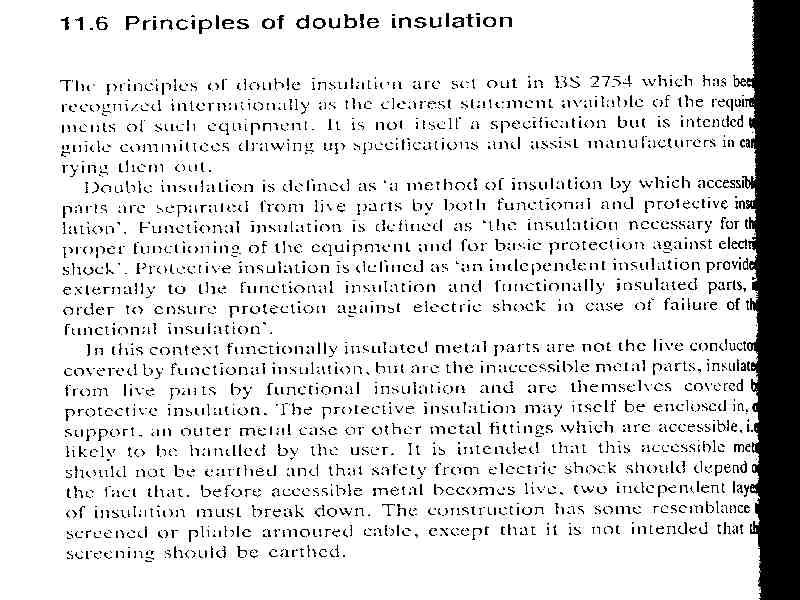

I don't have the time to type it, so i scanned (from "Electrical Safety Engineering" third edition W. Fordham Cooper, Butterworth Heinemann) the definition of "double insulation". As you will see, most of the equipments, don't fulfill all these criteria. Imagine what happens with the EMC regulation. (for this, read Ivor Catt in E.W.)
Regards
George
