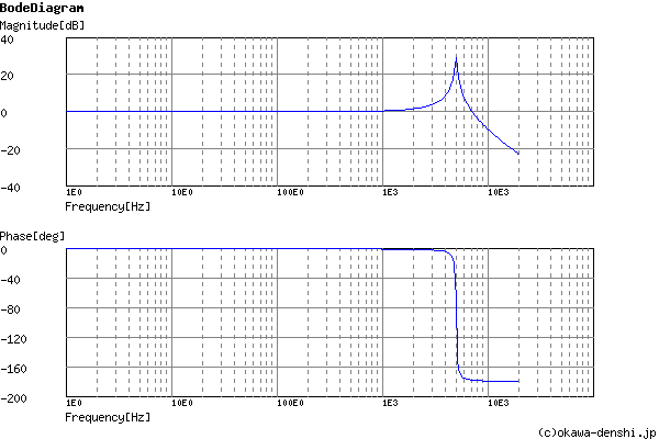

With reactive components you can get resonant voltages or currents exceeding the input (by large factors), and similarly at resonance the impedance can go to very high or very low (which is the point here about noise spectra having peaks with particular mains filter). So the output noise amplitude (voltage or current) can be larger than the input noise amplitude with these reactive networks. Sure the noise power isn't amplified, but that's not what we care about if the noise voltage is what gets into our voltage amplifier input...

A resonant filter obtains energy from the input excitation and a part (depending on the Q-factor) of this energy gets focussed at the resonant frequency, which is how the gain happens.
For an input filter like the following, when L = 1mH, C = 1uF and R = 1 ohm, the response has a 30dB gain at 5kHz (below).
