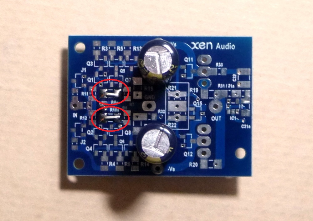

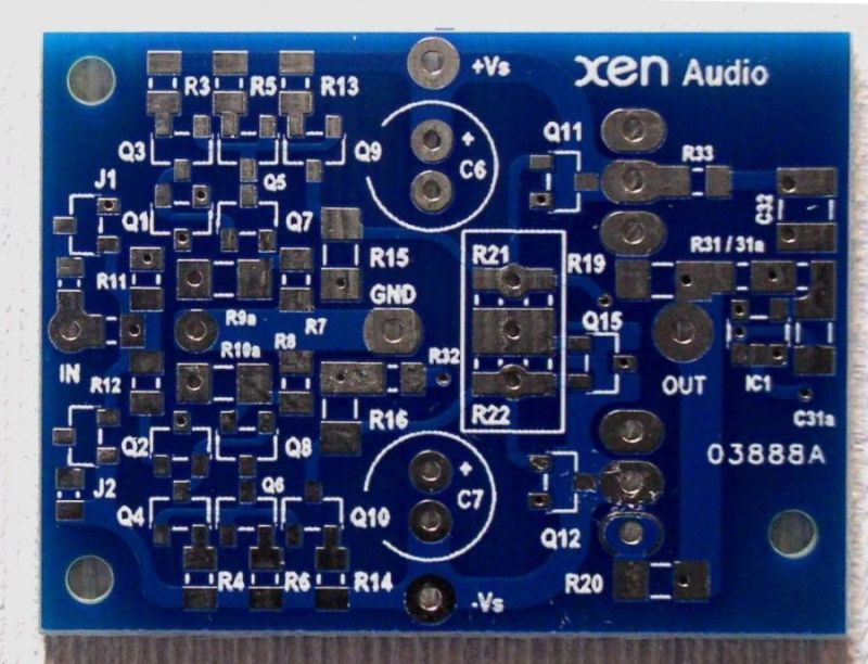

The PCBs arrived.
But this supplier (which we have used for years) recently moved factory and "upgraded" his production equipment.
The result is a small (software?) bug in converting the Gerber files to the solder resist layer.
See who can spot the defect.
This is of course not acceptable to us.
To avoid any risk of the same thing repeating itself, we shall now use another known supplier and remake all boards, at our cost.
Projected shipment date is still last week of November, as promised before.
Shall keep you updated.
Patrick

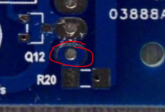

> Those holes look like vias.
Some are vias, some have special functions, as you will know later.
Not in the wrong spot but deliberately placed.
It is easy to fill those holes with solder while you solder the SMD components. Have use them many times before.
Actually simplifies layout, though not used by others or by industrial software.
> how about this ?
Spot on. Plus some others on the bottom side.
So have to make new even though one can still use all the boards with a bit of resist scrapping.

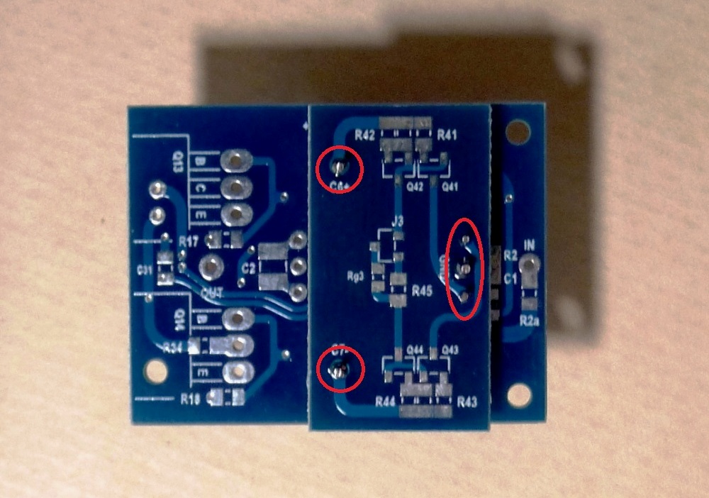

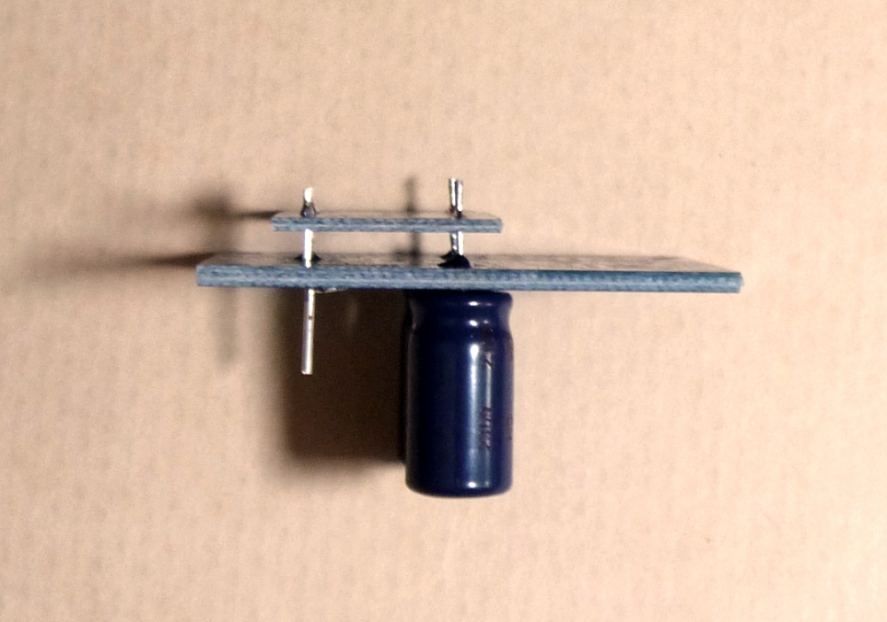

Here info upfront as to how the CCS bias daughter board should be assembled.
There are 5 connections in total :
C6+, C7- extended legs (min 5mm below main board)
Front Gnd wire (0.8mm silver plated copper)
R9a, R10a shorting wire connected to CCS board (0.6mm silver plated copper)
If in doubt please ask first.
Patrick
