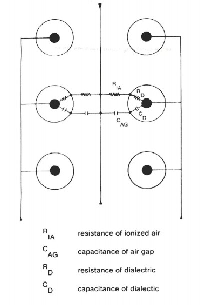

Insulated vs. bare metal stators
nylon 66 is the one you are after...
you chould be able to find it in powder coating as well as liquid form. The real clai to fame in the ESL field for nylon 66 is that it has the least amount of creap away from sharp edges of just about any of the useful coatings. This means that you achieve the highest built of coating at the edges where corona will also be the highest and os the best dielectric by default. I matters little if you use a stronger dielectric material if you cannot achieve sufficient build at the edges. This is a primary issue with perforated stators rather than with wire stators.
Thanks for the responses guys. Moray: My nylon inquiries were made in the context of magnet wire so I won't need to worry about powder coating performance etc. Thanks, Calvin, for the reassurance; the relative similarity between the resistivity and dielectric constants of pvc and nylon were what I had mind when I suggested that readily available nylon coated magnet wire might be a reasonable substitute for pvc coated hook-up wire. I'm still a little concerned about the hygroscopic nature of nylon, since I really want to get away from performance that varies with the weather, but perhaps it's not as big an issue as humidity dependent diaphragm coatings. Anyone have any thoughts on that? And then there's the other issue of finding an adhesive to hold the nylon onto my crossbraces, which at the moment I'm intending to make out of black garolite XX (paper-based phenolic).
Henkel Loctite 444 should do a good job bonding the nylon to garolite. You can contact the applications engineer for Henkel loctite in your area and he will send you a sample along with the Prism primer. Put the 444 on the garolite and the primer on your wires, then place together until set.
