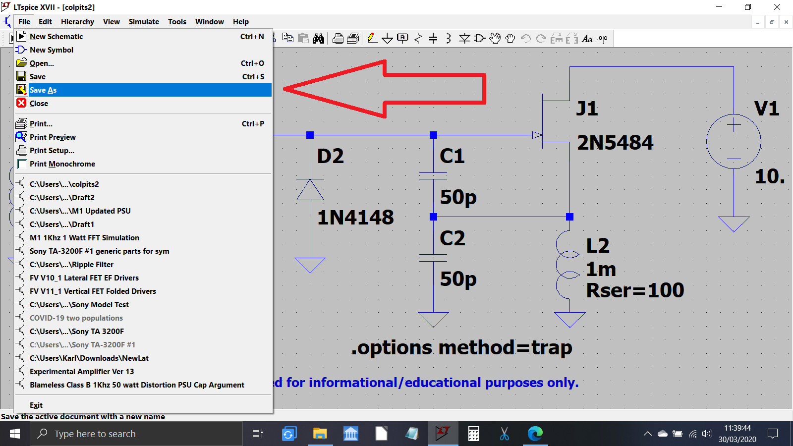

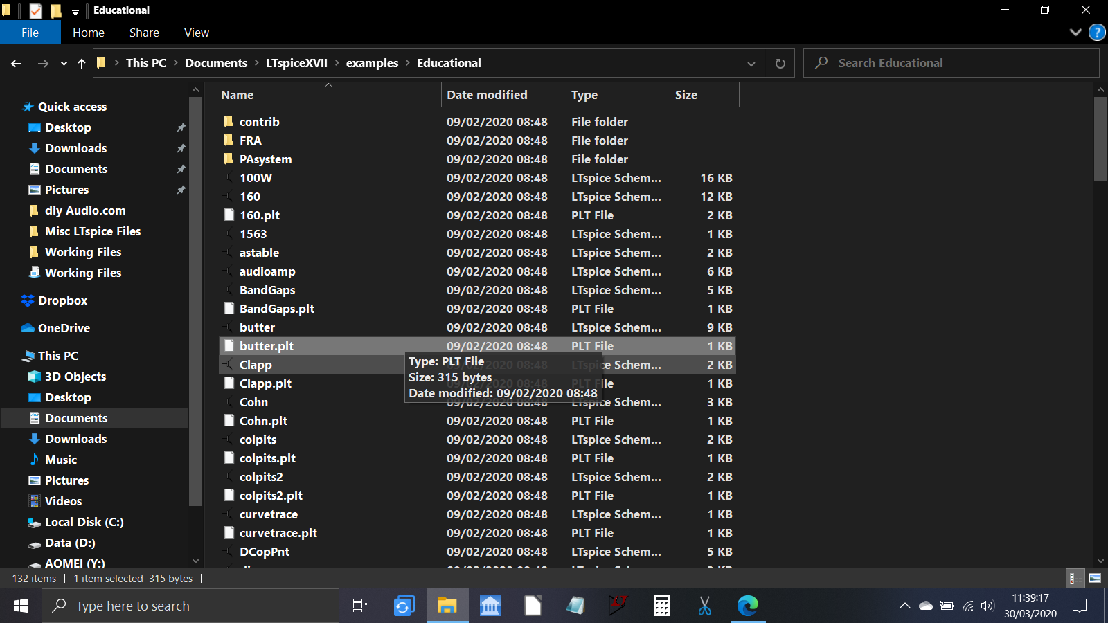

If you do try an example then I would suggest the first thing you do after opening it is to rename it and save it somewhere else. That keeps the originals intact and then you can play around as much as you want with the resaved version.

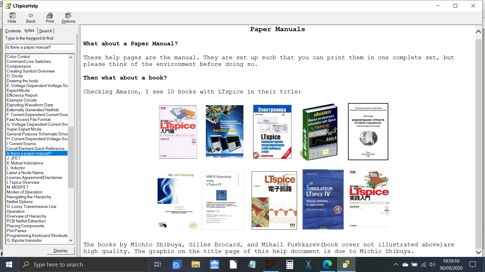

Don't forget there is a kind of instruction book within LT but its a bit hard going tbh at times. Just select 'Help' on the top line and then 'Help Topics'.

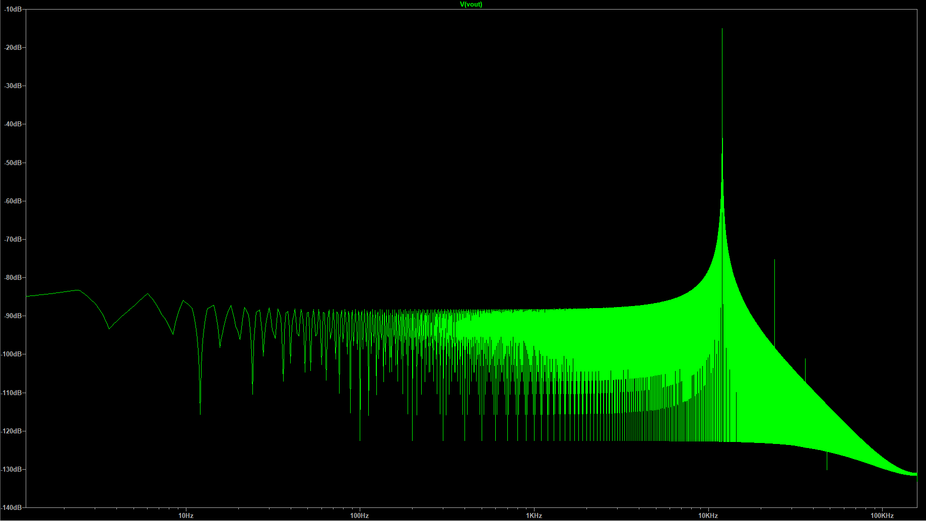

12 KHz FFT
I think I've mastered the the technique of performing a FFT. To get it to work properly needs great care, as it is far too easy to mess up the calculations. The calculator and a notepad and pen are quite useful for me. I did this one at 12 KHz, extrapolating the settings used for 4KHz on page 2 in the tutorial. I left the two capacitors' value at 1μF. I wonder does the result make any sense. It took 30 minutes on a reasonably fast machine to compute.
