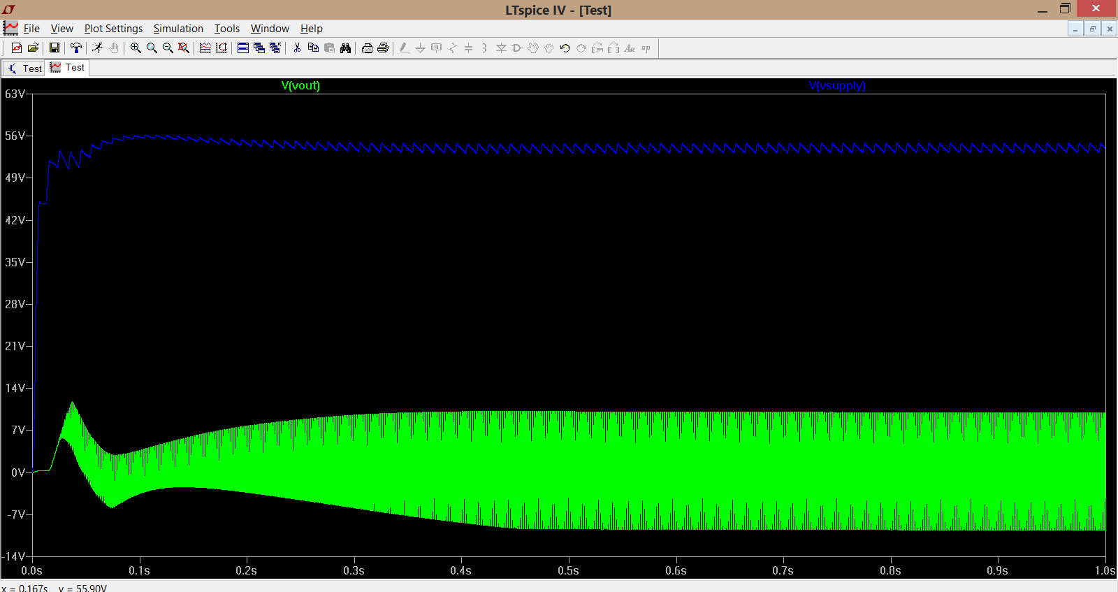

Sims on AC coupled amps need quite a while to run and settle. That's one issue. I've altered your sim as I've gone along to give you some ideas. Diode bridge... models. I picked MURS320. Had you left those at default ?
Your using some pretty advanced directives for the sim (no problem with that) but I find the long hand easier to follow and so I altered them here.

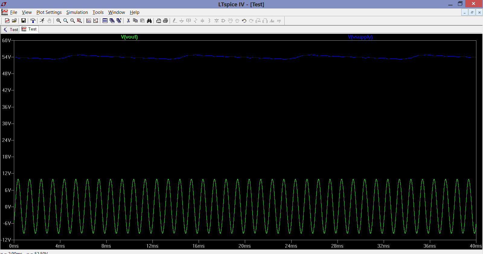

Let the sim run for 1000ms (should complete in a minute or so) and you can see how the amp settles. Now run the sim with an stop time of 1000ms and a start time of say 960ms so that you get just the last 40ms displaying.

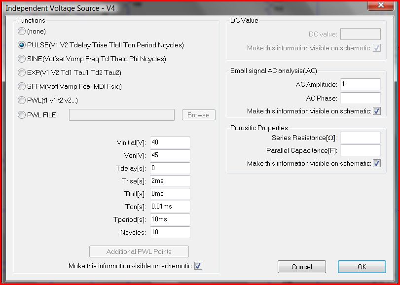

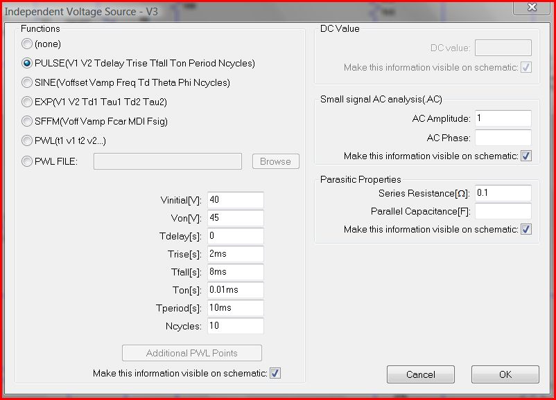

For simulating rails I sometimes set them up as separate AC voltage sources rather than using the full diode + caps circuit. The pictures show typical settings for a split supply.
