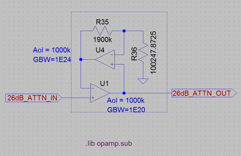

Ever have a need for a near perfect attenuator in LTSpice?
I wanted to cut down the output of an amp by 26dB so that the AC analysis and FFT plots would be referenced to 0dB. I originally used a resistive divider but I wanted something that wouldn't load the circuit so I came up with this.
You add a couple of the 'opamp' components and the .lib statement to the schematic, wire it up as shown, then right click on each opamp and set the Aol and GBW values (those don't show on the schematic, I added them with the text tool). I don't think the Aol is critical, I just bumped them up an order of magnitude from the default, the GBW settings flatten the frequency response out into the exahertz region. Then you just have to play with the resistor values to get the attenuation you want.
Input impedance is basically infinite, output impedance is very close to zero, I measure it at around 50 nano ohms.
Hope this is useful to someone.

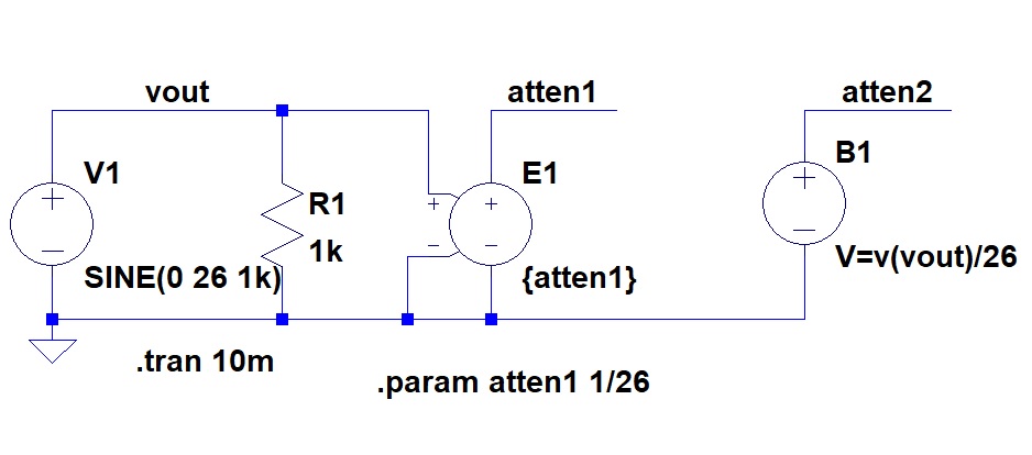

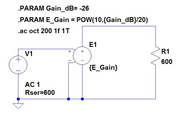

Okay, so I tried the voltage dependent voltage source method. You need a bit of math if you want to set the gain in decibels.
This appears to work for a general gain block, just change the Gain_dB param to whatever you want the gain in decibels to be, making it negative for attenuation.

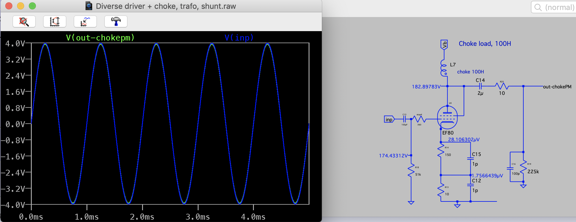

I am strugling with using the tetrode model.
Having connected an EF80 as triode (G2 to A), the grid outputs DC and the cathode nothing; input is also on output.
The model I found is the EF80 as tetrode, has only 4 pins ".SUBCKT EF80 1 2 3 4 ; P G K G2". But it does not work.
I used this EF80 model: and when I saw it did not work I just tested reversing pins and connection, that did,nt help.
thanks for some help! albert

yes did append to me as well many times, just find some other EF80 spice model until you find the one matching the tetrode model of Ltspice.....all the best
try this one:
.SUBCKT EF80 1 2 3 4 ; A G2 G1 C;
* ExtractModel V .997
* Model created: 07-Dec-13
X1 1 2 3 4 PenthodeDE MU= 54.7 EX=1.202 kG1= 136.4 KP= 340.3 kVB = 4670.0 kG2= 584.2
+ Ookg1mOokG2=.56E-02 Aokg1=.23E-05 alkg1palskg2=.56E-02 be= .054 als= 3.09 RGI=2000
+ CCG1=7.5P CCG2=5.4P CPG1 = 0.007p CG1G2 = 2.6p CCP=0.012P ;
.ENDS

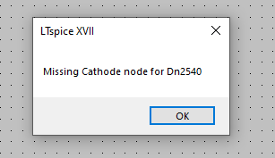

I want to use the Microchip model for the DN2540, which is an NMOS part. How do I bind that model to the LTspice NMOS symbol? Probably a no-brainer but don't know how to do it ...
Jan
*DN2540 MODEL
.MODEL DN2540 NMOS (LEVEL=3 RS=1.05 NSUB=5.0E14
+DELTA=0.1 KAPPA=0.20 TPG=1 CGDO=3.1716E-10
+RD=11 VTO=-1.50 VMAX=1.0E7 ETA=0.0223089
+NFS=6.6E10 TOX=725E-10 LD=1.698E-9 UO=862.425
+XJ=6.4666E-7 THETA=1.0E-5 CGSO=2.50E-9 L=4.0E-6
+W=59E-3)
.ENDS

Hi Jan,
You could put this model as is in a spice directive directly in the schematic, then use it up by renaming the generic symbol to that model's name.
Works for diodes, bjts and whatever, so should work the same for those mos type of devices.
