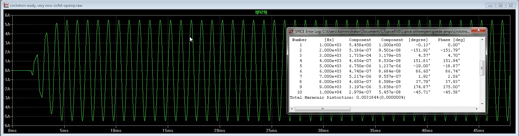

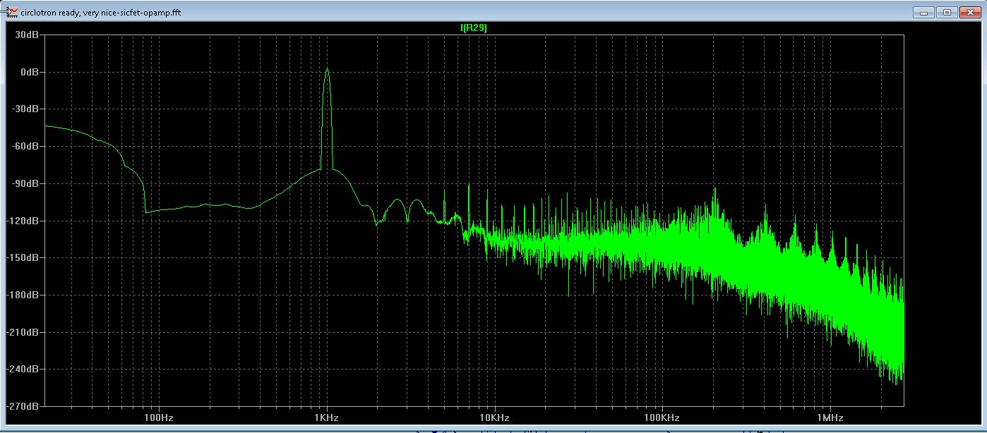

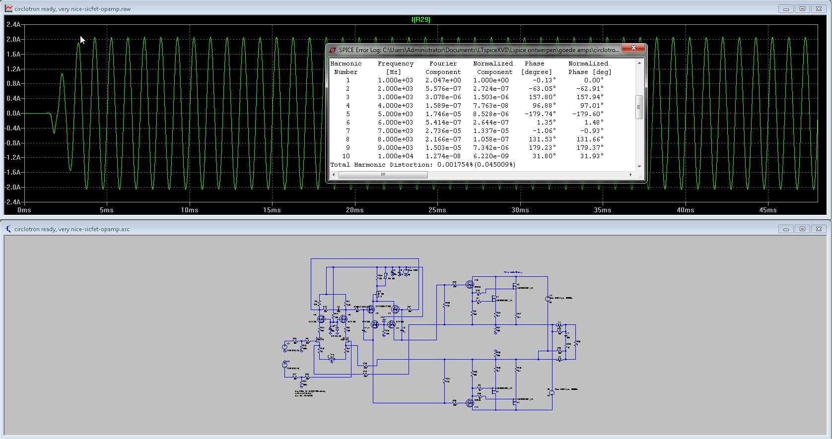

results from a allfet circlotron see pictures, not bad.

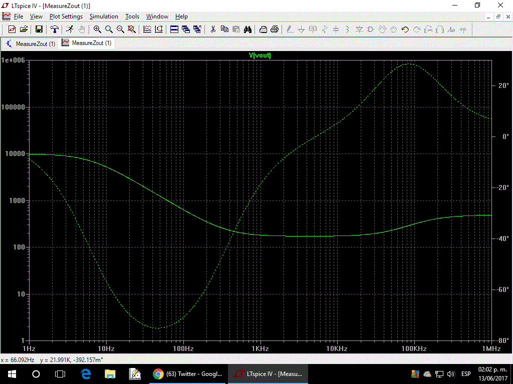

Hi, I was trying to determinate the output impedance of a circuit, following the instructions here: 15/ Measuring amplifier output impedance. Post #214
the circuit is this, (attachment), from an idea of fellow member Ketje
sure I'm missing some crucial detail, because I'nt getting nothing resembling an impedance plot
I'm trying to know if this circuit is usable with a certain "difficult" SS amplifier input stage
Hope someone can point me the right direction

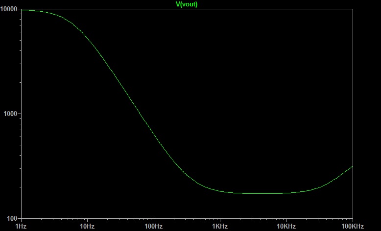

I've taken your schematic and done the following:
1. added I1 across the output, set to AC=1
2. zeroed out the AC component of the input source
If you run an AC simulation, and look at Vout (on a non-dB basis), the resultant voltage numbers correspond to the output impedance.

It looks like it can hit the desired target: "The input resistance is ~10K, but the source impedance is preferably kept below 1K, because of the base current modulation caused by the bias servo."
Anyway, the instructions posted where right, I forgot to zeroing the signal source. Great instructable.
Thank You very much
J.
